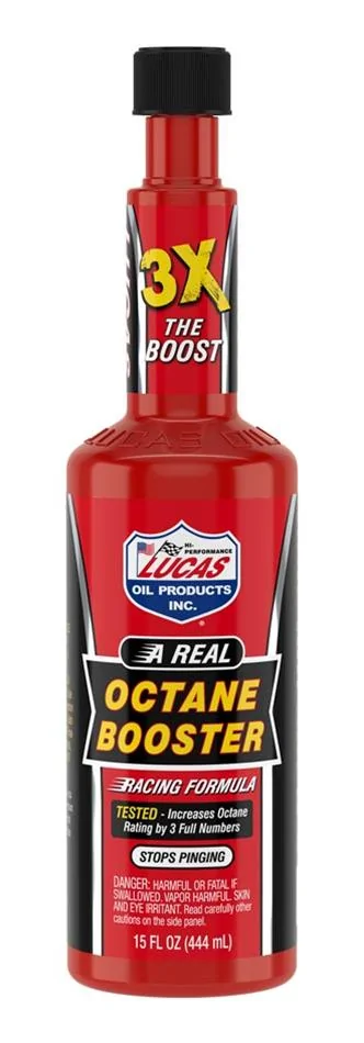

Ya don't have to bring a trailer full of 93. Just sayin' LOL
Ford Bronco Looking for 2.3 owners input booster
