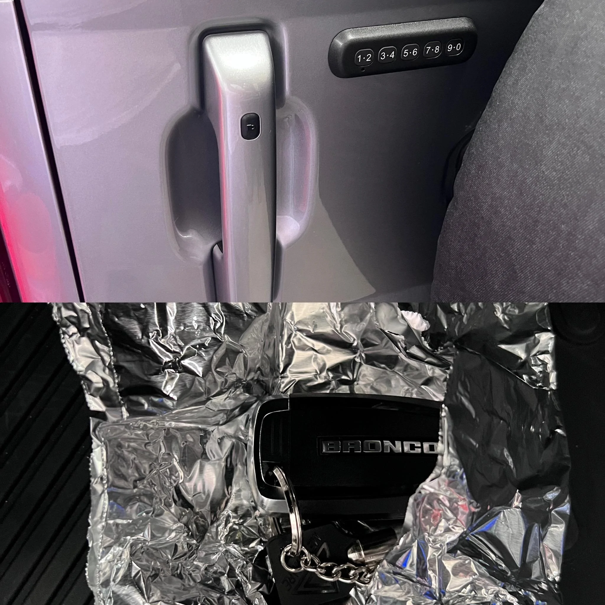

I put a keypad on the back and wrap the keyfob in aluminum foil and lock in the Bronco. The reason I do this is I scuba dive so my phone is in the rig. I put the keypad on the back door (some put in the gas fill cavity. You have to program the pad with FDRS for this system (used to do it like an extra FOB) it took me longer to hook up the laptop and access FDRS. Programming took under 2 minutes.
