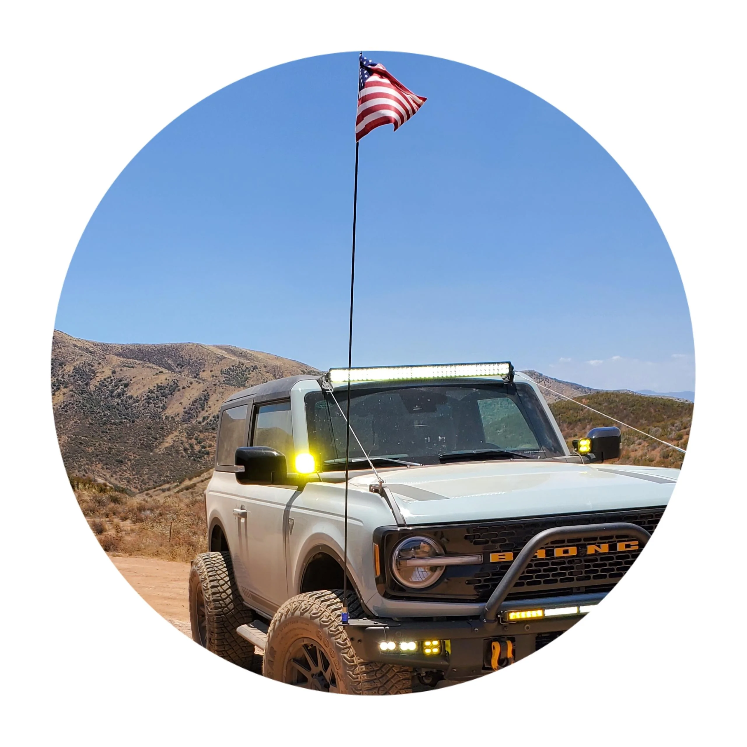

I've pretty much been done with most of the mods that I wanted to do, and decided it was time to share my latest addition.
Living in SoCal, not sure how much need I'll have for them but it just looked too cool and I really wanted them.
So I present to you:
Ford Bronco Limb Risers Install PhotoGrid_Plus_1655432201616
Ford Bronco Limb Risers Install PhotoGrid_Plus_1655432100796
Ford Bronco Limb Risers Install PhotoGrid_Plus_1655432015911
Ford Bronco Limb Risers Install PhotoGrid_Plus_1655432301429
The limb riser kit came from Gearshade.
The main feature of this kit is the quick release pin on the front.
Due to the LED light bar on the roof, I was not able to use the supplied roof mounts, so I drilled 1/4" holes to the front side of my light bar mounts.
I also had the Trailrax trail sight accessory mounts on the front, but after consideration, thought that the quick release was a better option.
My last upgrade is the Trailmax TRMR roof rack, which will open up a whole new world of upgrades, at which point I'll post more updates then!

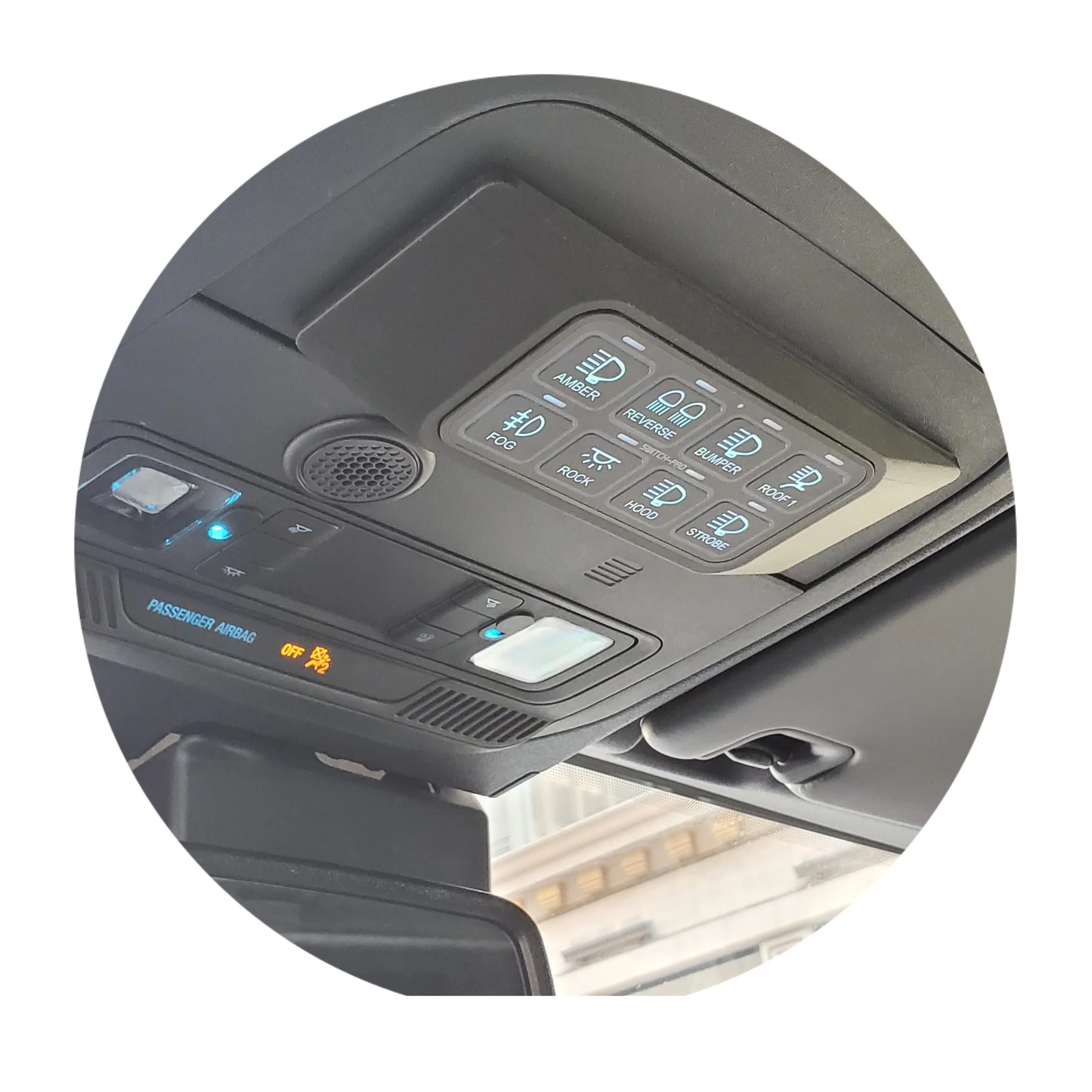

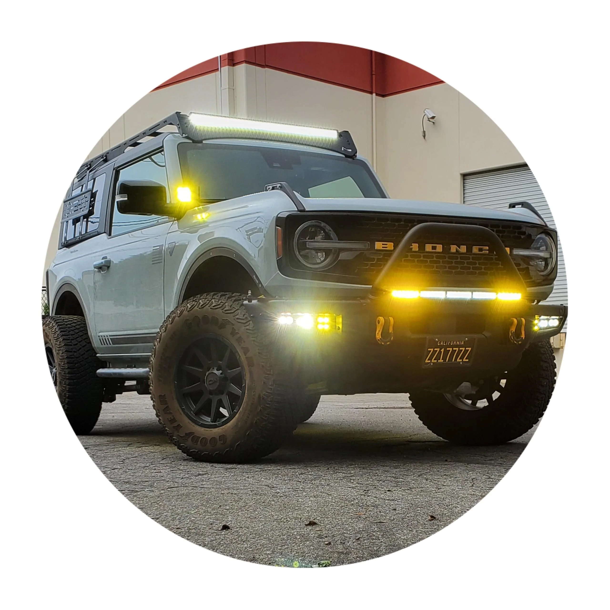

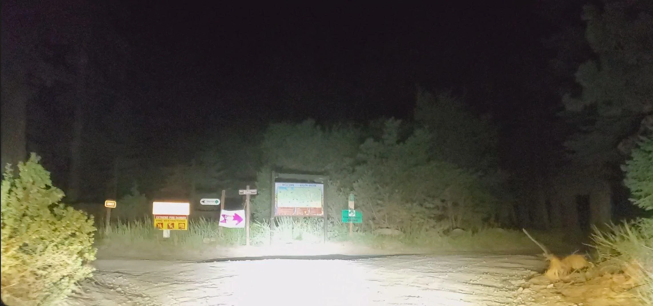

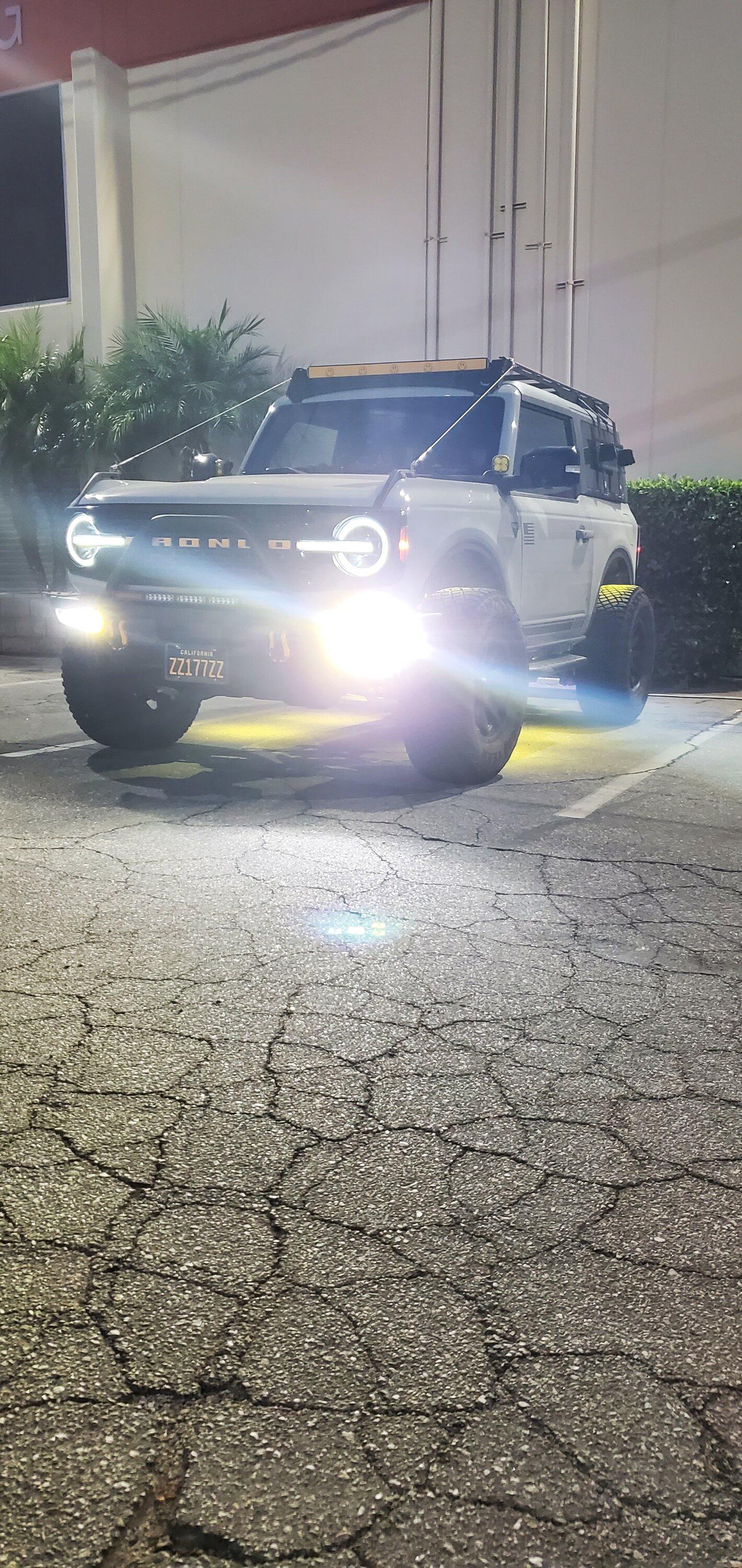

For the lighting, I have two light bars, a 40" on the roof and a 30" on the bumper with this mount.
I also have 6 fog lights, 2 ditch lights, chase lights, and rock lights.
Ford Bronco Limb Risers Install PhotoGrid_Plus_1663172619401
Due to this, the factory AUX switches and wiring did not supply enough power so I ended up taking that out and getting a SwitchPros with a SDHQ mount.
Ford Bronco Limb Risers Install PhotoGrid_Plus_1654973777025
The lights are a bit overkill but they help so much on night trails.
Headlights/Fogs only:
Ford Bronco Limb Risers Install Headlight only
With the lIght bars on in the exact same spot:
Ford Bronco Limb Risers Install All lights

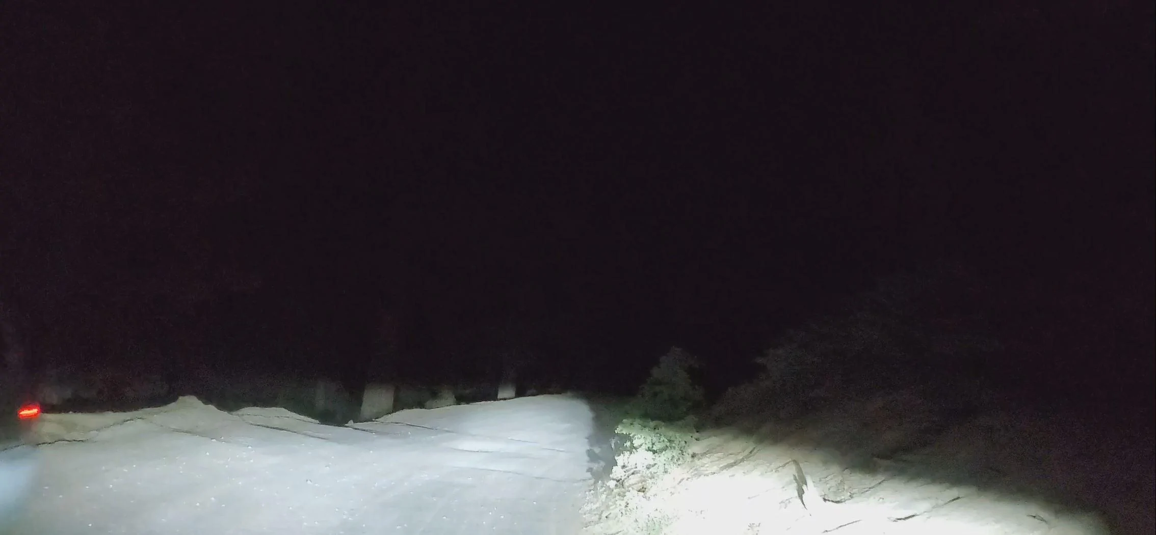

The bumper light bar puts out enough light, but because it's so low, it tends to cast a lot of shadow behind every little bump, so the roof light bar mitigates that problem.
Here is the bumper light only (in a different location):
Ford Bronco Limb Risers Install 30 inch only

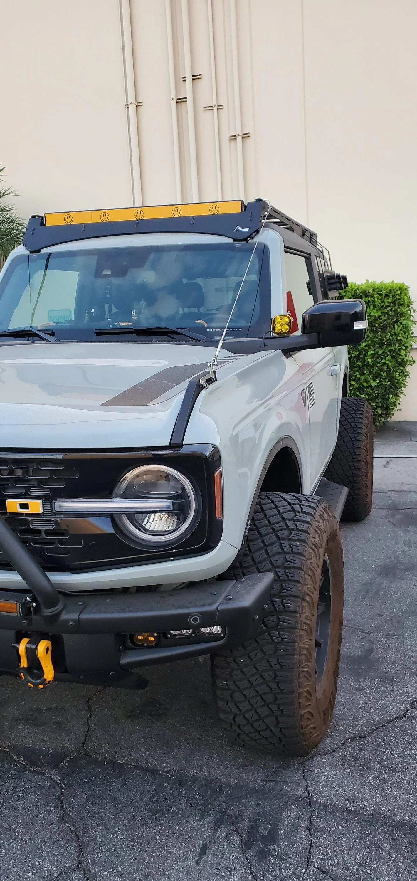

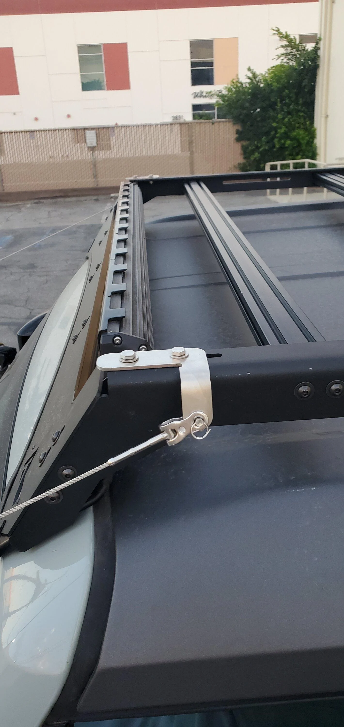

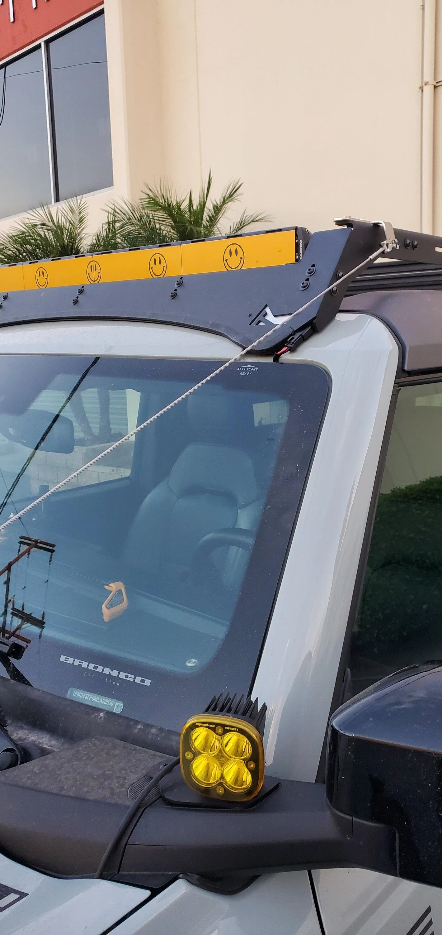

After installing the @TrailRax TRMR rack, I had to come up with a different method of mounting my limb risers to the roof. The mounting point was much higher and further back, and the current length was too short. Spoke to the team at Trailrax and figured out the best place to mount, and also had a talk with @GearShade and they were gracious enough to extend the limb risers to whatever length I needed, which was 5". Extremely grateful for that. This was above and beyond anything I was expecting.
I found the supplied roof mounting brackets from Gearshade and installed them upside down on one of the slats of the roof rack, and it turned out like this:
Ford Bronco Limb Risers Install 20220926_183652
A closeup:
Ford Bronco Limb Risers Install 20220926_183701
Anchor point:
Ford Bronco Limb Risers Install 20220926_183707
The mount:

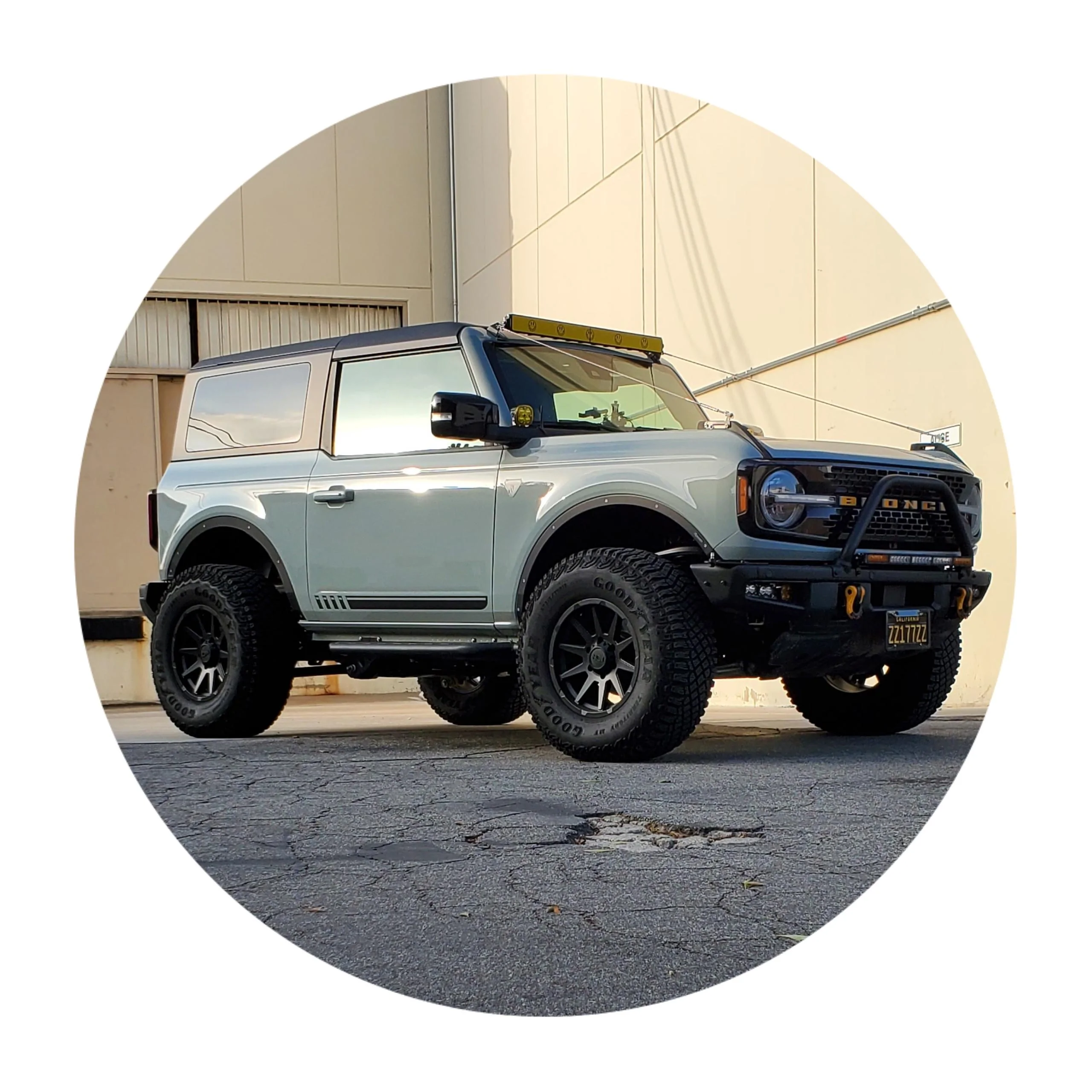

And finally, a glam shot:
Ford Bronco Limb Risers Install 20220926_190346
My pics are terrible and the rig is dirty, but overall, I'm extremely pleased with how everything turned out.

Hey Michael,
I actually have the same roof rack. I like your setup. Did you need to do any additional modifications to make this work? I kinda want to copy what you did here. Did you have to make a special order with Gearshade for the additional 5"? What about the mounting bracket to the roof rack, did you have to modify anything?

The team at Gearshade was gracious enough to send me longer cables, so I just sent in the ones that were sent initially back and they sent me the long ones.
The mounts were not modified, I just flipped them upside down to make them work. The most ideal solution would have been to be able to open the hood with the limb risers on, but overall, I'm happy with the setup.

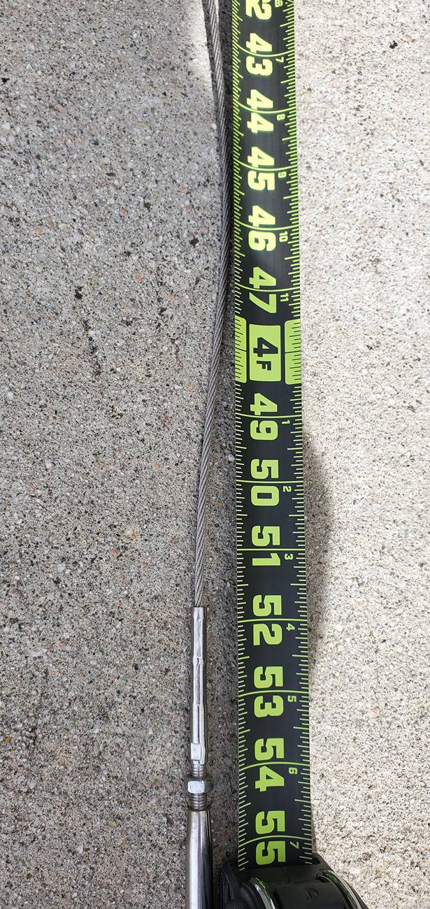

Thanks for the reply. You wouldn't happen to remember what the measurement of the cable was? I will probably order soon.

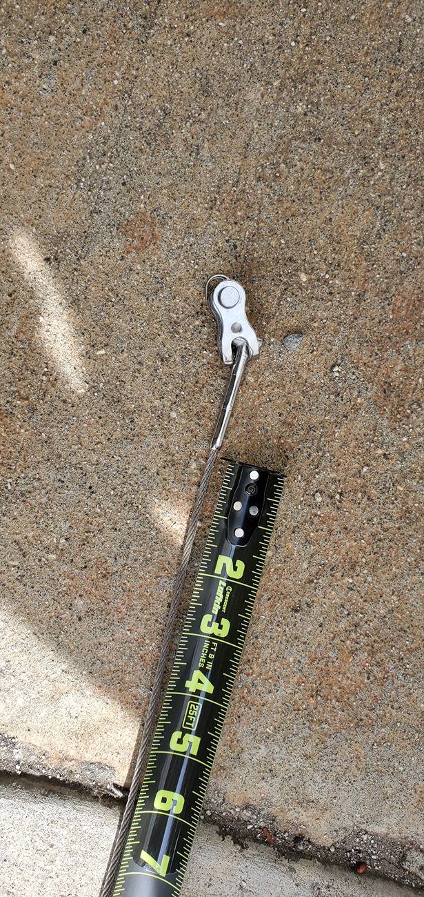

I can't remember, it's been a few years now.
However, my post says it was extended 5" longer, not sure how much that helps. Sorry.
Nvm, I had them in the back so I just measured them.
Heading out to Joshua Tree in a few hours so I found them in the back while checking gear.
Looks like the "inside measurement" of the cable is 52".
The crimps and the locks should all be standard, so that's the measurement you'll need to provide.

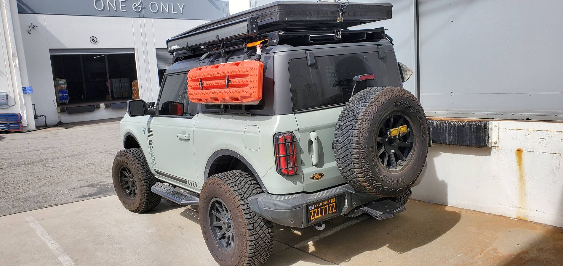

Ford Bronco Limb Risers Install 20250227_112159
Ford Bronco Limb Risers Install 20250227_112154
Here's an updated truck pic, it is now matte and very heavy!
