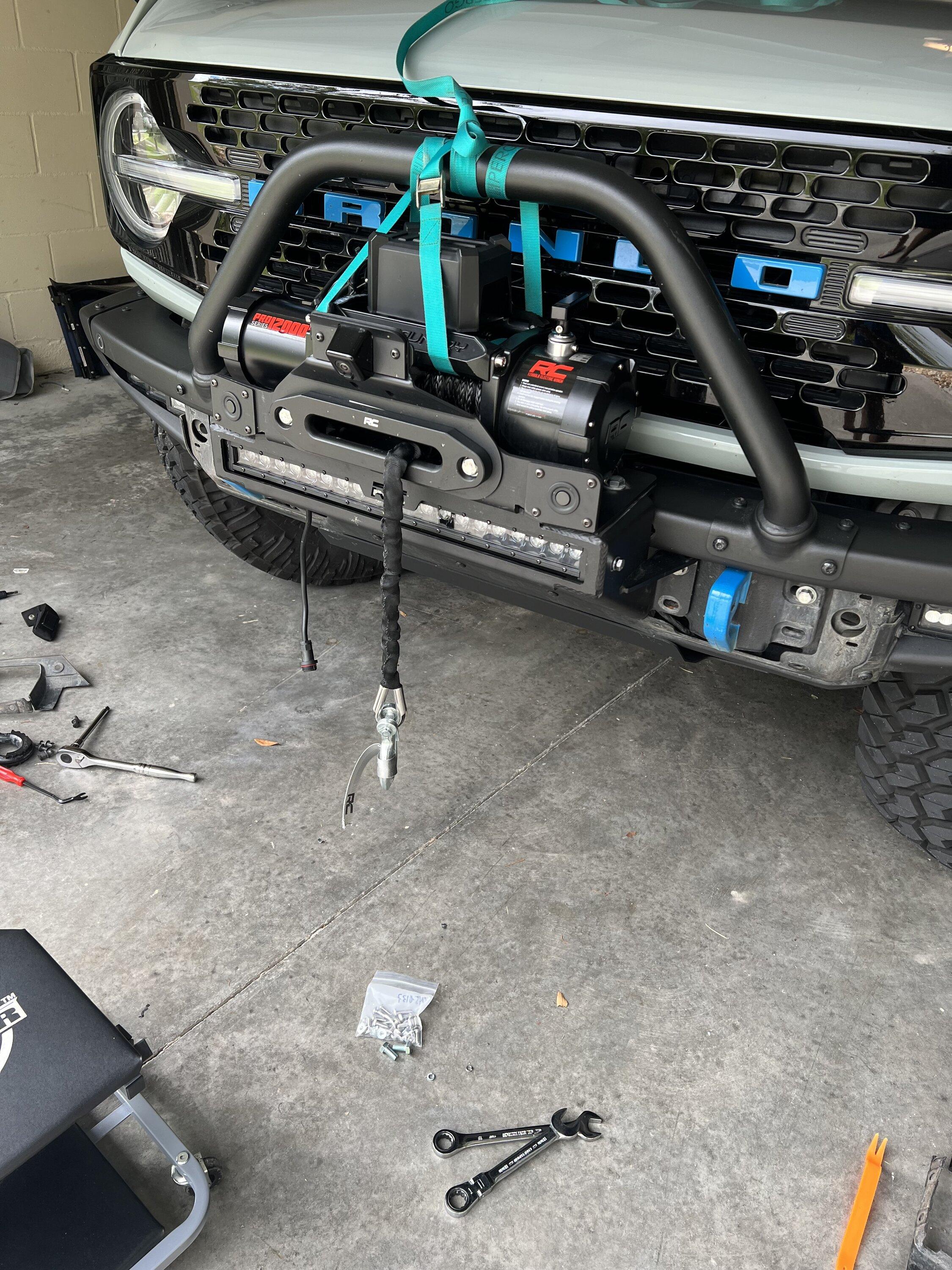

Has anyone tried to install the 20” light bar after installing the Rough Country high winch mount? What is the trick?!?!?!?

You mount it from the rear.
Which means you'll have to take the mount off the Bronco—although you may be able to squeeze it in there with the winch off.

Great! 🤣. Was hoping someone figured out a way to finagle it up in there. Thank you

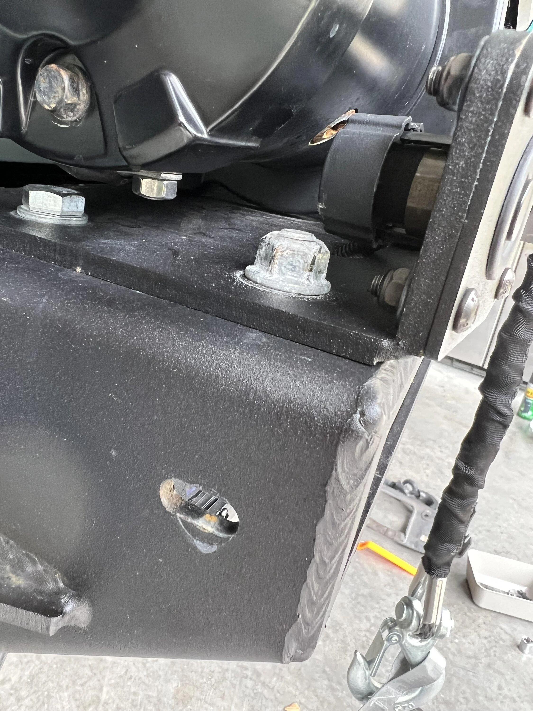

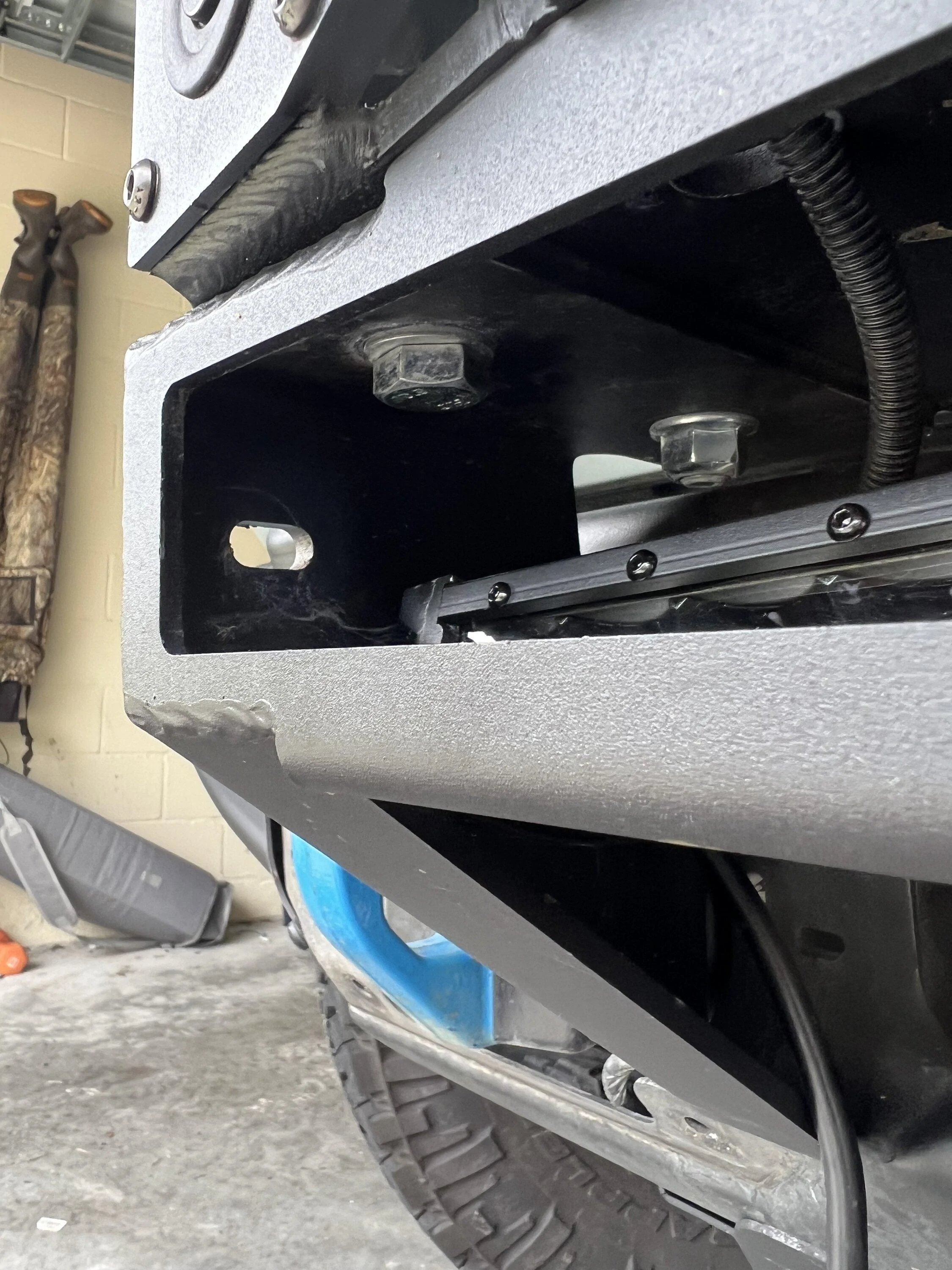

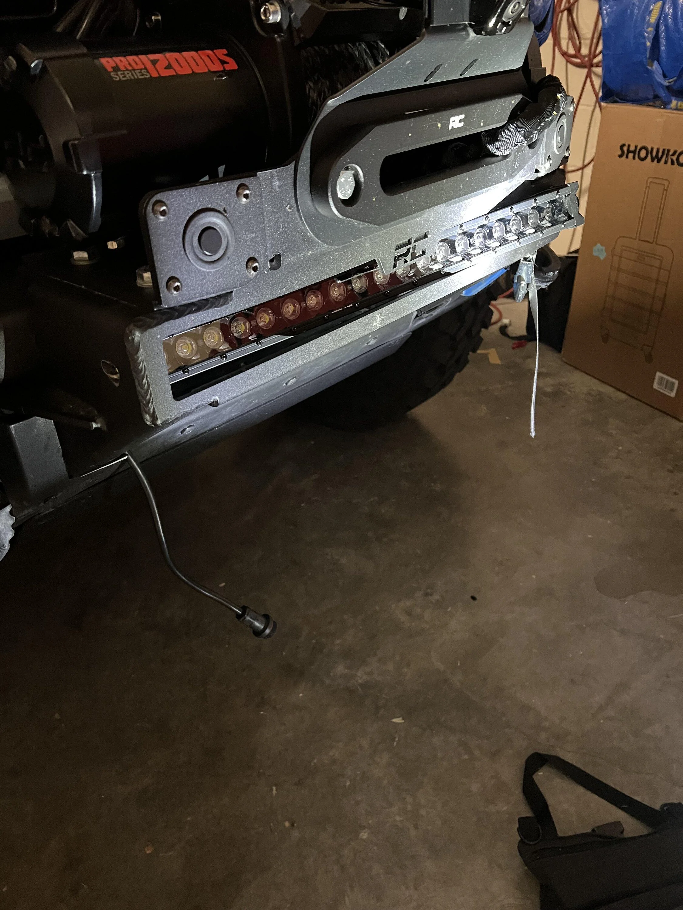

Got it done, not an easy task:
Ford Bronco Light Bar for RC High Winch Mount IMG_1158
Had to remove mount connection bolts and flip 2 of the bolts under the winch around so the light at would fit in the intended location.
