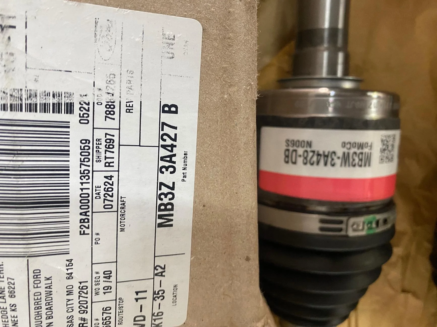

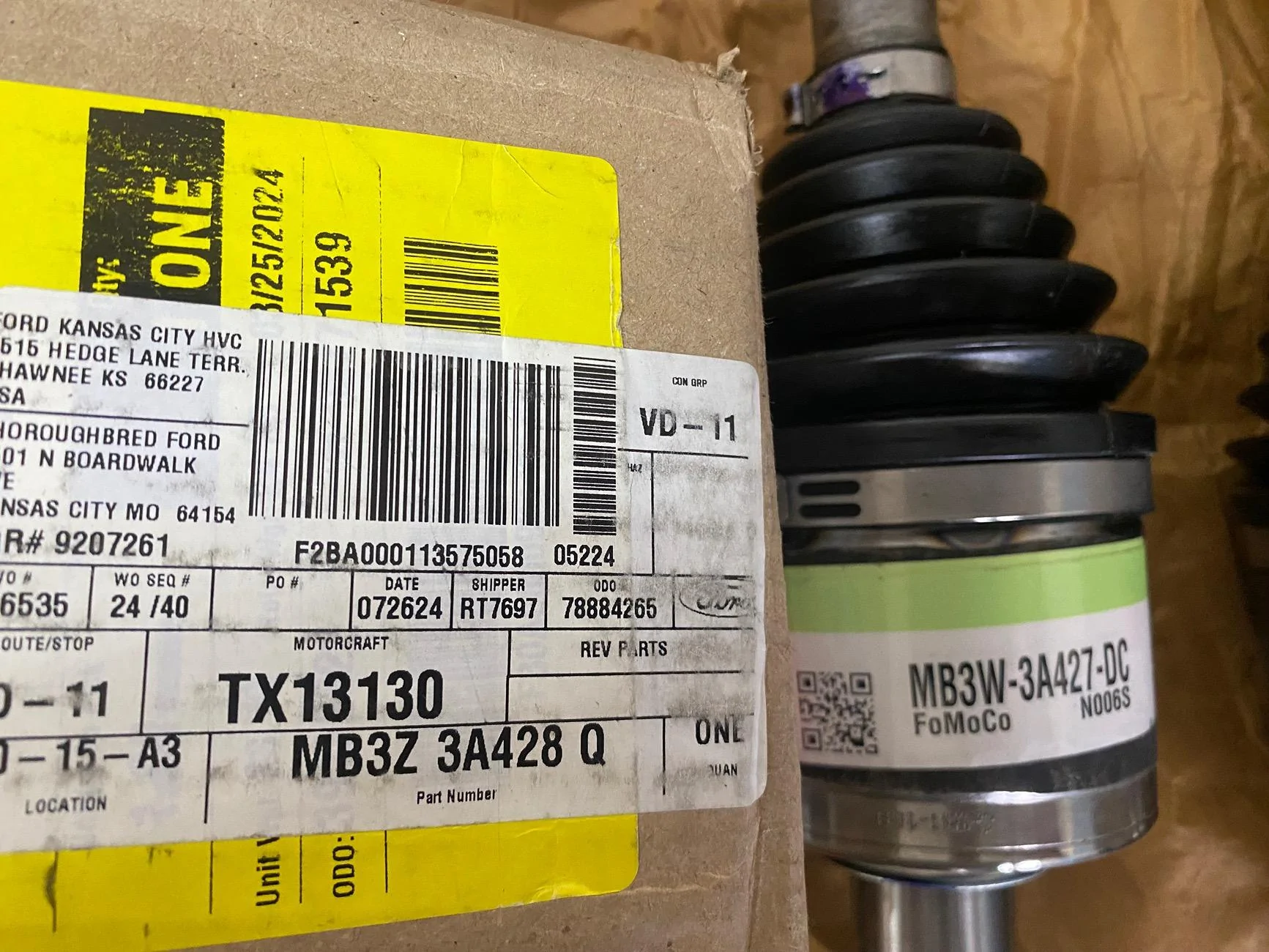

Part AD is the original
The shorter in the same photo is aftermarket
And the two with boxes are also shorter, from Wildtrack and Raptor
Raptor attaches entirely different so it’s a No and IWE… but was worth the attempt.

Adrenaline package is just a code word for sasquatch package.
I'm not sure why they are different or what they changed from older model year axles, but those may work.
MB3Z-3A427-A
MB3Z-3A428-J

The MB3W-3A428-Q is not for a Sasquatch equipped Bronco, it is for an M190 diff passenger side.
The MB3W-3A427-B is not for a Sasquatch equipped Bronco, it is for an M190 diff driver side.
