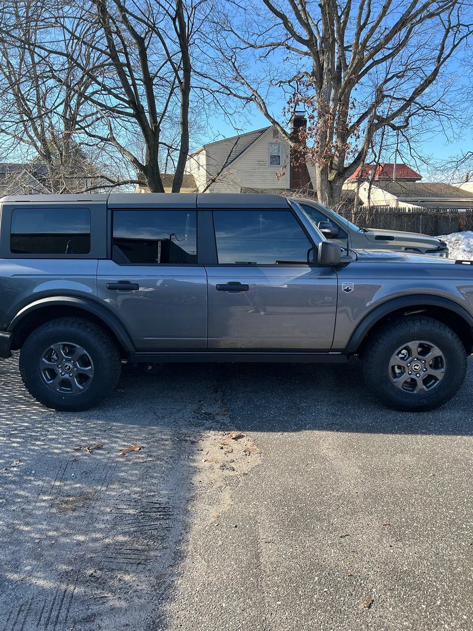

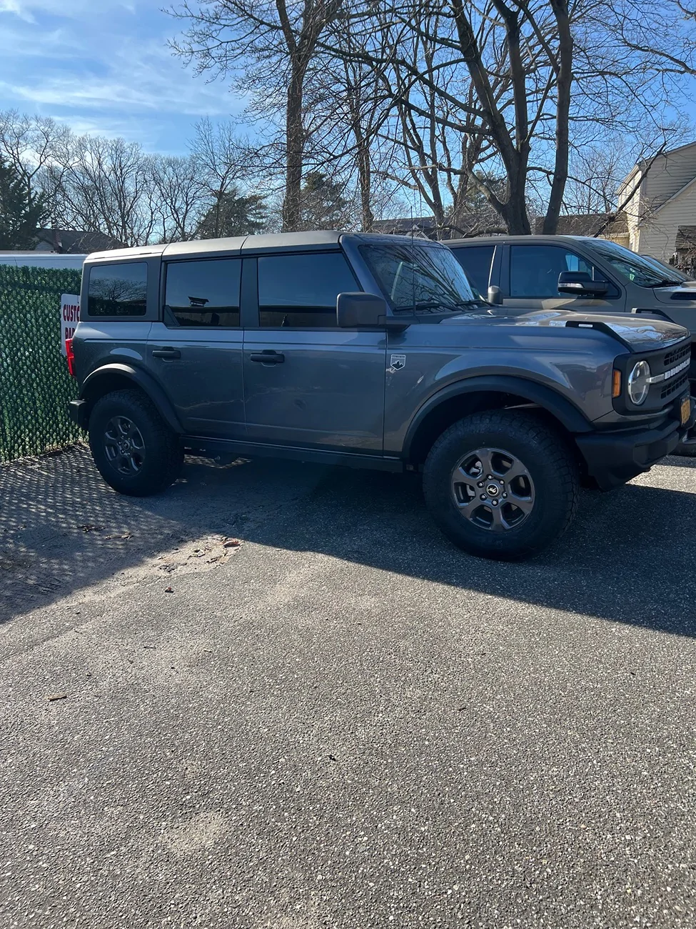

Hello everyone, I am looking to do a leveling kit on my big bend. I decided I want to do a 1.5 inch. I am looking for opinions on brands and some do’s and don’ts thanks!!

Could just be the pics, but yours looks pretty level already. Might end ip with the front higher than the back.
However the zone kit works fine. Any of the 1.5" spacer kits are pretty similar. And you could also just do half the kit for a partial lift if the full 1.5" is too high for the rear. Main downside is extending the overall droop, but really not a problem with the hitachis and if you're not doing much off-roading. But it's a lot of work for not much gain.
I prefer the one inch perch collar lift, but you have to have the yellow bilsteins to use those. I personally would look out for a good deal on take-off bilsteins, and do a 1" Wild Horses perch collar lift before installing.
I'm actually running take-off non-sas bilsteins, with the Wild Horses 1" perch collar, plus the Zone leveling kit. But i also have a diff drop to protect the CV's.

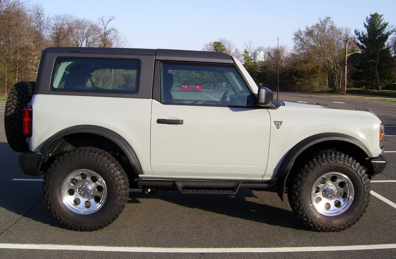

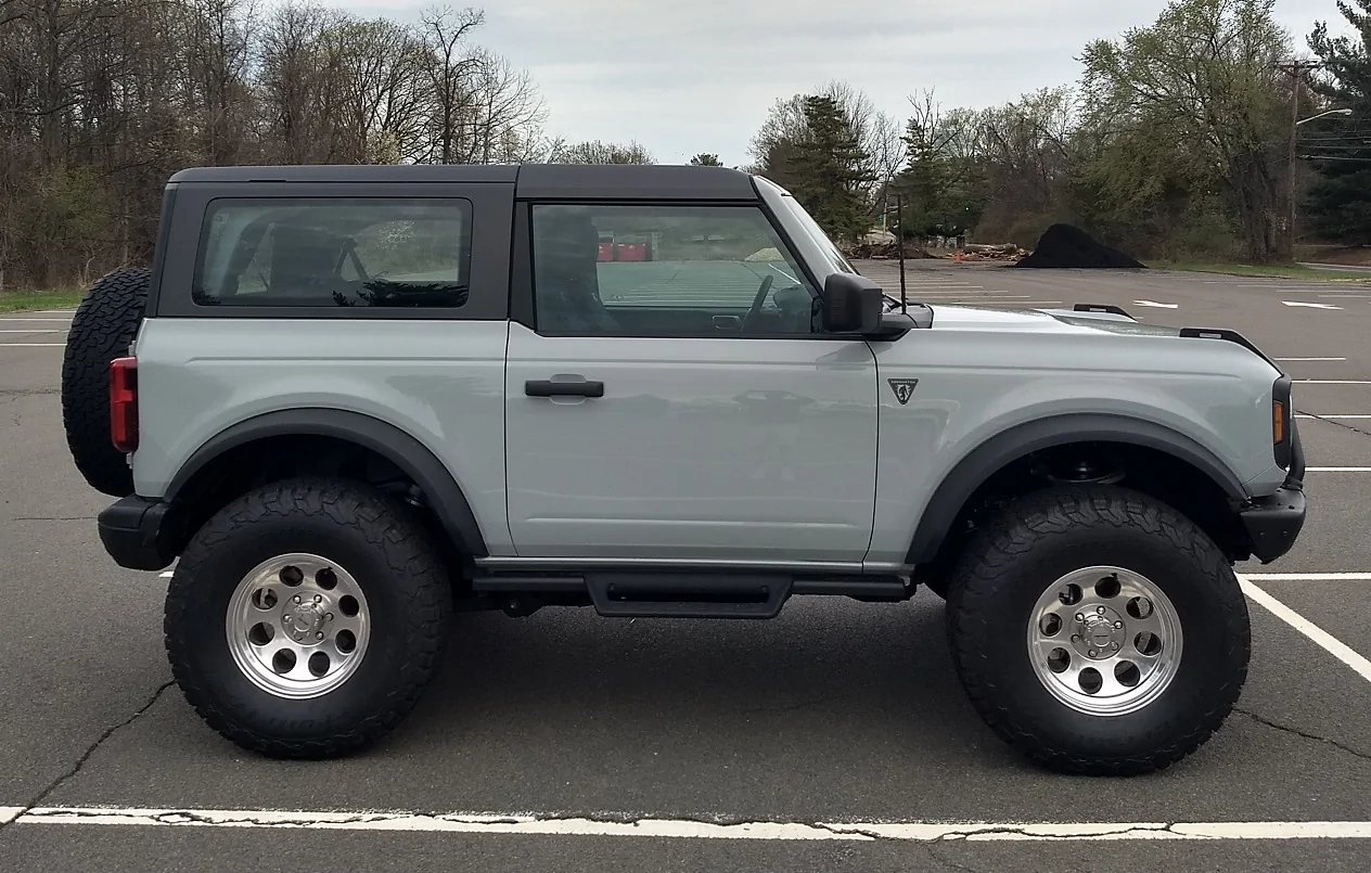

My guess is the 1.5" level will be too much in the front. If it's a kit with multiple pieces, then you could try a single piece to start and go from there. If it's a kit with a single piece that gives you 1.5", I think that will be too much unless you plan to add a little to the rear after that. My truck had about a 1" rake to it with the stock Sas wheels/tires and initially with the BFG KM3 35's. When I went to 37's, I did the 4WP/ProComp adjustable coilovers and lifted the front 2" and rear about 1" to get closer to level. My front did drop a little after breaking in the new coilovers.

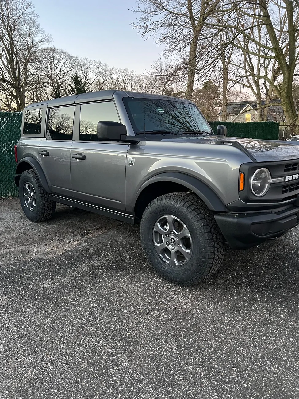

Here are better pics idk if it’s just me but I can see the difference

Yeah straight from the side is noticeable. But probably barely an inch difference. Have you measured it?
