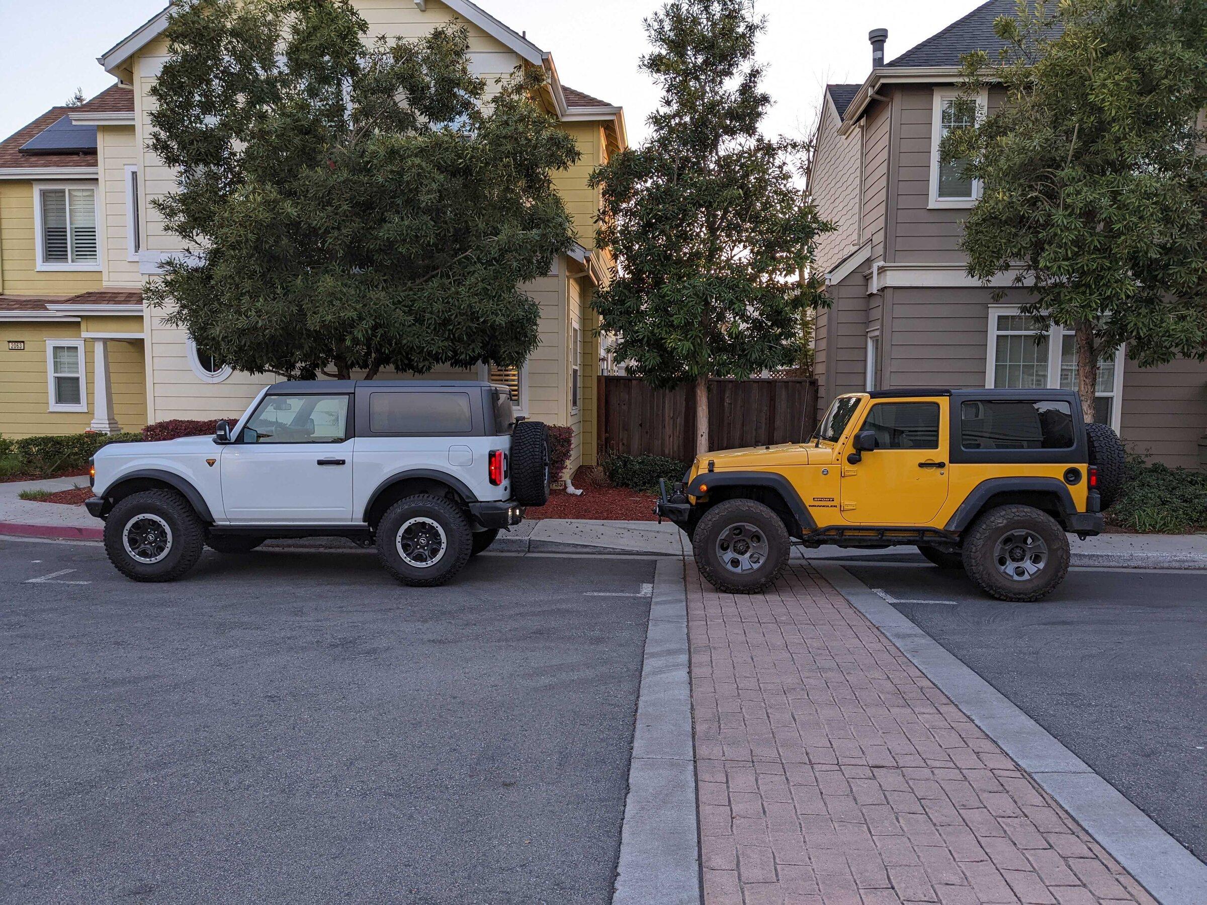

Thanks for all the replies, it sounds like maybe theres an issue on mine. To be clear, I've driven off-road vehicles for decades and still have a heavily modded Jeep JK parked next to the Bronco. The jeep definietly takes longer to brake than my sports cars ever have, for sure, but it never left me scared I was going to smash the person in front of me. I've been leaving way more distance between me and other cars than when I drive the JK, still not feeling secure.
I'll search for the other thread that was mentioned and maybe hit the dealer up.
