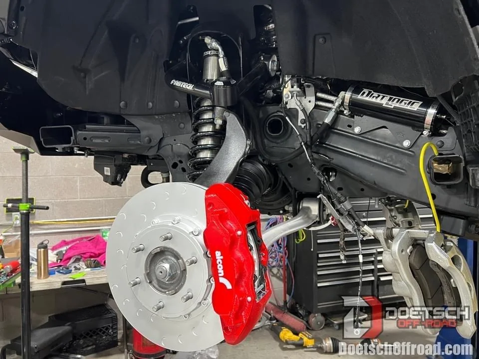

If I remember correctly, @Doetsch Off-Road had a prototype pair on one of their builds and posted about it here.
We havent seen too many concerning issues on Bronco brakes, even on 35s and 37s. Are they great, no. Are they fairly normal for adding significant rotating mass, yes. The Bronco is not a lightweight, and as we add more aftermarket components and bigger wheels/tires we are adding to both the heft of the vehicle as well as that rotational mass. Exploring better pads is not a bad idea for anyone modifying. If its in the cards for you to shell out for a big brake kit...do it. We regularly do Baer and Alcon brake upgrades here at the shop on Jeeps, and yes we did the first r&d kit for Alcon on a bronco as well. That particular bronco gets beat on relentlessly and the brakes never show anything but perfection.

serious brake envy!
