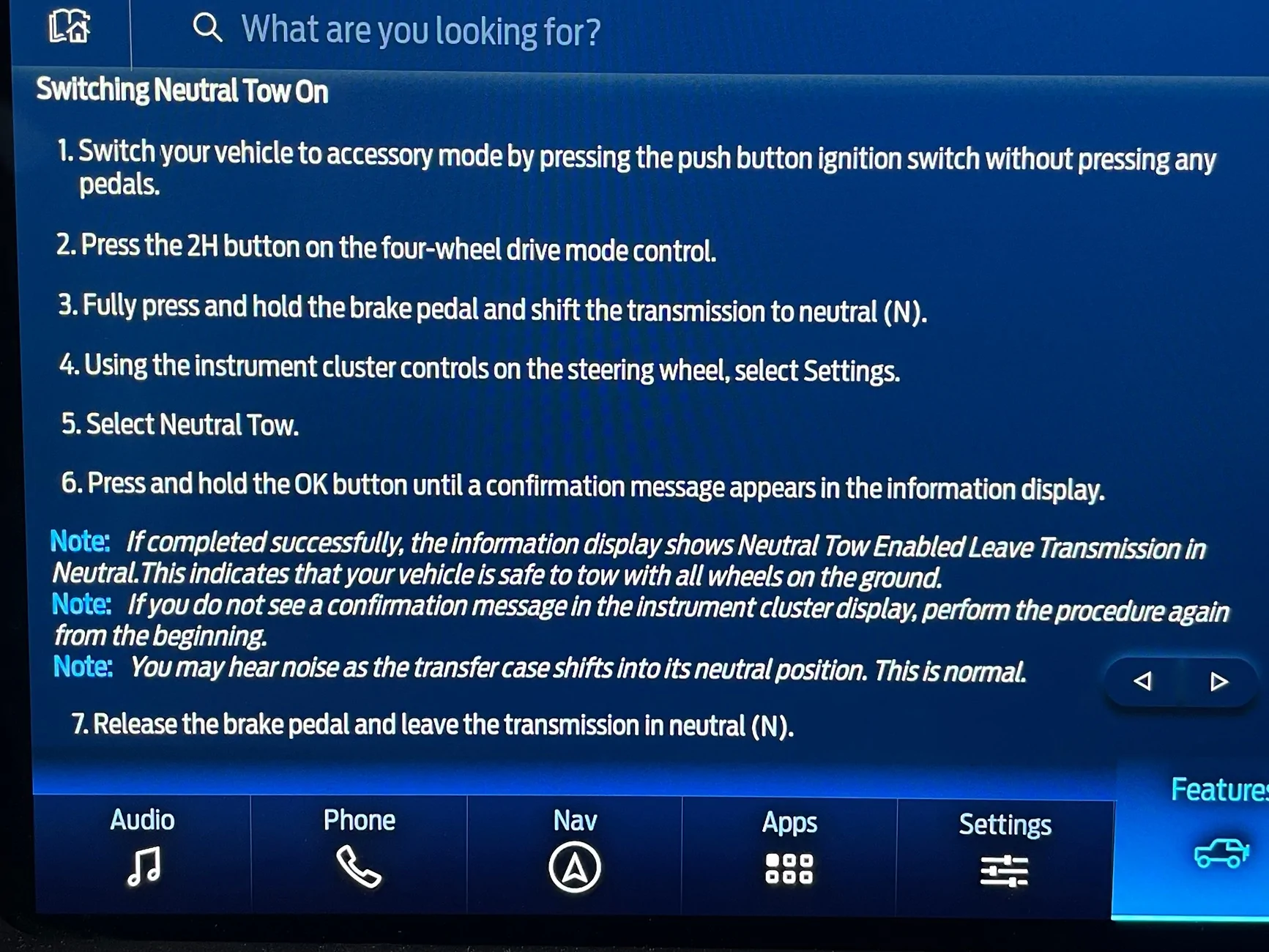

With out starting the engine, just push the start button and put it in accessory mode. Then you can move the gear shift lever.

Step 8 push start button to turn off acct mode.
To Take it out of flat tow mode. You just push the start stop button without stepping on the brake pedal, then step on the brake pedal and put it into Park. It’s that simple.
Ford Bronco Leaving auto transmission in neutral with engine off IMG_4730

Thanks all for the advice. That is a little complicated but will use it if I have no other choice. I found instruction for an F-150 that is a little less complicated. I have not tried it yet but will soon. I will post the results.

I did try the neutral tow and that worked, plus it was not all that complicated. It did kick the brake pedal up on me but I think I turned off the acc mode with my foot on the brake. I didn't push the 2H button but I guess if it is in 2H you don't need to. I will push it anyway the next time.
