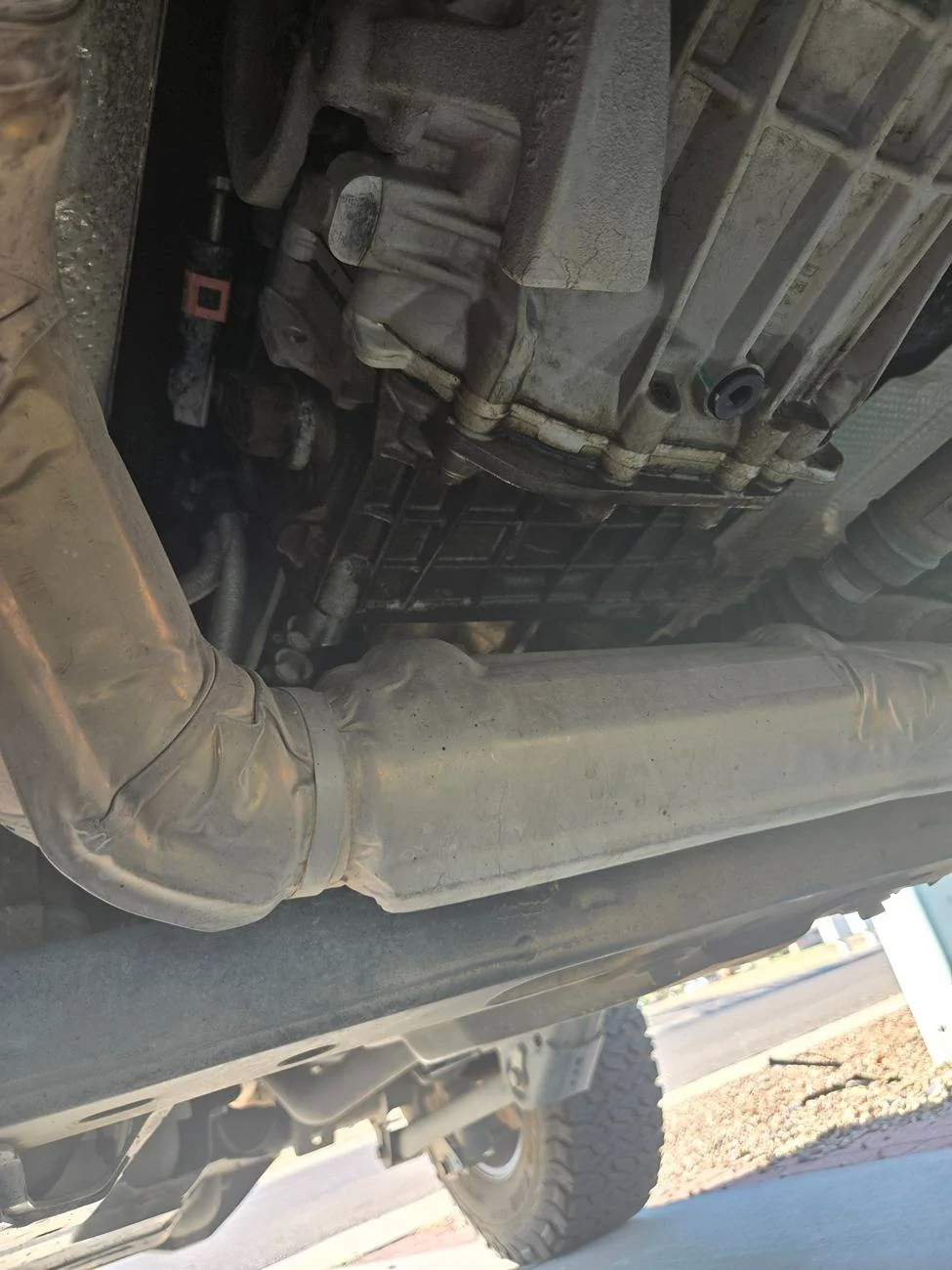

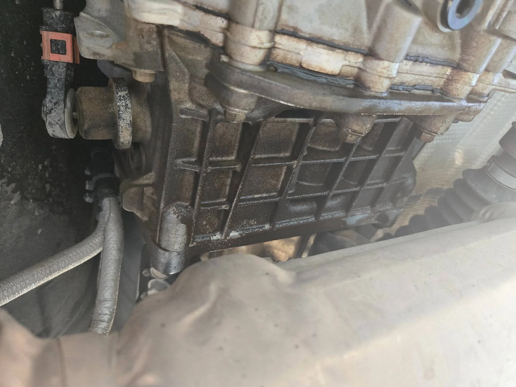

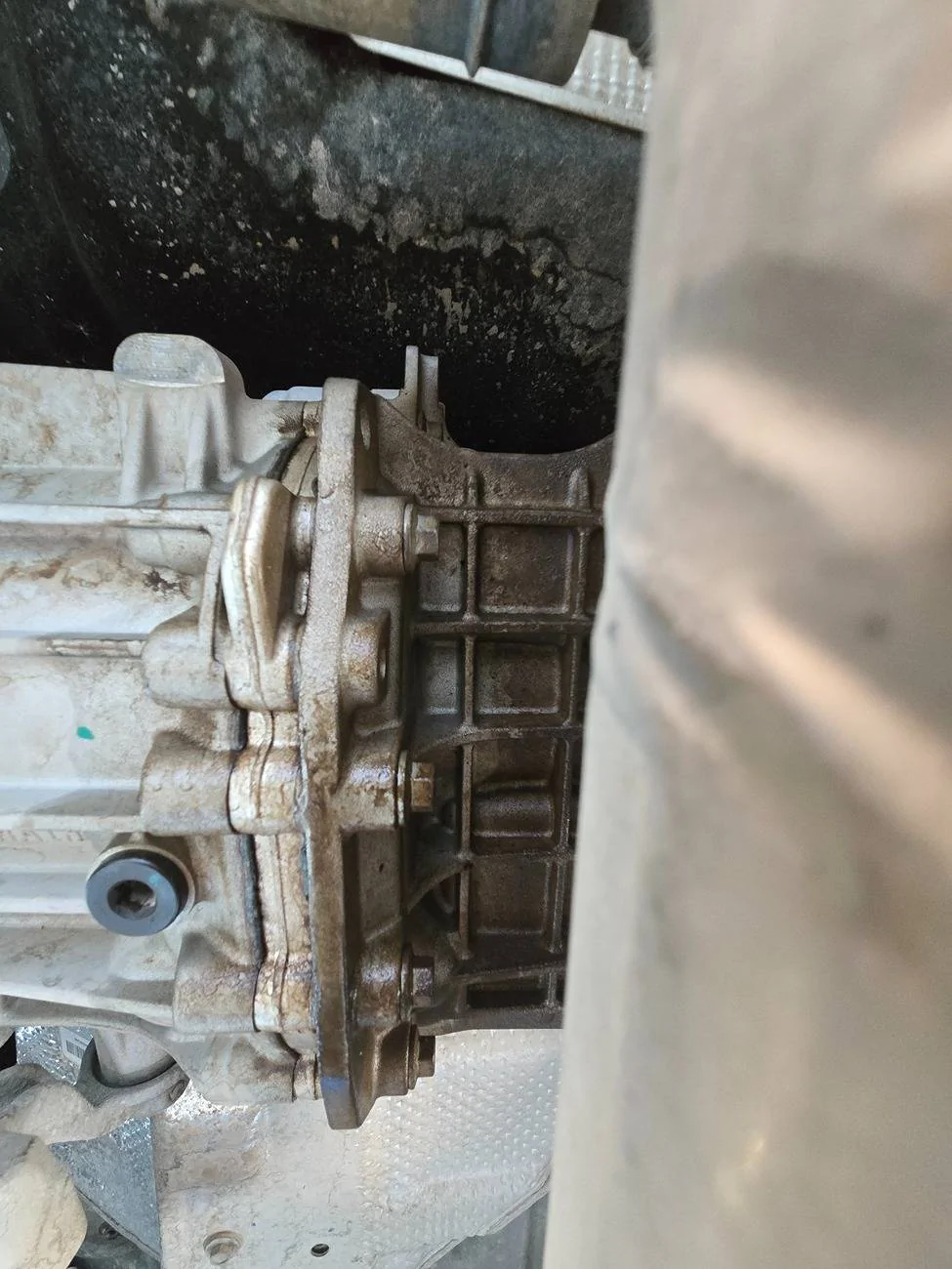

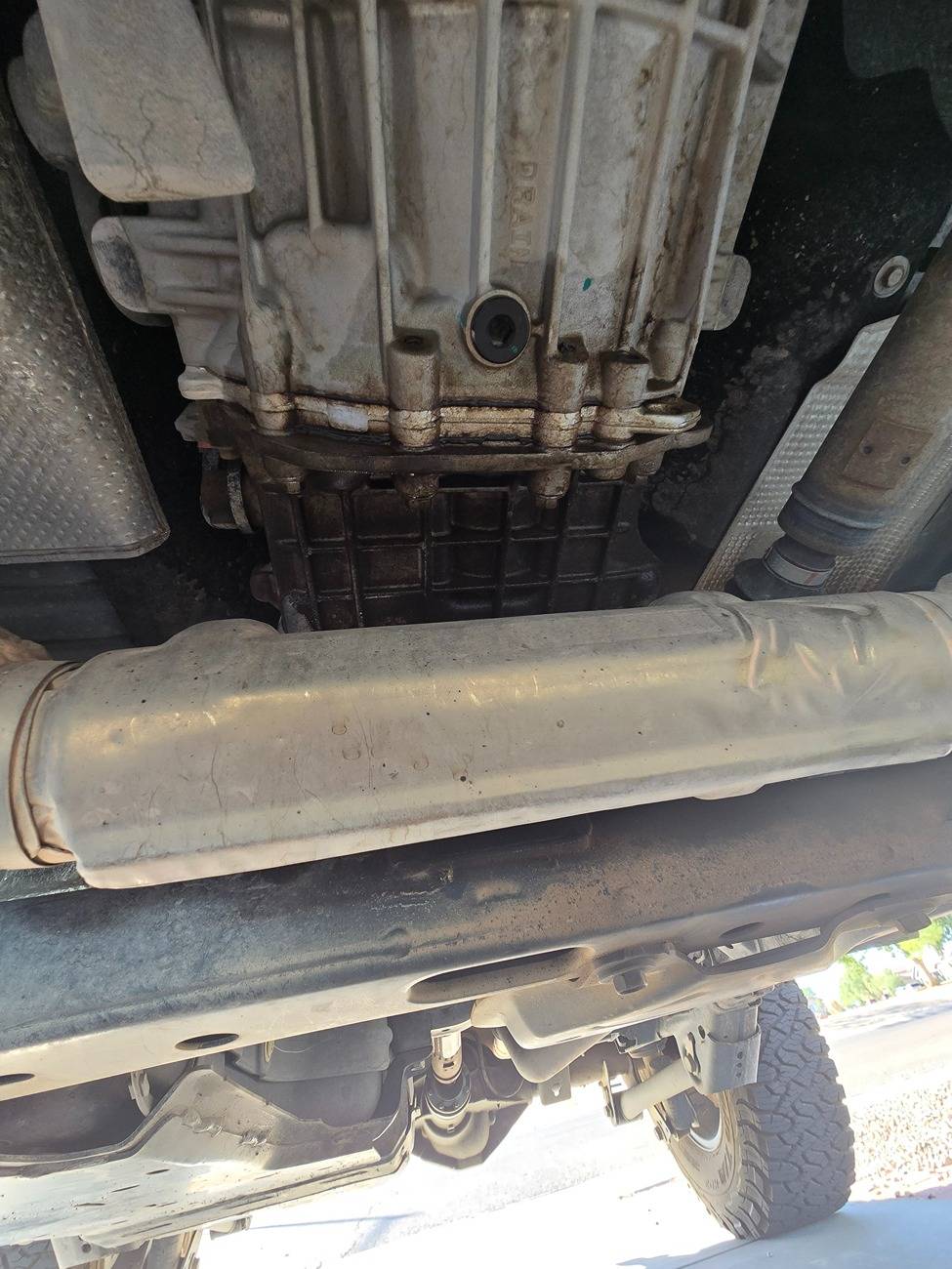

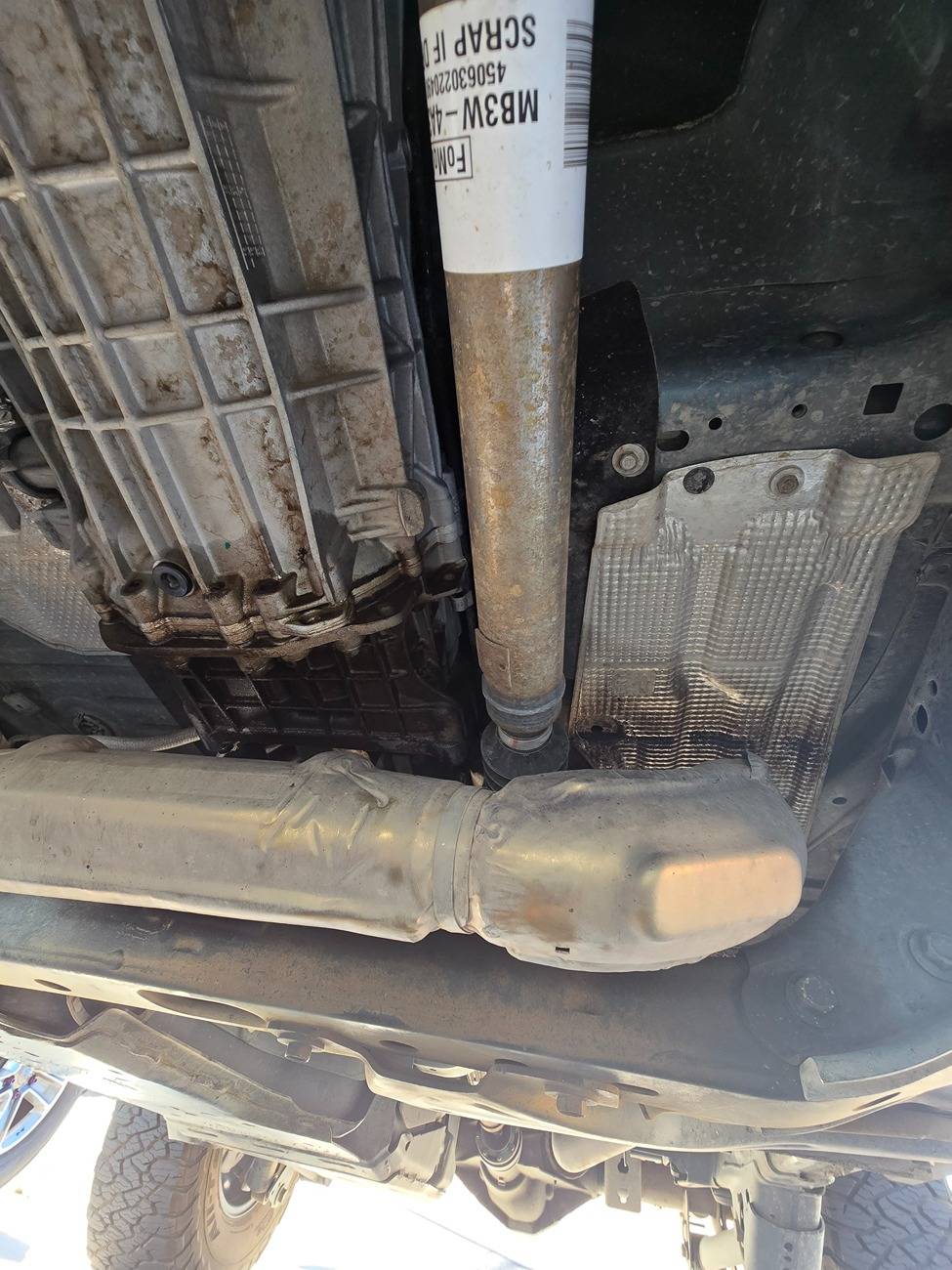

So between the actual gear housing, and the transfer case, where the shift linkage connects more specifically. It was discolored 3k miles ago, like it had a weep. But yesterday during the oil change, it had a couple drips forming. Has anyone had this?

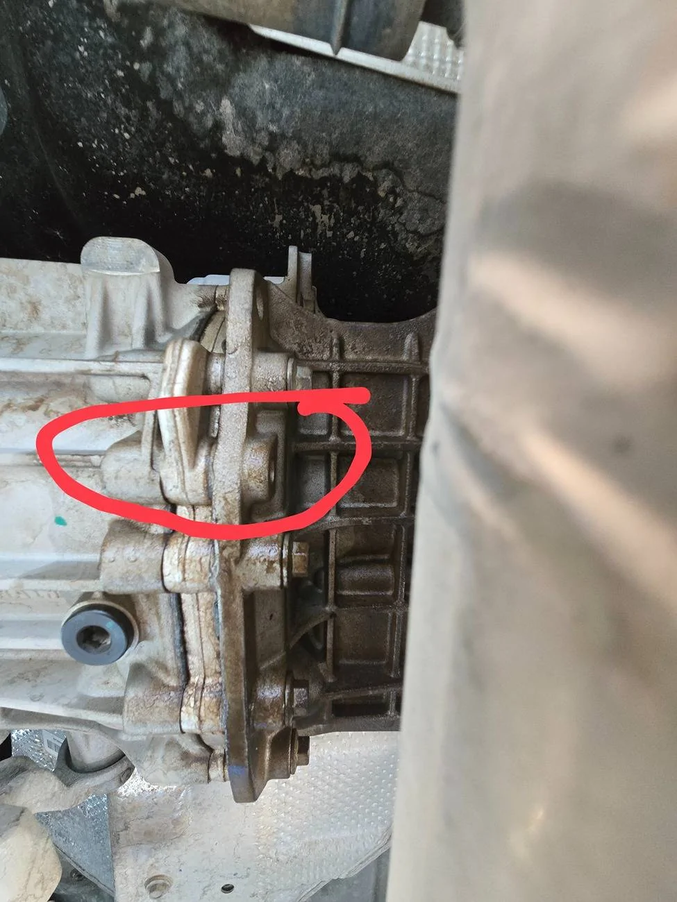

And in the photo with the red circle, is that a dowel pin or did a bolt head break off?

Has the transmission ever been out for repair? Either way, looks like tail section needs to be resealed.
The part you circled is a dowel. No bolt should be there.
Nope, no work of any kind on anything outside of filters, oil & tire changes...
