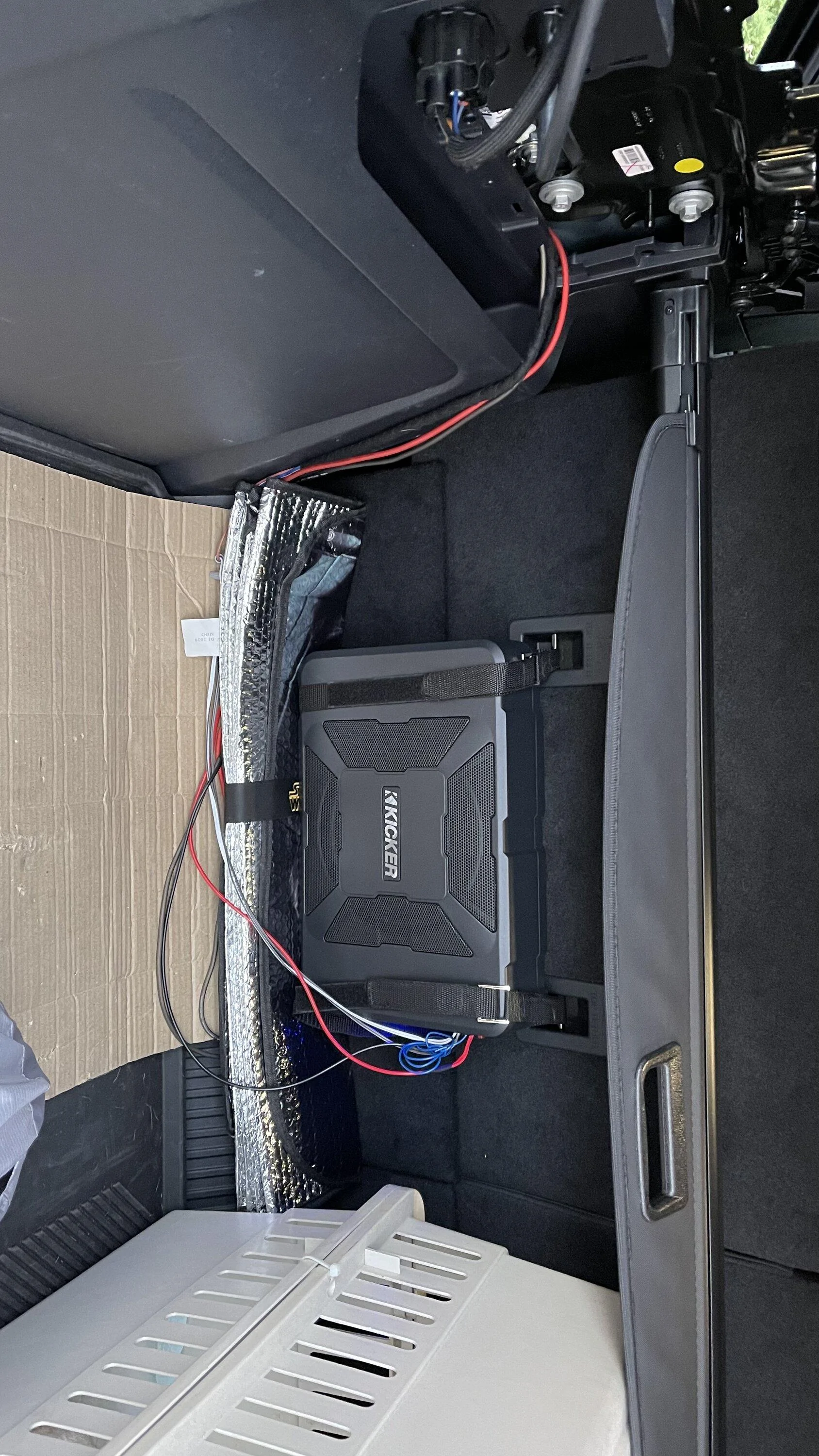

do you mind showing a pic of the 11HS8 mounted?
Ford Bronco Kicker Key Amp 200.4 Install DIY Video - Do this first! 00937A0D-720E-4C16-B16E-AA59085A5EF1
I still need to turn the sub upside down so the quick disconnect will be on the left-hand side and then some cable management, but it stays put once velcroed to the back seat carpet. The tonneau cover seems to help the overall sound and I’m quite happy with the results.

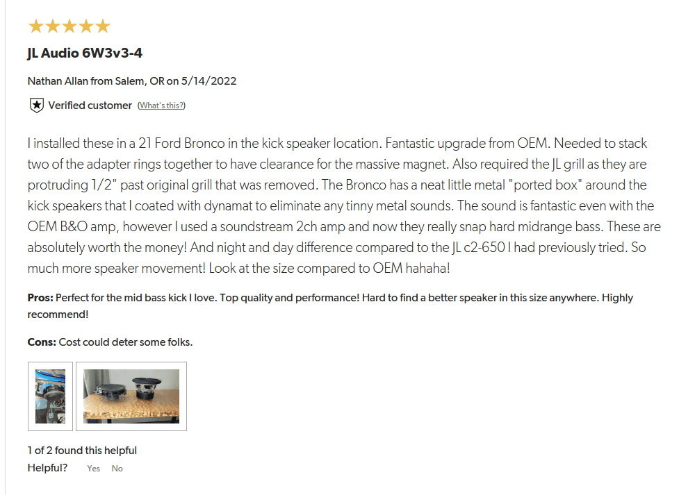

I'm not going to add a sub, so need to get the best bass I can out of the kick panel speakers. Any recommendations? Thank you.
1. Add a sub...there is no other way to get the balance and SPL that comes with a dedicated unit. 6.5s might not cut it, but if I were to forgo the sub, I'd go with...
2. JL 6w3v3s (@$280ea) in the kicker location and you might just have to go with a stronger amp for those. There's a guy who put them in his kicker locations and STILL put 2 HS10s under his front seats (and JLs in the dash).
3. Count on some bass blockers for the dash speakers. I'm using the crossover on the Key for an 80hz cutover and still need to limit the dash speakers. Likely buying 300hz blockers this week.

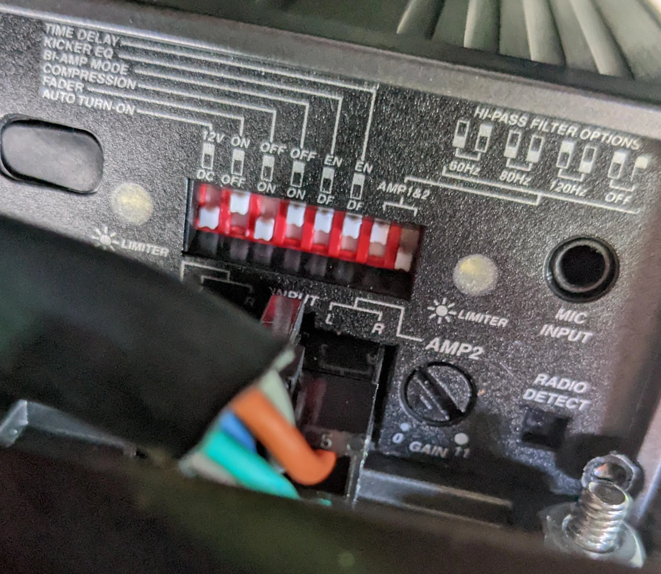

this is how I have mine set up (ignore the last 2 dipswitch settings...I have a kicker sub)
Ford Bronco Kicker Key Amp 200.4 Install DIY Video - Do this first! PXL_20220907_183303238
Chirico
Aug 17, 2020
43
79
NYC
Bicycle
Thank you for the response.
This is exact setup that I have currently.
Do you hear any muddy/ busy sound with DSP on (compared to DSP off)?
Anybody knows if Time Alignment (time correction) from the factory unit? If so, Kicker recommends 'TIME DELAY' switched to DF.
I may try this later tonight just to see if it makes any difference.
