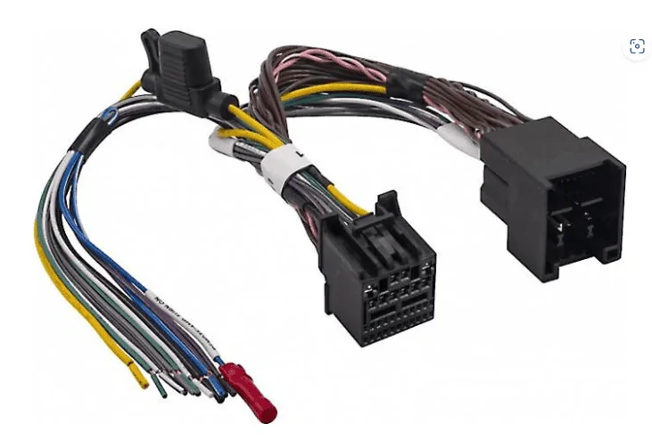

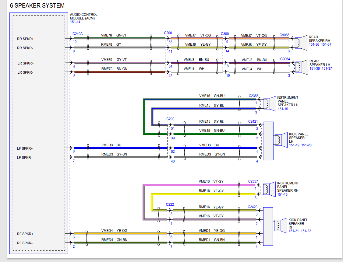

Kick/Dash Wiring
Ford Bronco Kicker Key Amp 200.4 Install DIY Video - Do this first! 1666287175992
The front setup wires the kick panel speakers and the dash speakers in parallel, if you get this adaptor for the kick panel speakers you can split the dash and kick panel speakers and only have to run an additional set of speaker wires to the kick panels by cutting the wires shown in the instructions
Ford Bronco Kicker Key Amp 200.4 Install DIY Video - Do this first! 1666286230544
If you get this T-harness you can connect the Kicker 200.4 in bi-amp mode to the front speaker outputs of the T-harness and then connect the outputs of the amp to the speakers using the existing wiring to drive the kick panel speakers and the additional wires run to the adaptor in the kick panel.
PAC LPHFD31 LocPro Advanced T-Harness T-harness for adding an aftermarket amplifier to a select 2018-up Ford vehicle without a factory amp at Crutchfield

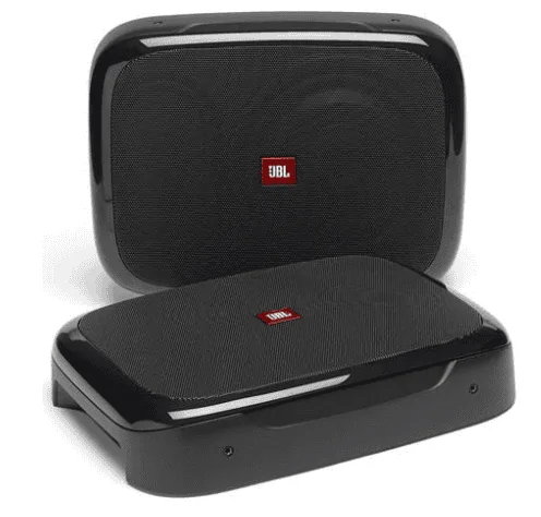

That's what I am doing, I already soldered up the new T-harness and have the speakers. I just haven't got a chance to install it all yet.
I am installing these under the seats:
Amazon.com: JBL Fuse - Passive Dual 8” Subwoofer : Electronics

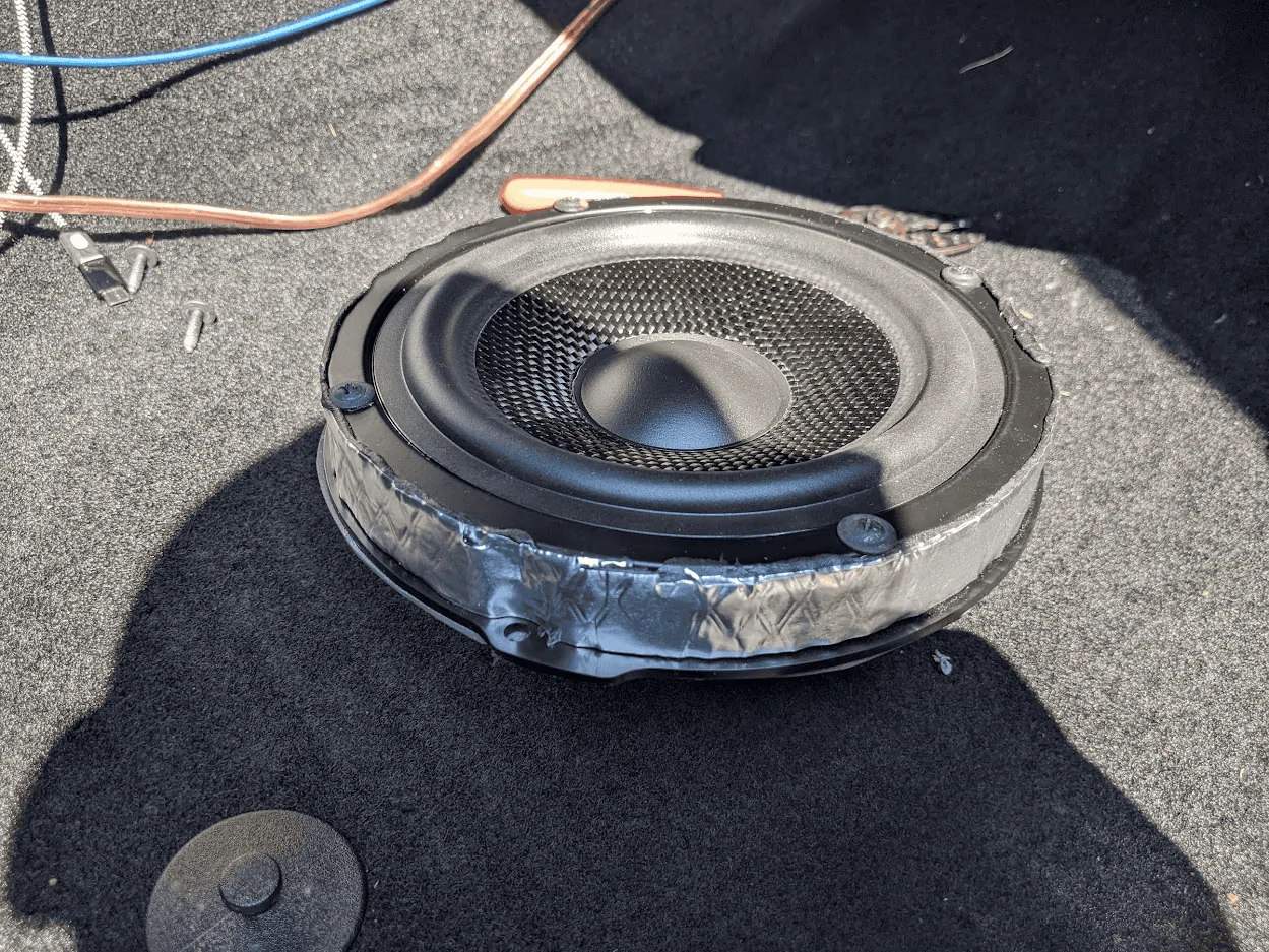

I used sound deadening inside the kick panel cavity so the flat metal back there doesn't vibrate. Vibration means some of the work your speaker is doing is going to vibration rather than output.
I also sealed my speaker to the plastic adapter using strips of the same sound deadening to prevent air from leaking from any gaps between them. It's the same concept - you're trying to separate the front of the woofer from the back of the woofer so it does not reduce the sound output:
