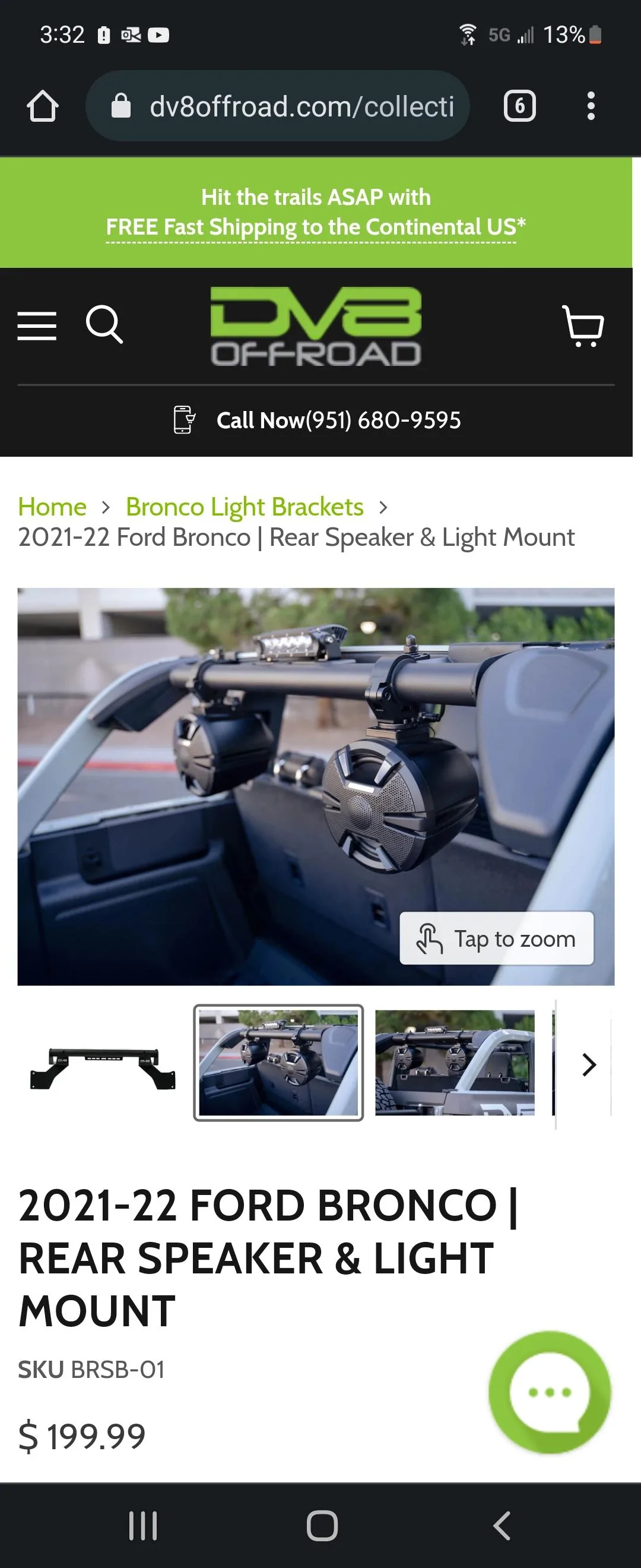

Thank you for the video and info. I will definitely do the Amp and harness. I have replaced all 6 speakers with KickerCS and it already sounds much better. Any help or ideas on how to wire and power 6.5 Alpines that would be connected to the DV8 bar as shown?
Ford Bronco Kicker Key Amp 200.4 Install DIY Video - Do this first! Screenshot_20220628-153224_Chrom
