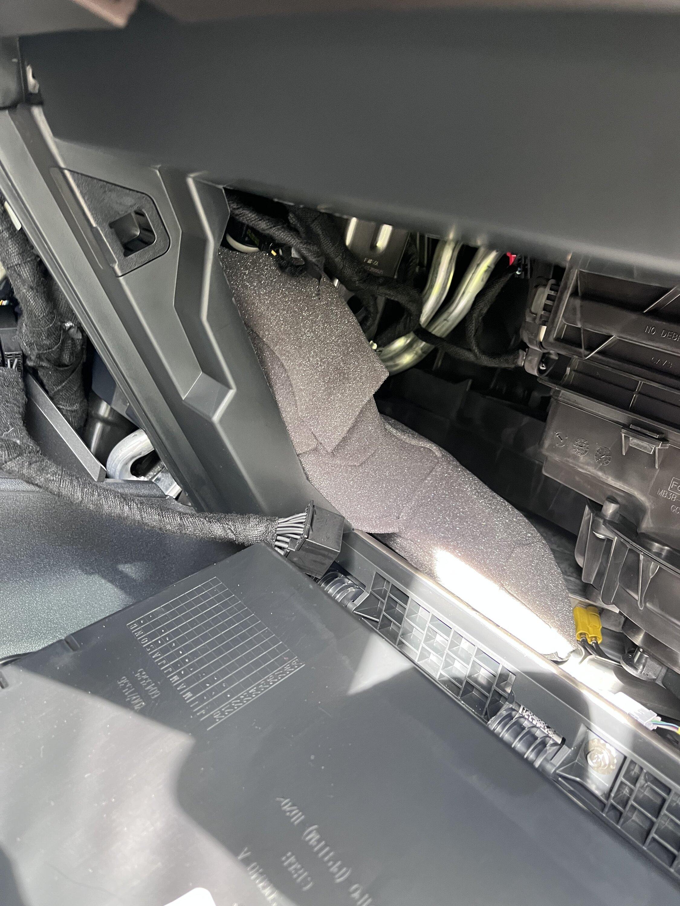

What the heck is this big foam piece between the glove box and head unit ? I am assuming I need to remove it before feeding harness through ?? Unless I missed it , I didn’t see this in any of the install vids I have seen ….
Isn't that the A/C system vent? It's a plastic tube wrapped in foam.

I think you're right, I just didn't expect to see it there... and I went back and looked at original vid, and saw it. That's what I get for trying to rush this, and first thing in the morning before drinking my Bang :)
