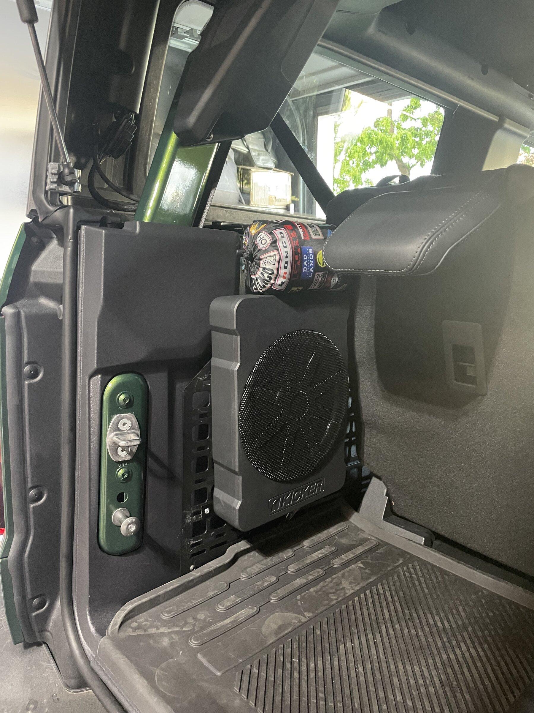

used @BuiltRight Industries to mount the sub today. works good, will rattle if you really push it hard but that was expected. i don't really shake houses or anything so a non-issue for me.
mounting didn't align perfectly with the hs10 holes, and i could only get three mount points because the rear seat position and fuck space, i have a 2d. the molle is great, scratches with metal on metal, but i don't care. the sooner i can wear this beast in the better i feel about not worrying about beating on it.
