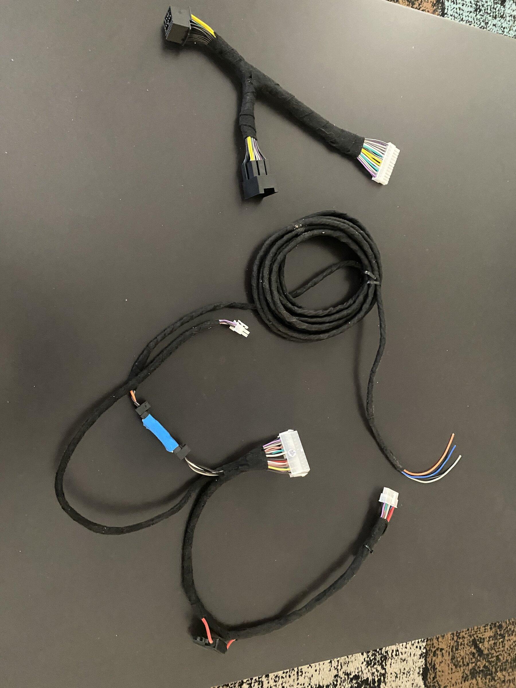

Well it’s here , kit 11.4 πŸ™Œ. Now just waiting for 4 Memphis PRX4 and 2 Memphis 5 1/2s. πŸ‘πŸ‘πŸ‘
Are there any markings or info on the load resistor part of that harness (the part with blue heat shrink)?
I can't order just that cable evidently, so just tapped in to the existing wires and ran my own, but didn't include a resistor. I'm going to use an LC2i Pro for the subwoofer that has a selectable resistor built in. Just wondering what resistor(s) were used in that harness.
Thanks.
