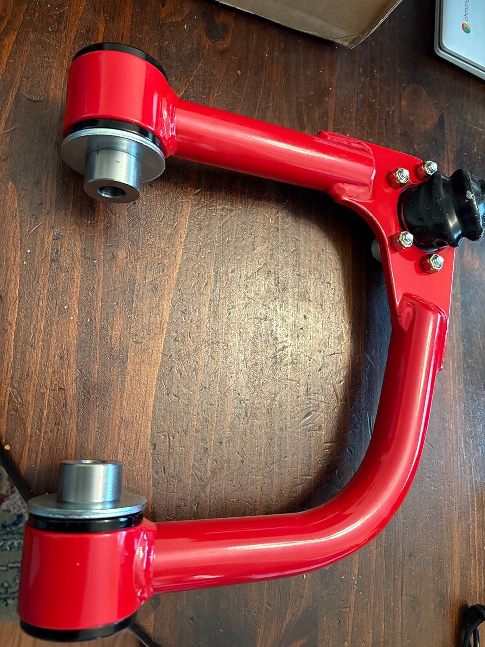

My JBA control arms just showed up! So far very impressed with the quality. The ball joint moves a full 90degrees and everything seems very stout on the control arms and very well packaged. These control arms are popular in the Toyota world and excited to give them a try. Balljoint is also easily replaceable without press on the vehicle. JBA even sent me a text and saying they would be sending me additional emails on maintenance and aligning.
Excited to get them installed! I’m running Bilstein 6112s on my 2 door badlands Sasquatch and my alignment shop couldn’t get it aligned to spec after lift on the stock UCAs. Can’t wait to see how they perform on trail especially with the added 1 inch of down travel they claim. I plan on running them with Mickey Thompson MT 35s.

Ball joints look alot like an older GM joint.

I believe you can use those in a pinch. The JBA balljoints are also fairly cheap, unlike some brands that are around $300 bucks like Icon.

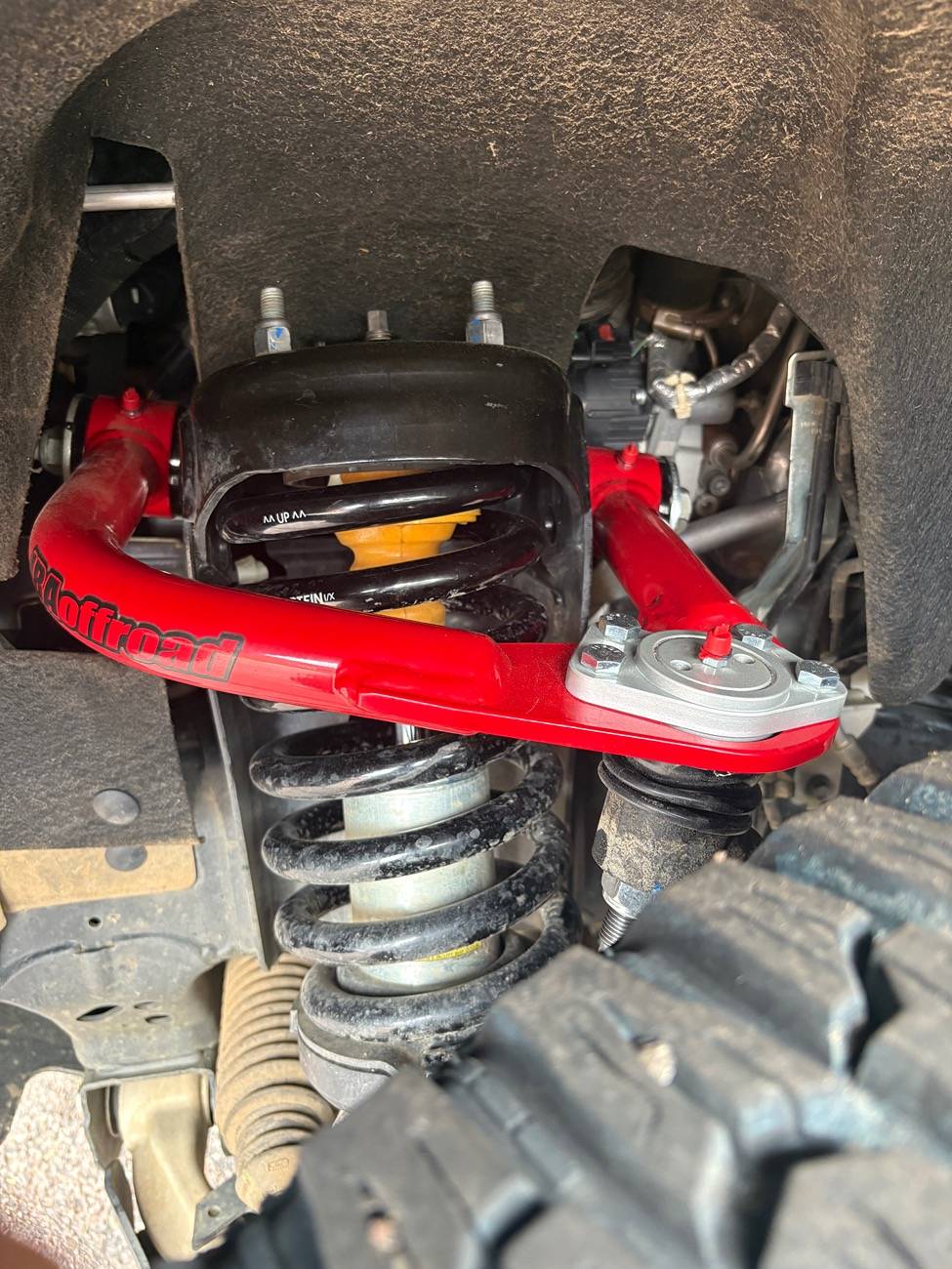

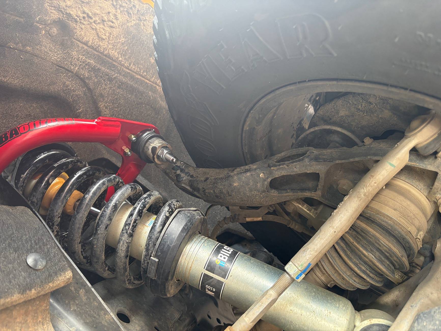

Finally installed the control arms with the help of a friend. Install was a complete nightmare. The control arms would not fit on the shock tower. We had to use a pry bar to get them on. Then the driver side we figured out an easier way. You have to go in from the top and punch the control arms down. Way easier but I shouldn’t have to do this or JBA should have something in the instructions or install video. I can’t imagine if we couldn’t get to to the control arms they would be impossible to install. JBA needs to change the tolerance on the bushings so they slide in easier.
Otherwise Bronco tracked straight on highway going 80mph and feel torsionally stiffer cornering on fast highway exits. Should feel even more different once it’s aligned and brought into spec. There is plenty of space on the control arm for multiple different shocks and a ton of clearance for big tires at full lock.
Need to get them off-road for articulation test. So far I am impressed minus the install. Took about 3 hours of cussing and yelling at my friend. šŸ˜‚
I told you so. I said there's no way these things fit. I called JBA and that's when they told me there's variances in the shock tower widths. If you watch the install video they go on with zero force.
Yeah I agree my friend is a seasoned weekend mechanic and won King of the Hammers a few years ago. He knows how to spin a wrench and it was very difficult job for him. We all had some colorful words to say. šŸ˜‚
I sent JBA a nice feedback email. Hopefully they make changes for the tolerance. After pulling the stock arms off they are so flimsy.
Super excited to see how it drives once it’s aligned and taken it off-road.
