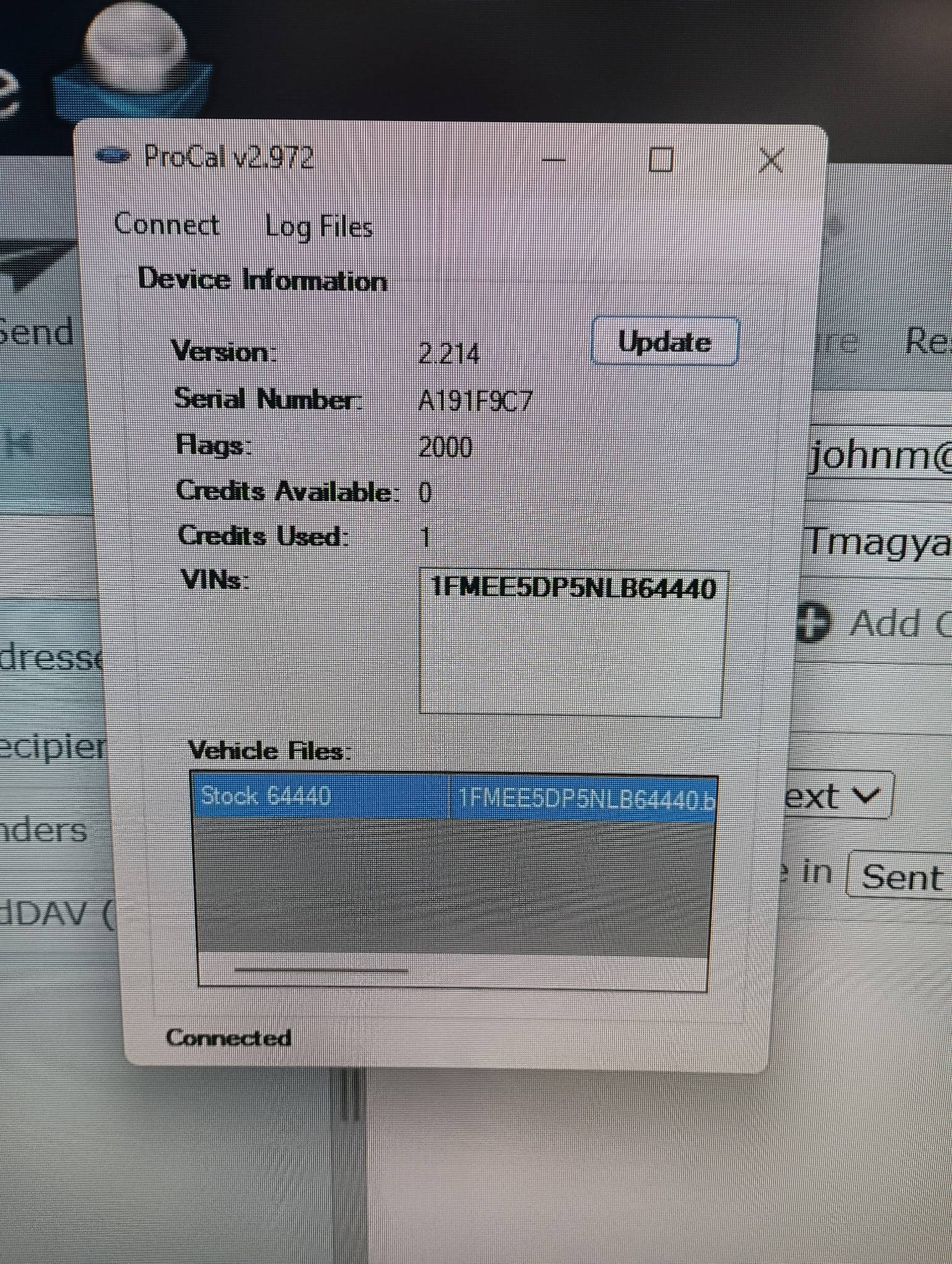

My Bronco has been sitting in the shop for three weeks now after a suspension upgrade, which also included installing a new steering rack. The issue? The recalibration software isn’t cooperating.
The mechanic followed all the steps. The voucher was registered and linked to my account.

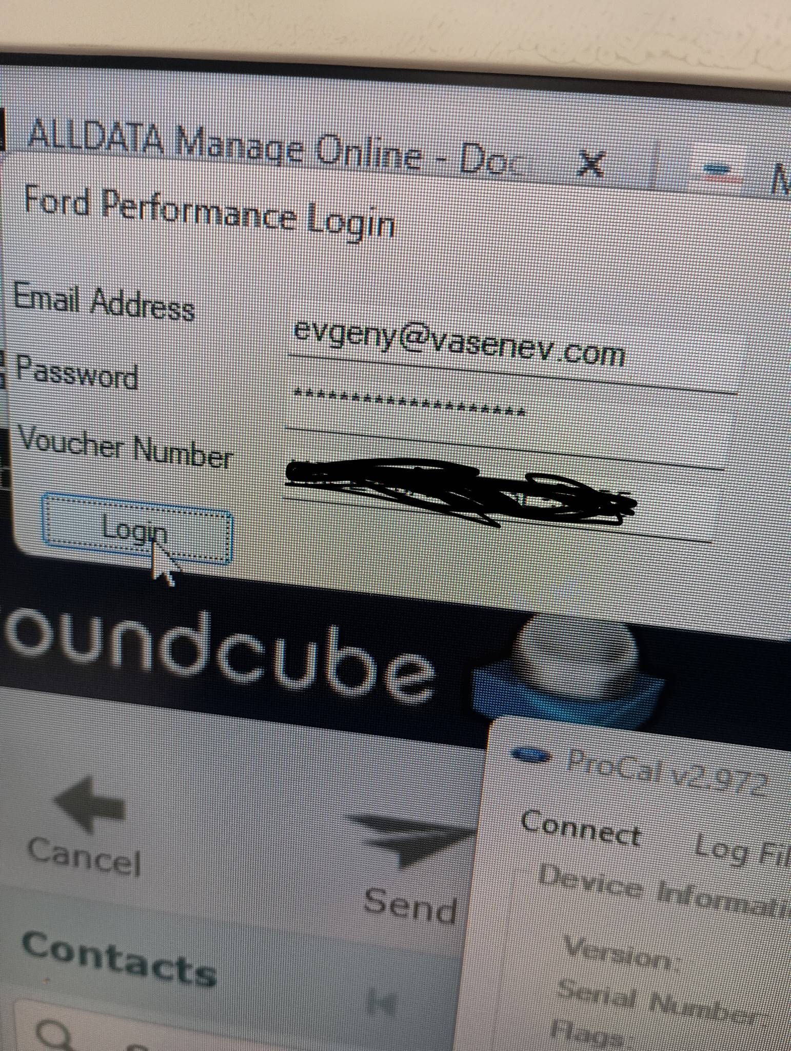

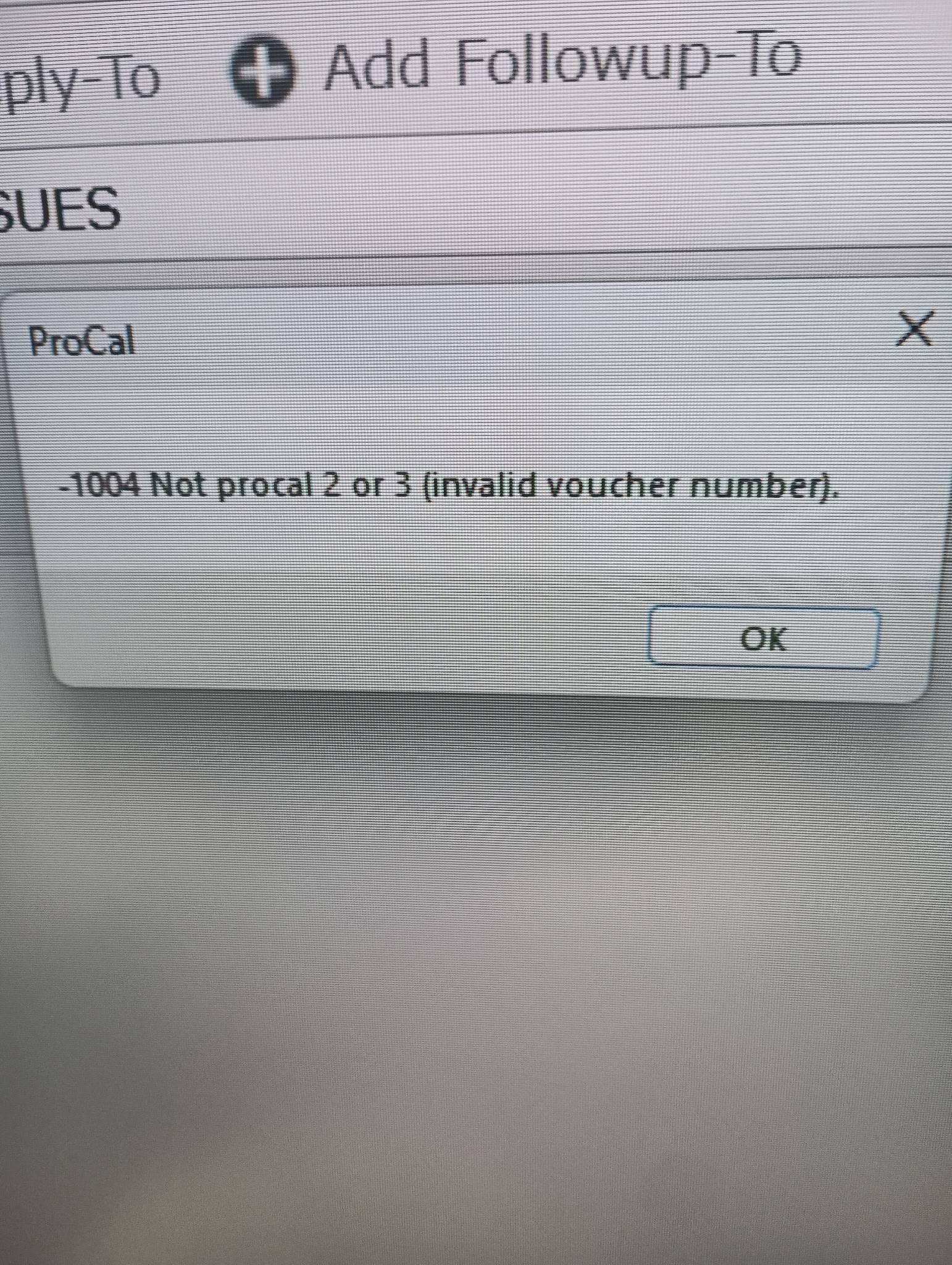

He also downloaded the software and plugged in the ProCal. It correctly recognized the ProCal, my VIN, and the stock tune file. But as soon as he logs into Ford Performance to retrieve the calibration, I get the calibration error screen.
He’s been going back and forth with Ford support, but the process is super slow and hasn’t led anywhere.
Anyone out there run into this before? Or maybe @Ford Motor Company can step in and help? I miss my Bronco—and summer’s flying by.

Known issue, particularly for folks that had the ProCal Performance Tune prior to attempting the rack upgrade.
If you can get the FP Techs to respond, they can often remote into your laptop and push a file and get it to work. But you gotta get to that step.
Otherwise... you need to use the BMB method of programming racks, which is unofficial and a dealer isn't likely to offer to do so, but works every time. There are numerous threads around here detailing how to do this with Forscan + FDRS

Not likely. The ProCal device as a software delivery tool is pretty half baked. I doubt it was anything you did
