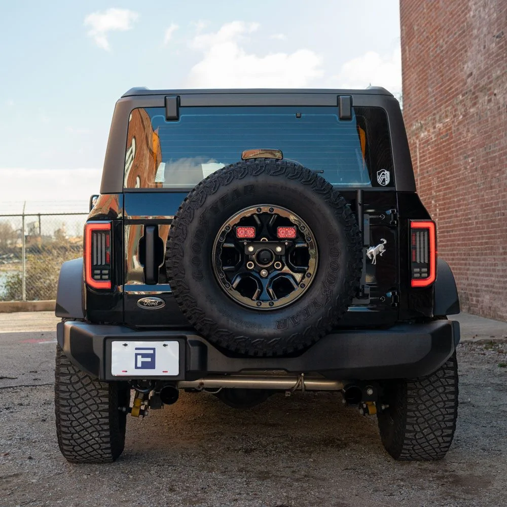

I mean raptor style non oem
You mean the ones where you see all the individual LED diodes inside the tail light? No we don't have something like that. Customers usually complain if they see all the diodes so a lot of manufacturers try to avoid that look.
The Form look like this, but work on a base Bronco
