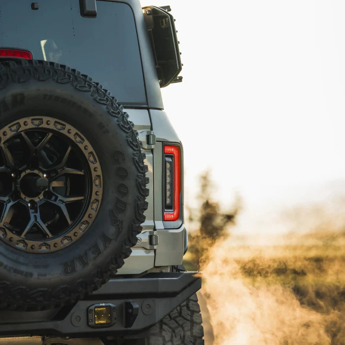

You mean the ones where you see all the individual LED diodes inside the tail light? No we don't have something like that. Customers usually complain if they see all the diodes so a lot of manufacturers try to avoid that look.
The Form look like this, but work on a base Bronco
So im out of luck then? ;(
i guess im going back to bmw after this bronco, then i dont have to worry about this again.
I mean you bought a Base Bronco :) They don't come with the fancy headlights/tail lights. I'd recommend get yourself a Bronco Raptor next time or at least a Bronco with LED tails. Then there are more aftermarket options that work without issues. But the base broncos with halogen tails... yeah those are problematic.

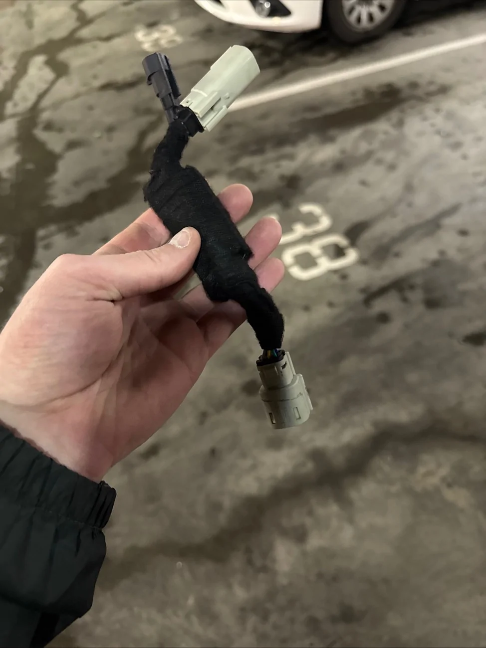

That’s super frustrating, especially after going through install that many times. From what you’re describing, it really sounds like the control module inside the light is failing, which unfortunately is pretty common on some of the lower-cost aftermarket options. Once those go, you end up chasing wiring/connection issues when it’s really just the internal electronics giving up. Not much you can really “fix” long-term at that point aside from replacing the unit, which we know isn’t what you want to hear after already dealing with it this much.
If you do end up swapping them out, we’d just look for something that’s fully plug-and-play with solid build quality and actual support behind it — makes a huge difference vs. rolling the dice again. We'd recommend brands like Morimoto, Form, or (obviously?) our stuff at Oracle! We do have a set of LED tails for the Bronco that are designed to be pretty straightforward and reliable, and we’ve got some sale promos coming up next month if you decide to go that route. Either way, hope you get it sorted soon, stuff like this is the worst!
I switched out the module to the other light and it didn’t work, but then I used the working module on both lights and both of them worked fine with the tail signals. So its one of these that is the problem
