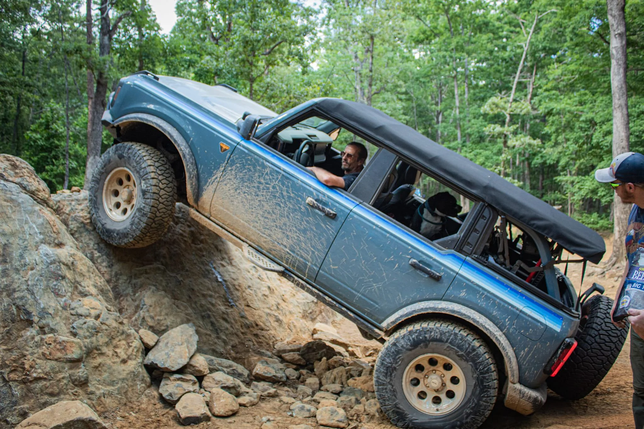

I've had that longer receiver since I first put it on the Bronco last February, It did drag in the dirt at Uwharrie once, when I did this on the Poser Rock last May;
Ford Bronco Is this normal? Hitch sticks out 1676158229139
And it is just enough to keep you from dragging the spare (37") into the ground.
All I tow with it is an 8x6 utility trailer to the Dump, and this puts the ball out just perfect to where I can put the trailer on without worrying about the spare, But I do have to be mindful of the drop leg handle, it'll poke into the tire if I back up to sharp.
As long as I don't have a ball in the receiver, I've never hit it with my legs, but I can see where someone would if they weren't paying attention.
I would say for my all around use, the longer receiver tube is the better choice, but I do have to be aware of it when going up a steep face like above.
