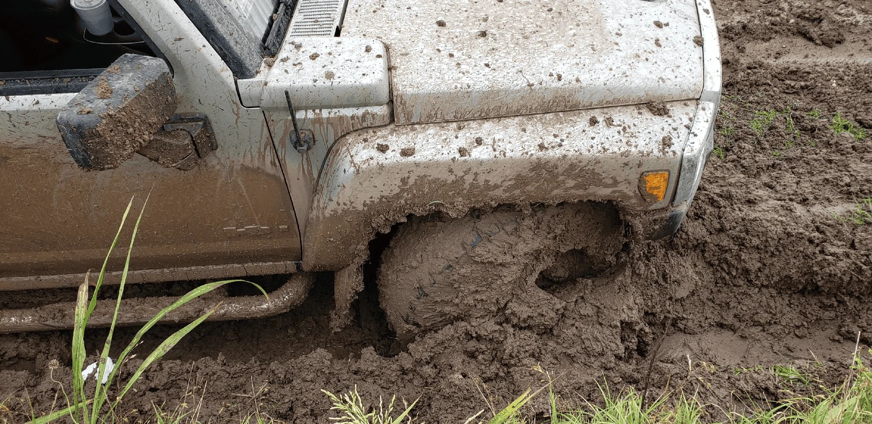

A Locker is a good thing to have....trust me
Ford Bronco Is Locking Rear Differential something I want? 1604011640070-png
No lockers.... get out your boots, recovery tracks, your shovel and be prepared to spend some time getting muddy

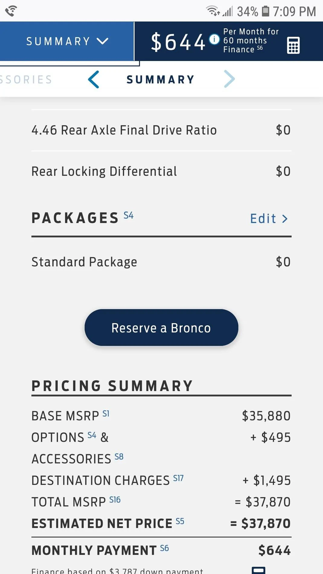

Appears You are correct. In BB trim the ONLY ratio for manual (non squatch) is 4.46, and it allows you to add rear locker for no addl charge! I think that's a great deal! If I were buying a BB id take that! It also appears that 4.27/locker are a package deal for auto trans in that trim, and 3.73 is open only. I don't have a ready reference for this...but I can tell you that there is going to be a carrier break somewhere between 3.73 and 4.27 and the e-locker only supports the ratios upwards from the carrier break. What's a carrier break? Most Dana axles need a different carrier to install ratios above a certain number. I don't know the advantek well, but the old dana 44 had a carrier break at 3.92, and d35 was 3.55 IIRC. D30 I KNOW is 3.55, I don't wana discuss why I know that so well:mad:. But anyhoo...that's why! Oh and carrier=locker...they are the same physical part...only if it's not a locker it's gotta be called something...so it's a carrier...get it?
Sadly, the B&P does bill you $495 for the 4.46 locker.
It just doesn't have a price listed, or tick all of the boxes.
Here's a screen shot of a 4D BB with only the 4.46 locker selected.
Note that the options line says that a locker wasn't chosen, but the final Summary has a $495 charge in it.
Unselect the 4.46 locker, and the mystery $495 charge goes away.
Since this is Oct 31st, you got a trick , not a treat, from B&P.
Sorry.
