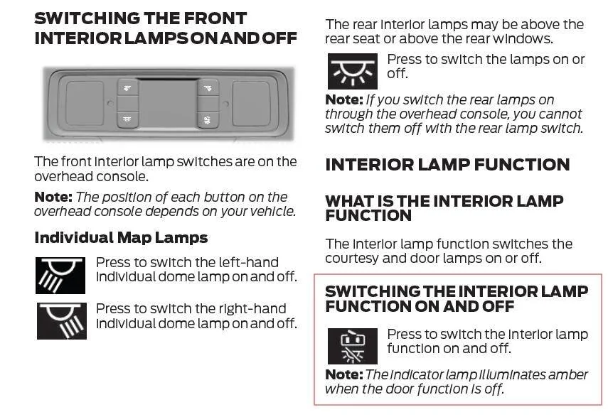

helifino16
Ron
Aug 12, 2021
2,956
5,107
Mount Sinai, NY (Long Island)
From the Owners Manual:
Ford Bronco Interior lights not turning on when doors are opened 1739203935400-zd
Yes, and I saw that in the OM, but it wasn't working for me. I'm not sure what was going on. I noticed that I had to turn on the ambient lights, and then for some reason that button started working. A feature or a bug? LOL
BigFootie
Oct 25, 2020
4,538
11,269
Wisconsin
Yes, ambient lights must be on for the interior ones to work. I guess a toss up if it was planned for some special reason or a quirk.
