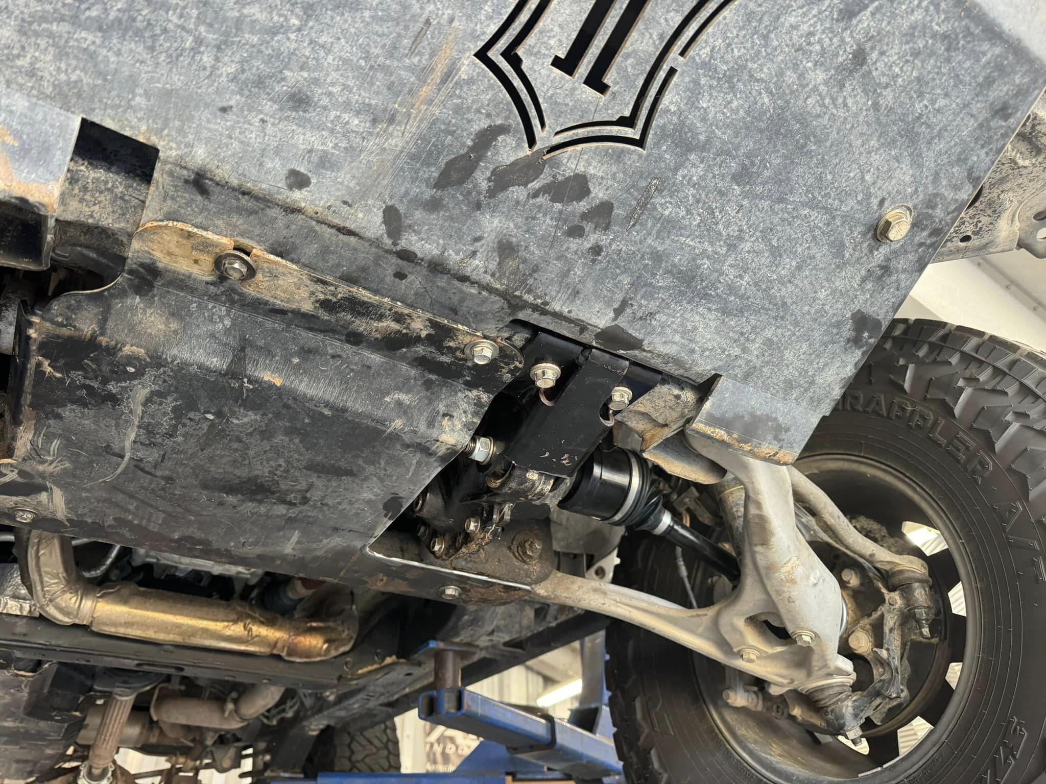

Hey Dusty, do you have the Icon skid plate? If so, can you show the modification needed? Thx!
I do have the Icon bumper skid and diff skid. As of now I've only cut it for clearance for the dropped diff. I haven't fabricated a new bulged section for it yet. Here it is with just my hack job:
Thanks for the pic. The skid is the reason that I haven't installed my diff drop yet. I have the Icon skid as well - still trying to figure out the most elegant way to go about the modification. I may just go the same route as you for the time being. I would love to see what you come up with as a permanent solution.
Yeah I wish I had time to finish it up now, but we have Big Bear Bronco Bash coming up in a couple of weeks and I'm almost out of prep time, and have a few other things I need to get done before then. So this is just sort of a temporary hack. At least the steering rack motor is protected LOL.

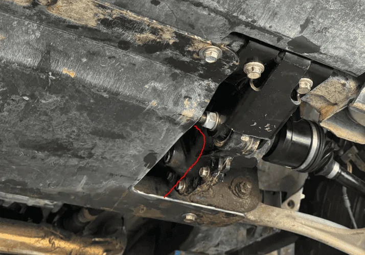

Dusty, looking at your picture, it looks like you could have kept some more skid material around where I drew here:
Ford Bronco Installing TeocaliMG's front differential drop kit 1716244780044-ad
Is that the case? or am I missing something? Either way, like you said it wouldn't be too hard to fabricate a special bulge plate for the diff. I don't know if i'll ever get around to it for mine, may just try my luck as is.

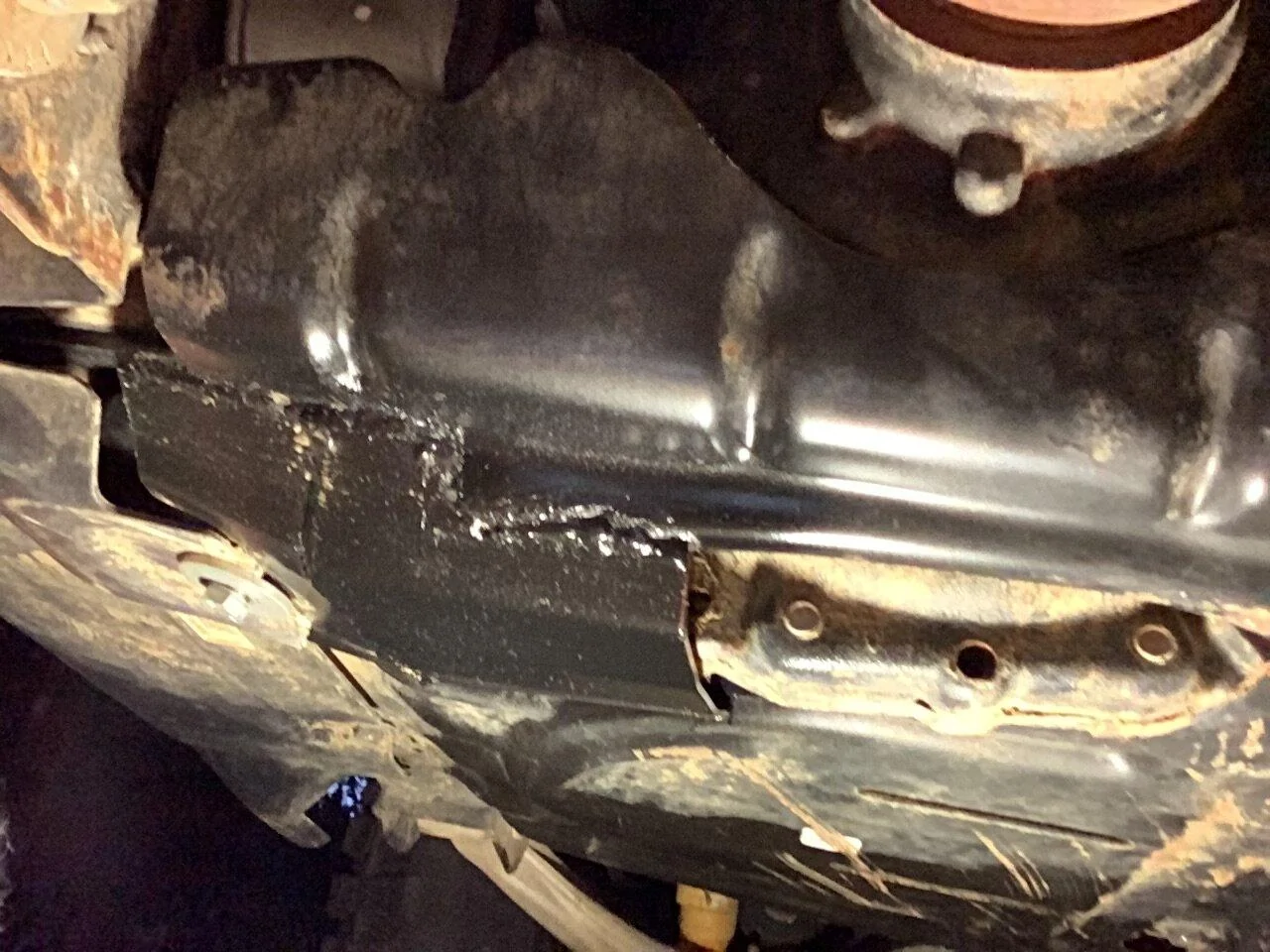

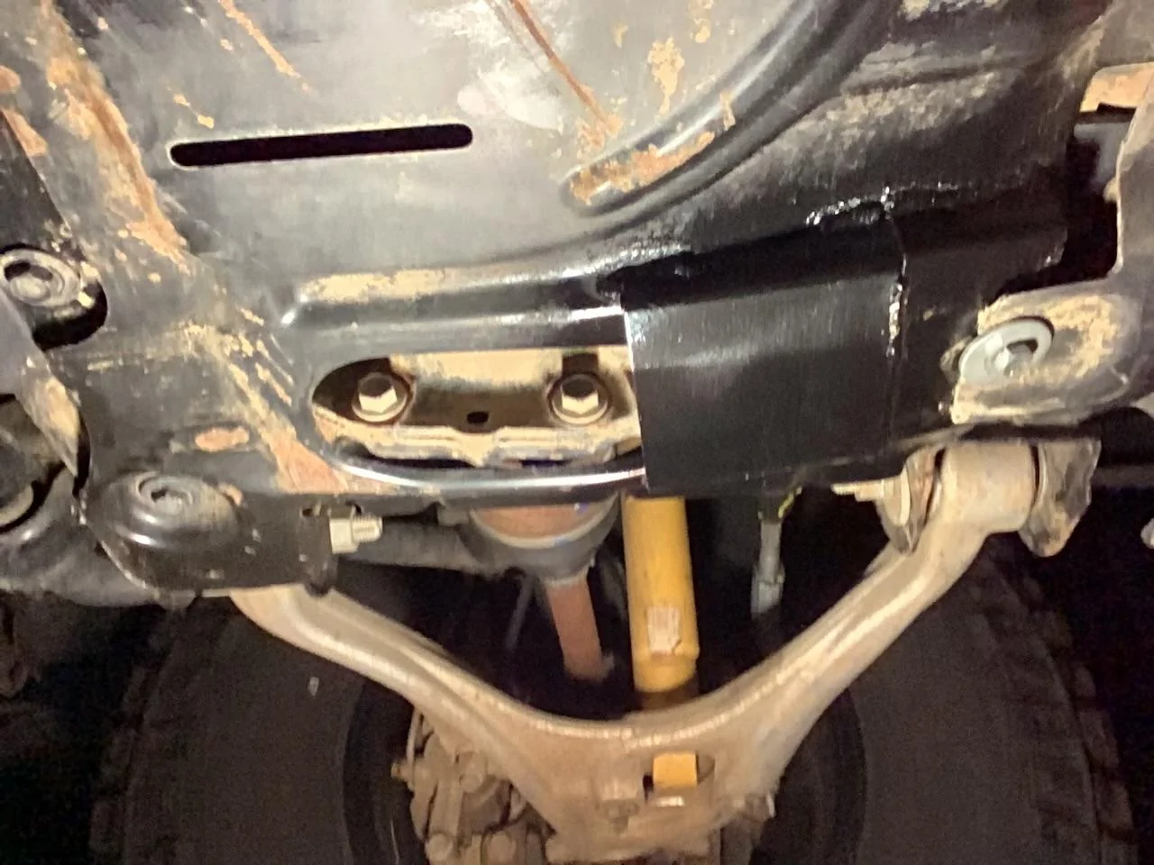

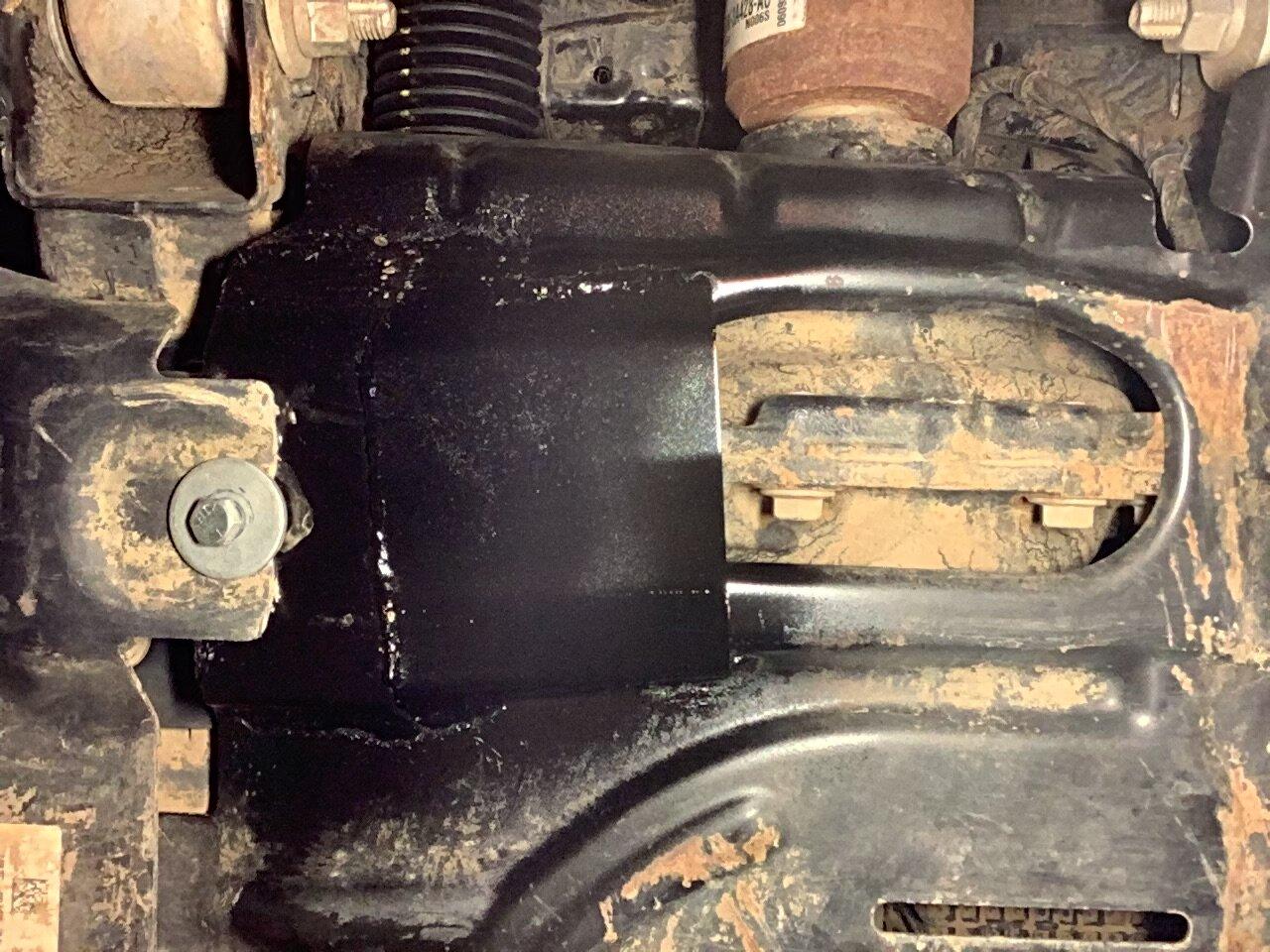

I just went out in the dark and took photos of my skid solution…not pretty but good enough I hope…stock skids, drilled and tapped mount to keep same bolt location…
Ford Bronco Installing TeocaliMG's front differential drop kit IMG_0617
Ford Bronco Installing TeocaliMG's front differential drop kit IMG_0616
Ford Bronco Installing TeocaliMG's front differential drop kit IMG_0615
There was already a smaller cut-out in the skid, that began along that line (where the rounded corner is next to the bolt) so I just continued along that line to make it a simple cut. I don't like having unsupported flangey-thingies hanging out in space. So I just cut it straight back to where the two cuts would meet. I did take the time to cut that corner with a hole saw first, to give me a nice radiused inside corner though :) But yeah, the entire thing will get re-covered up whenever I have the chance to get the fab tools out.
