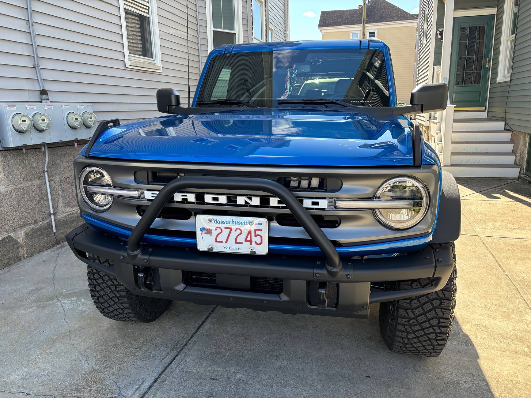

I tried many searches but couldn’t find anything to answer my problem. I ordered a New Headlight switch with the fog light option So is the wiring harness already behind the bumper for direct plug a play ??? Or do I not change the headlight switch and use the optional upfitter switches ???

Damn !!! No sensors in my front bumper. Thanks guys.
