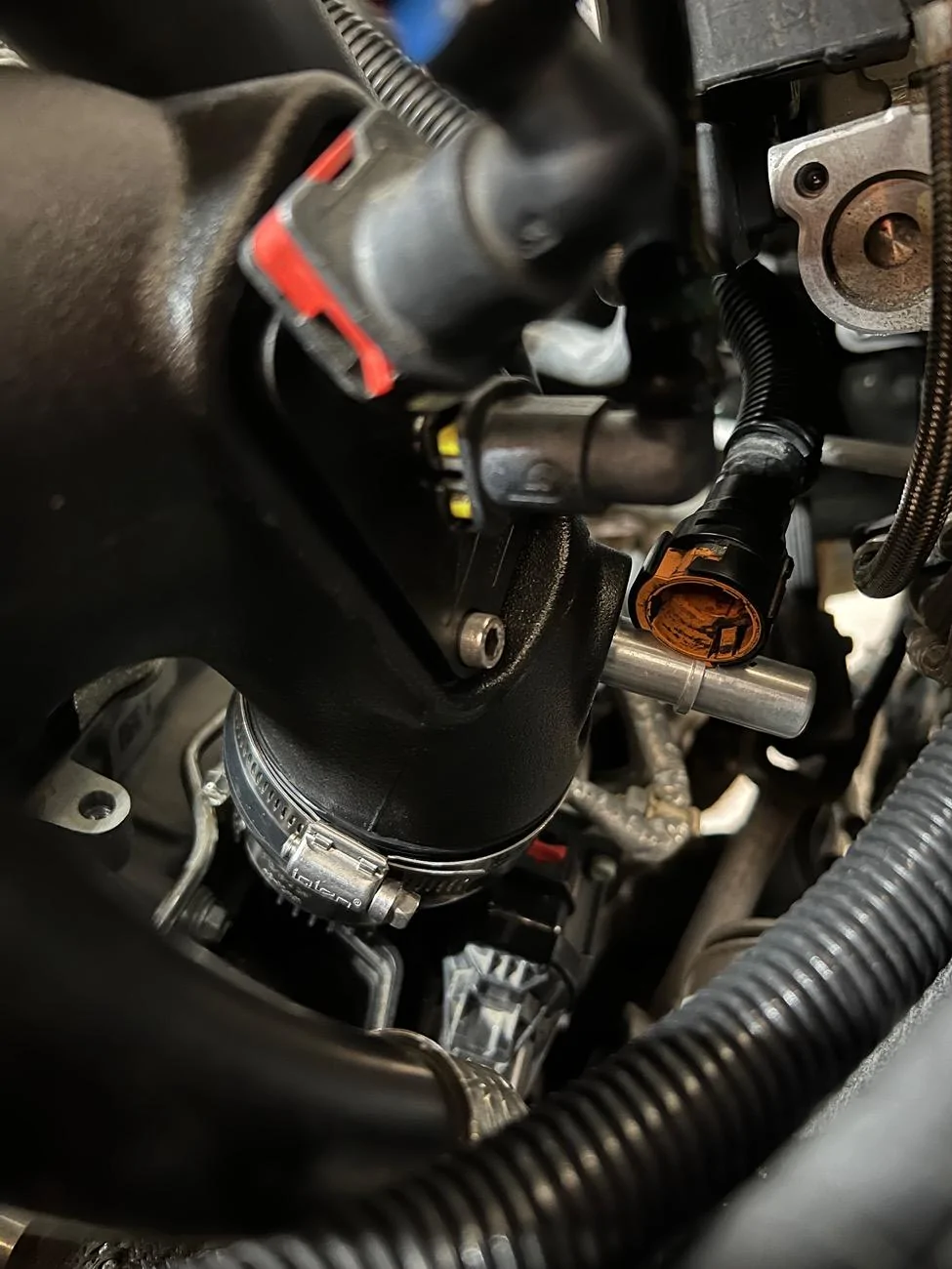

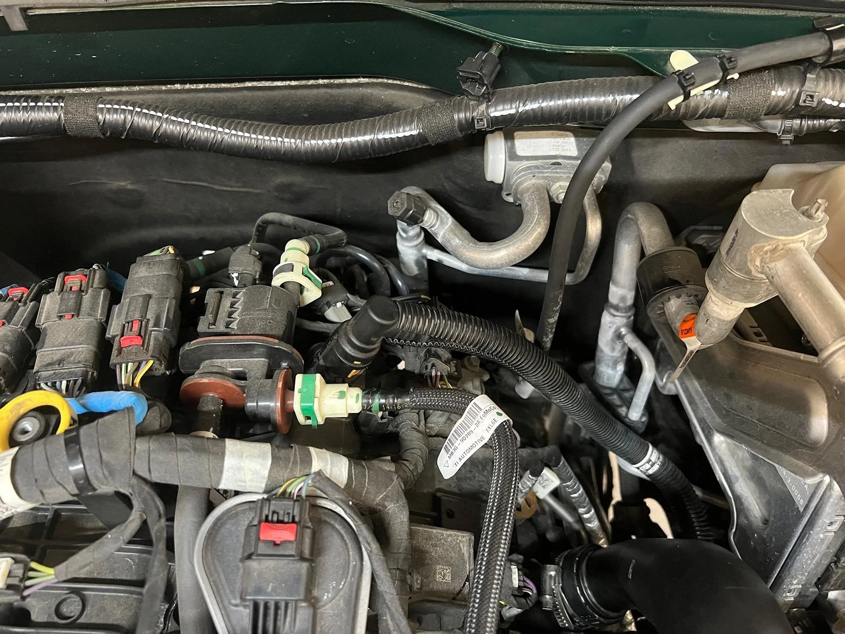

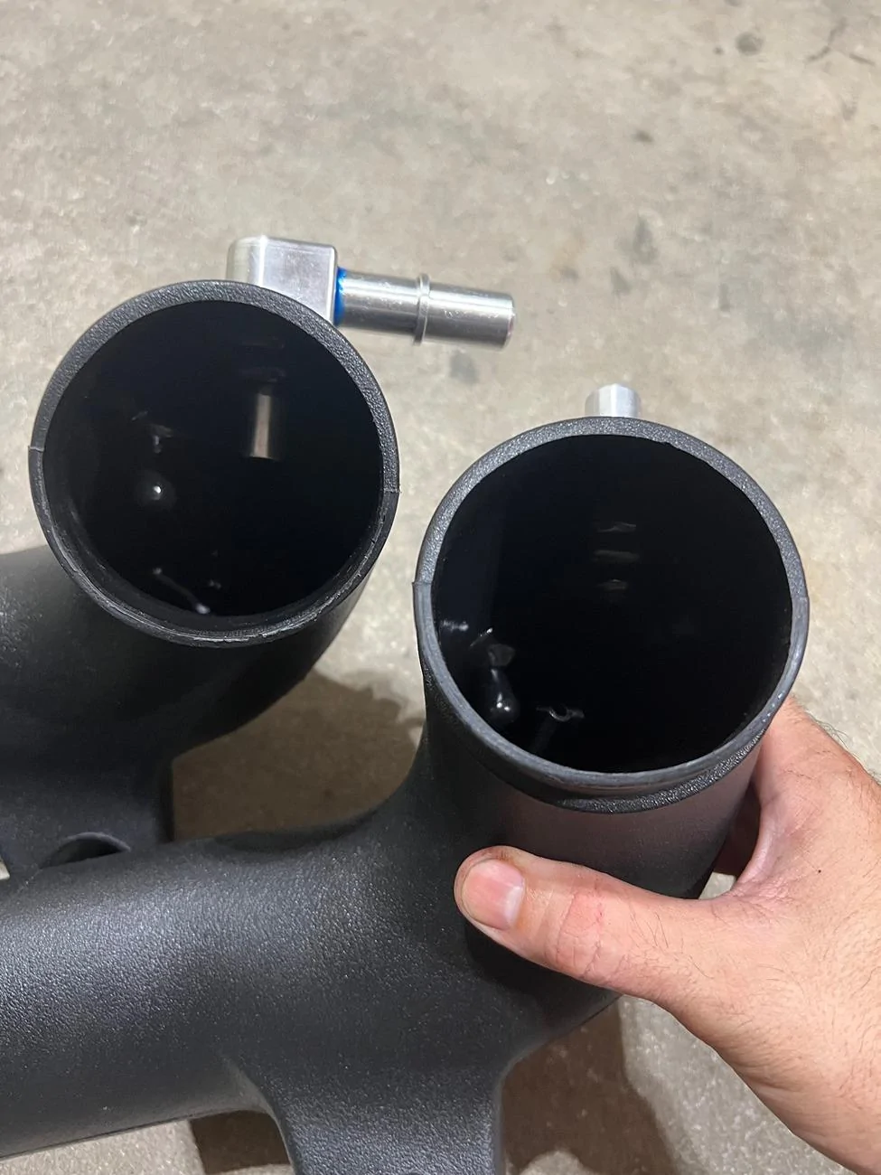

I’m in the middle of my CAI installation - I’m just encountering this as well, looking forward to what Injen saysI just installed the Injen CAI, but I have a problem with the drivers side pipe. The crankcase hose bib goes straight down and not 90 degrees. I compared pics from Green Machine and Doublejay and the crankcase system is different even both being 2023. Mines is like Doublejay’s.

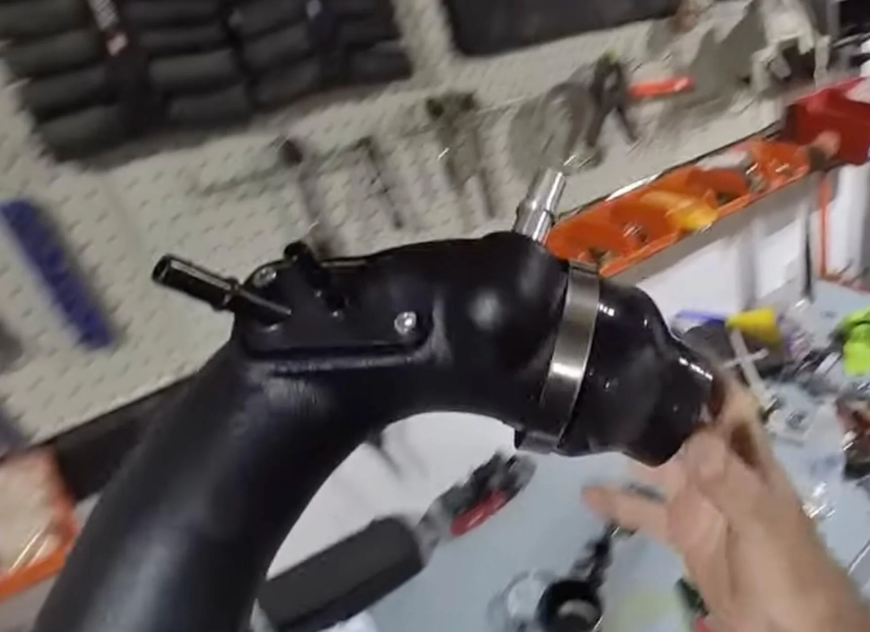

This installation video shows the tube with the 90 turn (13 mins 51 seconds).
I’m gonna have to wait till Monday to get in touch with Injen since the call center is closed for the weekend. I prefer to not reinstall the stock system to just revert it back again when the correct pipe is sent.
