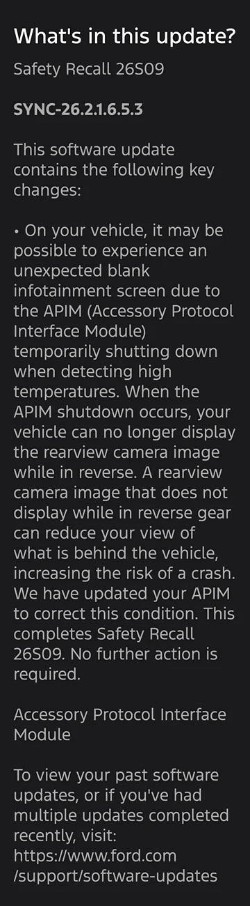

I received the update on our 2022 last week sometime.
RSNovi
Mar 21, 2026
MI
2022 Bronco OBX
To add a bit more detail. We purchased our 2022 last fall used. I drove it daily and never had the issue with the backup camera being blank. I had the camera recall completed late winter and started seeing the blank backup camera. It always occurred right after vehicle startup so the fact that the update notes mention temperature is a bit unexpected to me. My son is driving the Bronco now so I don't know how it acts after the update.

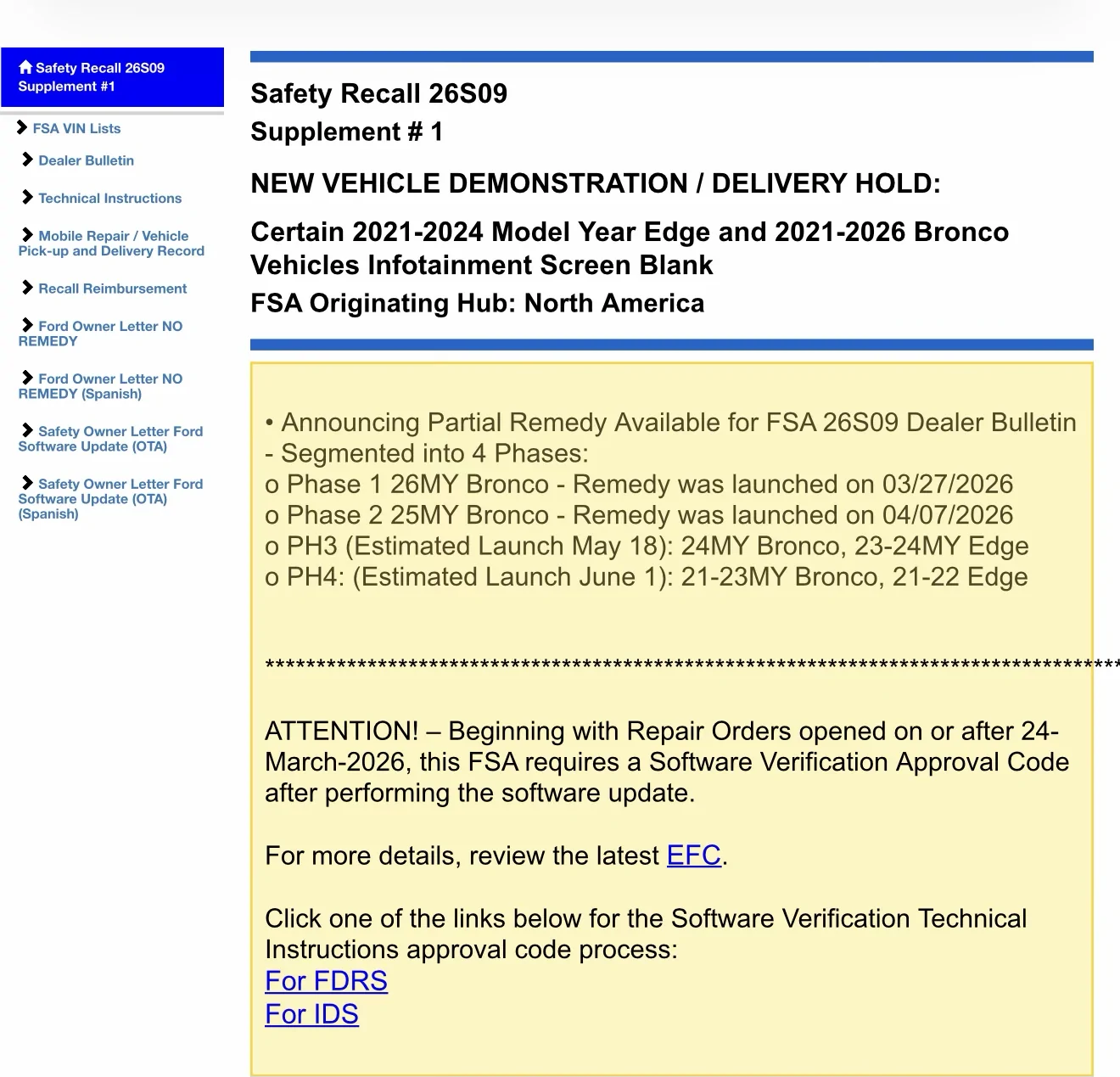

Is the fix update done automatically or does the dealer need to do it when available?
It is available OTA. But those come whenever they feel like it, so can't really say when it would happen.
The picture I posted is when the software will available in FDRS for dealers to do it manually.
