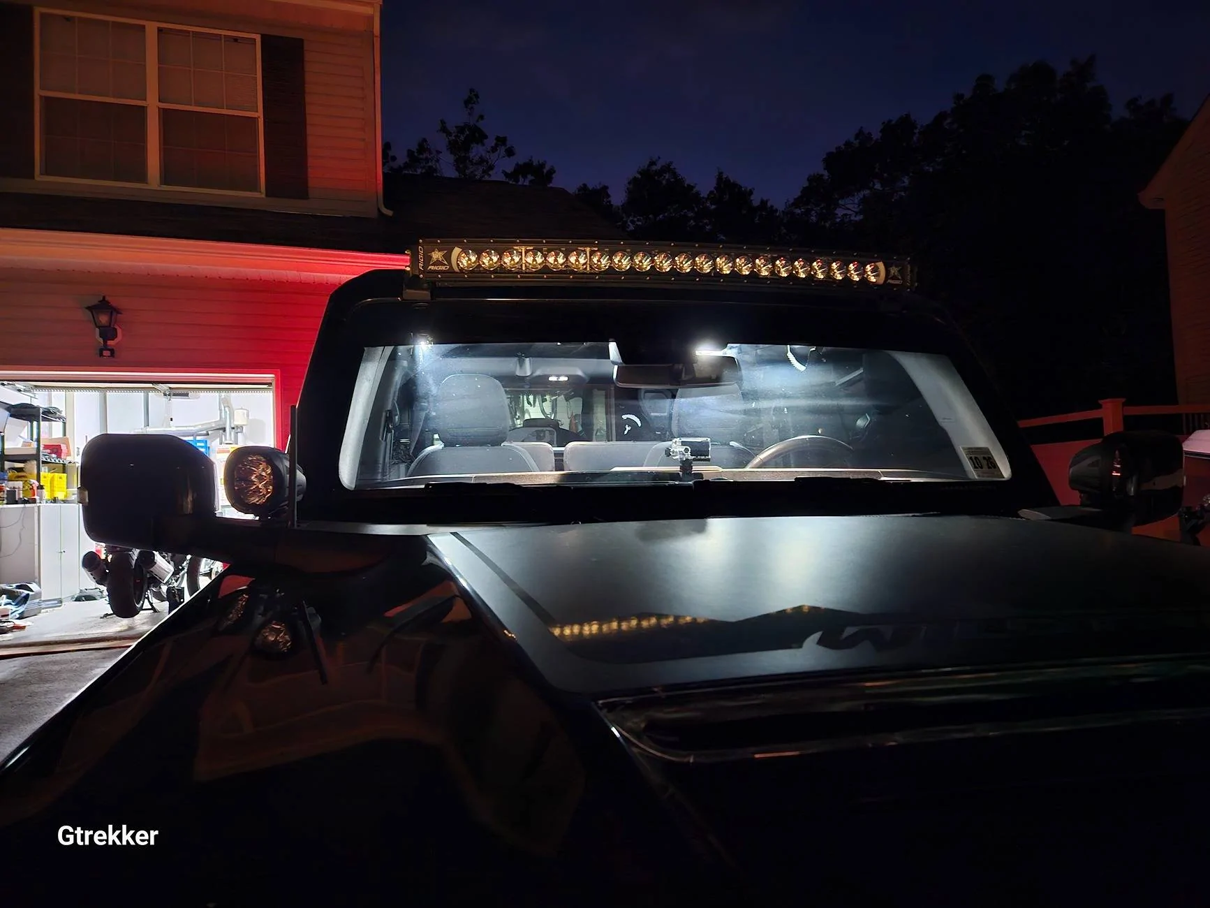

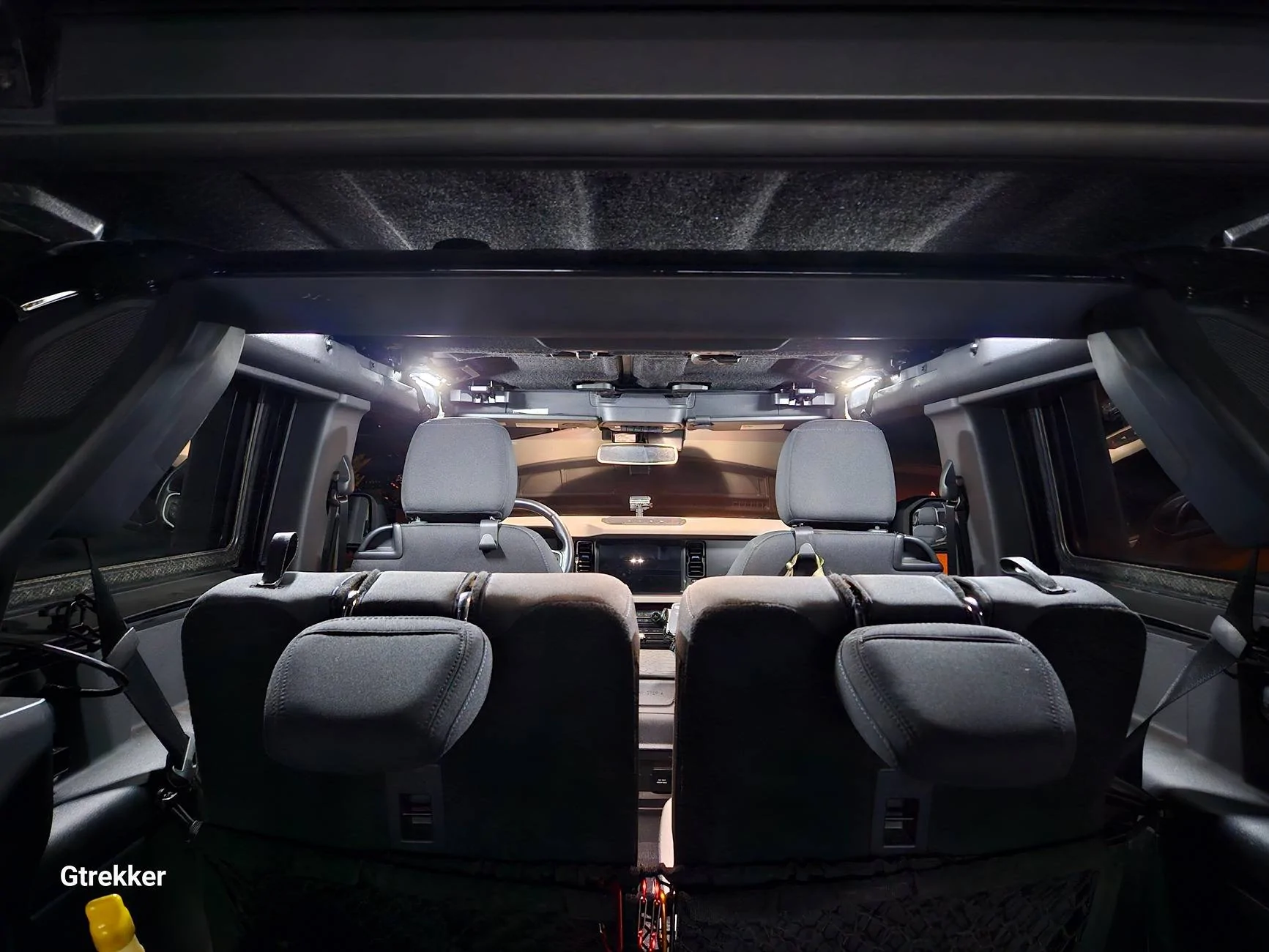

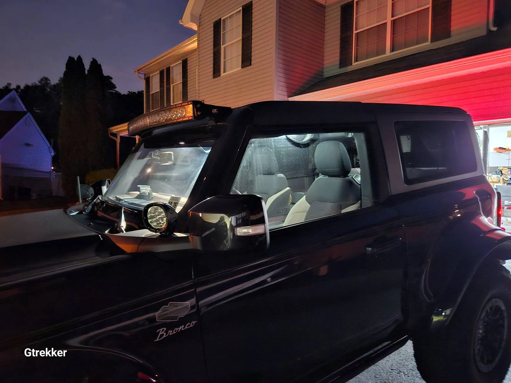

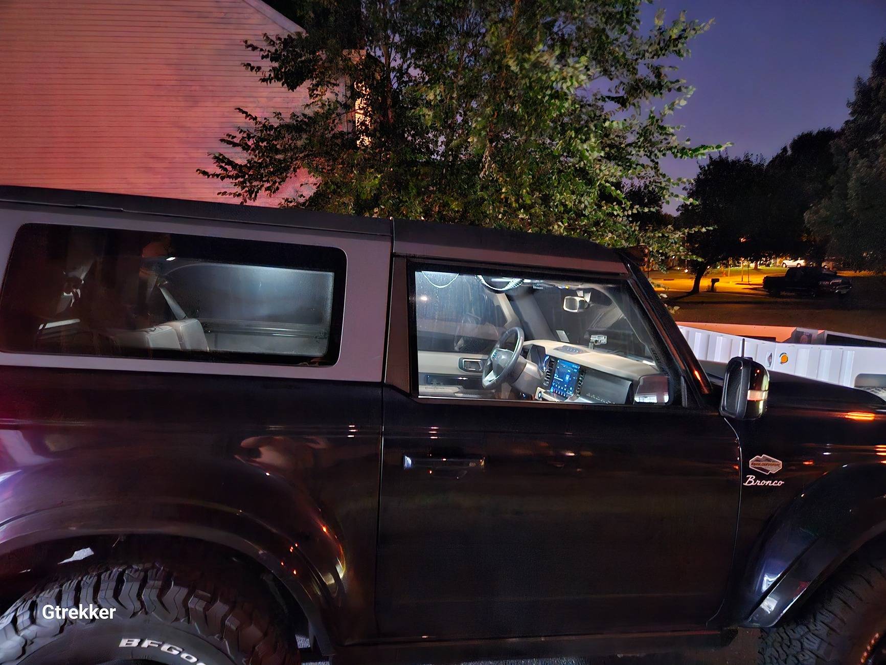

Hey,
Just my 2 cent on the interior lights.
I went with the Grab Handles and integrated lights when they 1st released.
So i have four grab handle lights in a 2 door. All I can say is let there be light!!!
Ford Bronco IAG Dome Light vs 4 Piece Kit 20240814_204715
Ford Bronco IAG Dome Light vs 4 Piece Kit 20240814_204731
Ford Bronco IAG Dome Light vs 4 Piece Kit 20240814_204539
Ford Bronco IAG Dome Light vs 4 Piece Kit 20240814_204659
Install was simple...
Amazon does have an upgrades dome light that is the same but brighter.

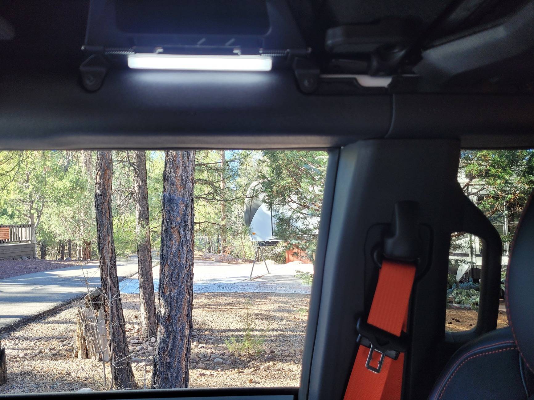

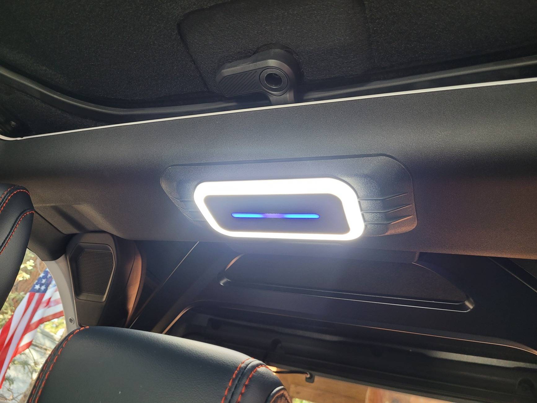

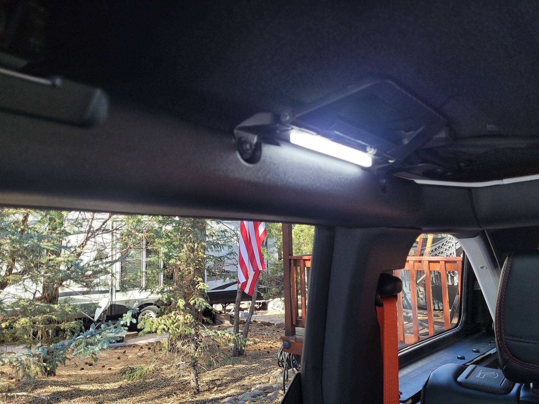

But here you go:
Gotcha. Appreciate the response and detail. That’s definitely going to be handy when I take on my upgrade. I like the upfitter switch solution.
Yeah, some where having issues with the 4-light setup and they had to play with the dimmer switch to get them to work correctly. The overhead AUX switch panel is more convenient for me and with the updated rear dome light there is plenty of light to get in and out, load stuff, etc. If I need more light, its available.
