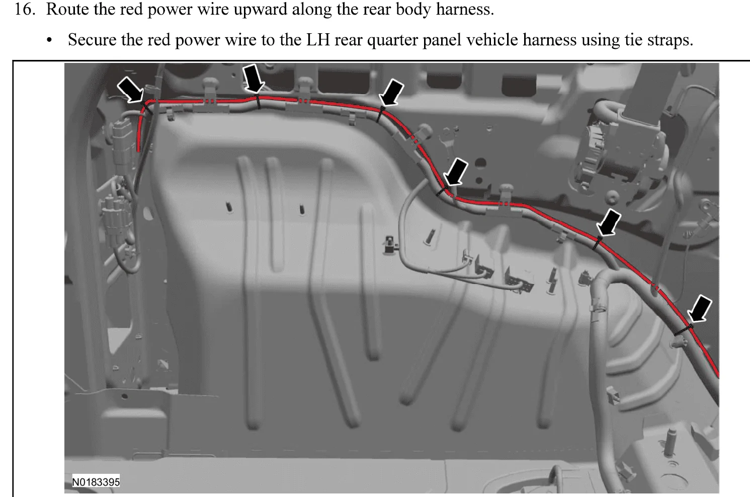

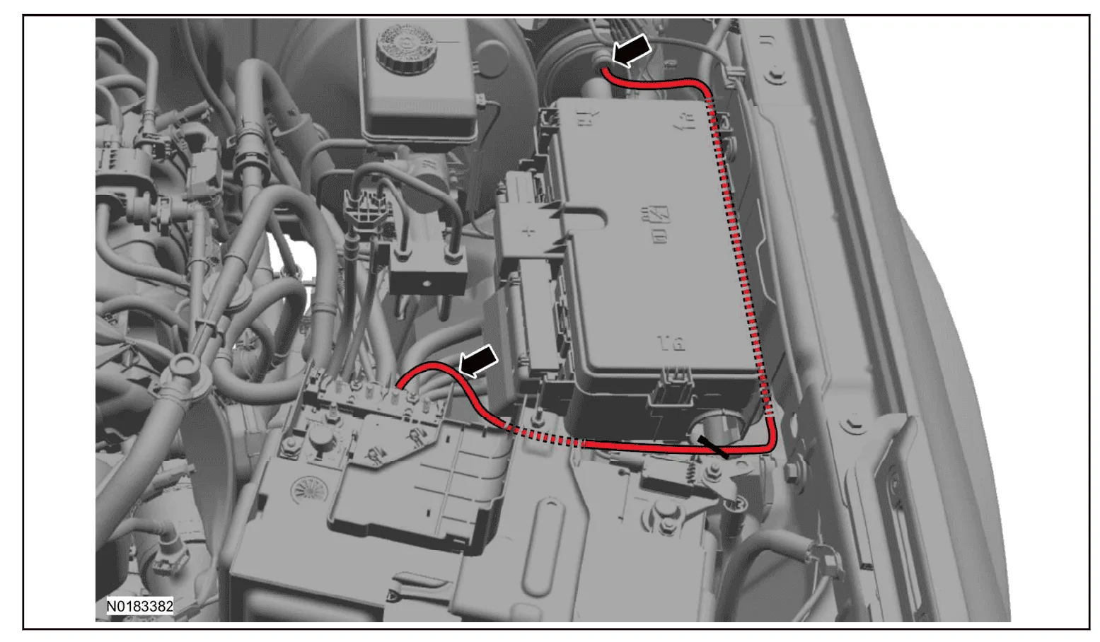

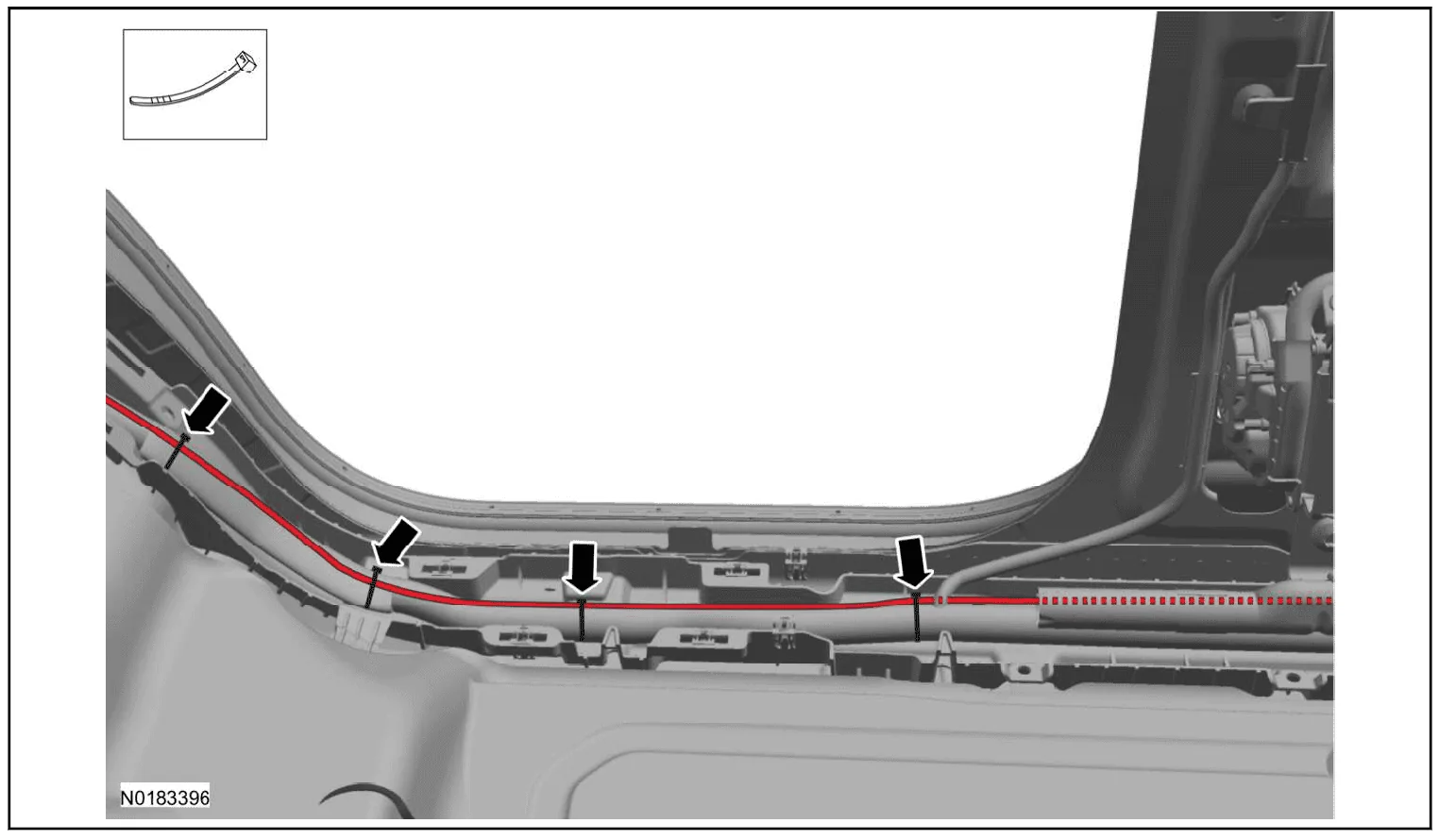

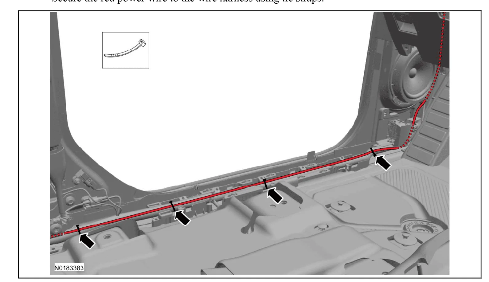

They are about the same effort if you do a factory-quality install and route the power wire inside the bronco (under interior panels), through the firewall grommet, and to the battery. If you do a budget install and route the power line under the body and along the frame to the battery then it can be a lot faster - just be sure to avoid pinch points, properly armor, and heat-shield.
Ford:
Curt:
The above is a fair assessment. Underneath is quicker but you do need to watch where you route and how you tie the wiring off.
