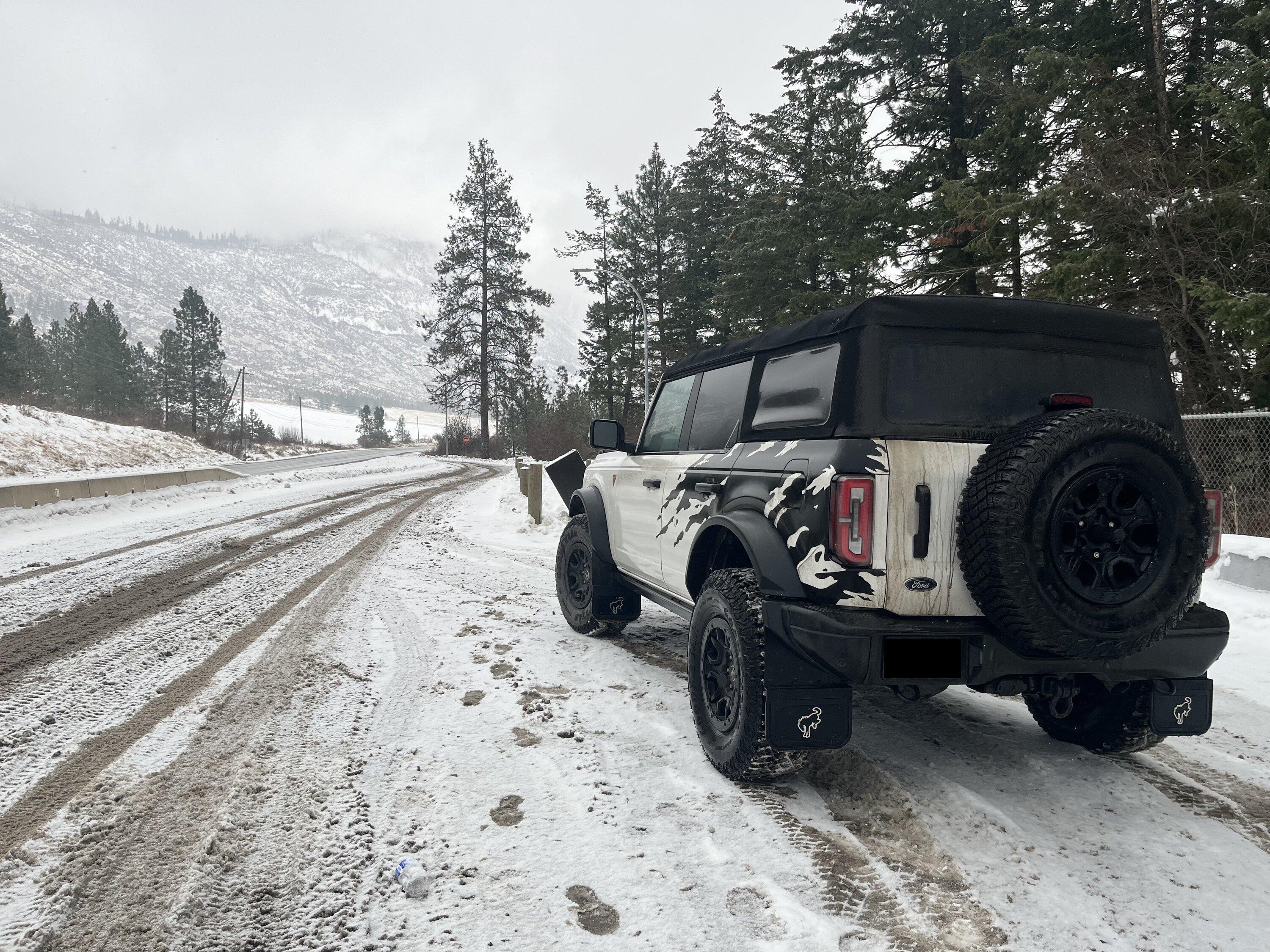

I had the Gatorback mud flaps on my Bronco - They were awesome! Just took them off yesterday for some new rock sliders I installed. The nice thing about these too is you can remove the bottom portion very easily, to regain some ground clearance while off road.

I didn’t personally install them but if memory serves there did have to drill two holes on the back. I think the front used mostly existing holes, but may of had to drill one. I actually took a couple pictures before un-installing them which might help you.
Front:
Ford Bronco I need mud flaps, whats everyone using? IMG_1613
Back:
Ford Bronco I need mud flaps, whats everyone using? IMG_1612

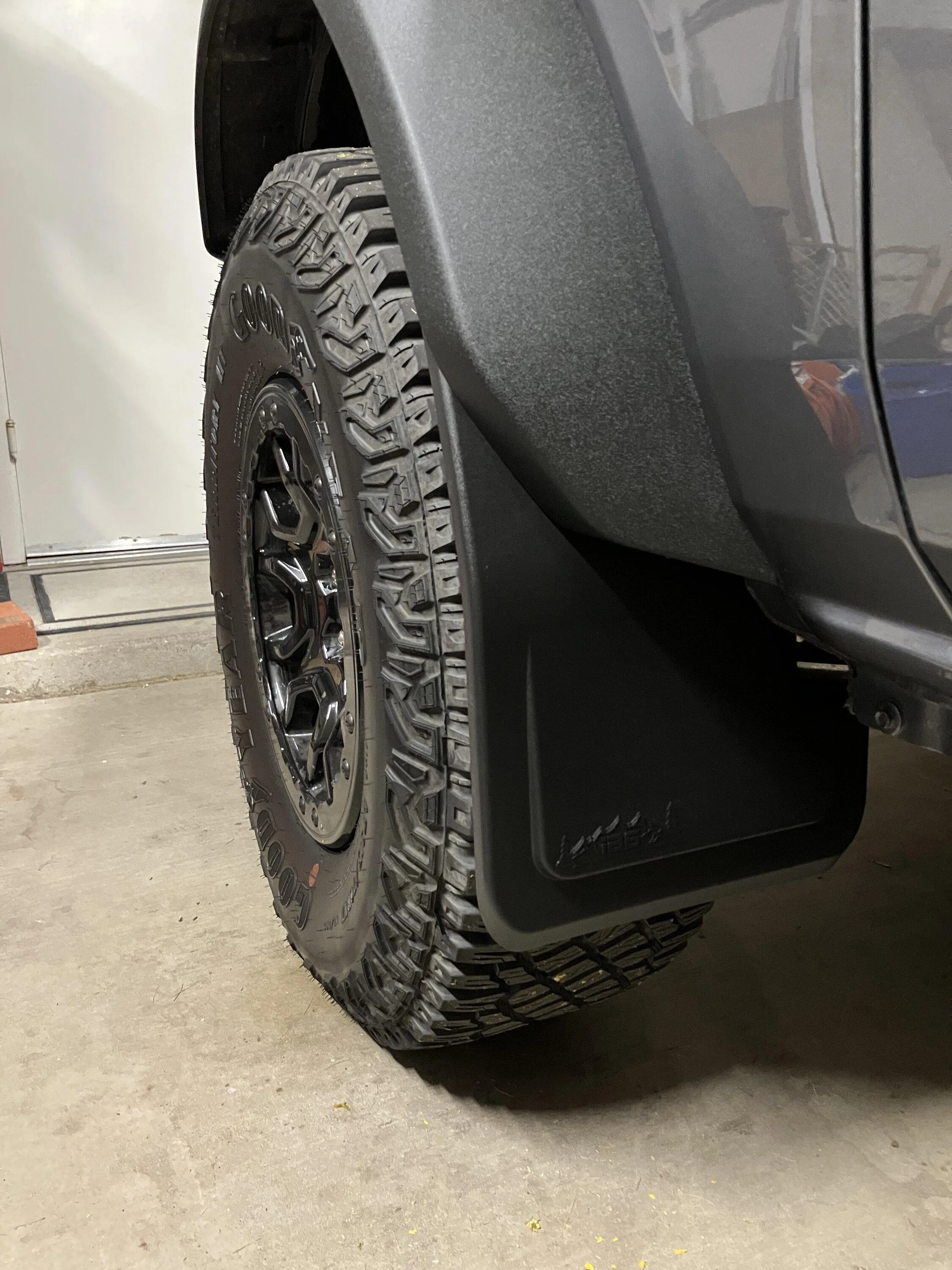

Rekgen XL. Pricey but happy with how they work. Only put the backs on because it hurt my brain to just have fronts.

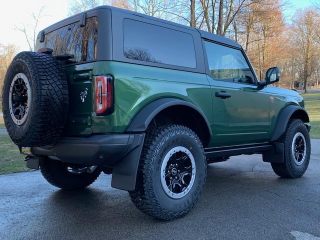

WeatherTech has flaps for both the SAS and Non-SAS models and 2 different style rears for either the metal rear bumper or plastic. They have a indent to fit with the rock rails on a Badlands. The WeatherTech and Rek Gen are the only 2 brands that use a plastic style clip on the front fenders to prevent galvanic corrosion. Rek Gen does not offer a rear flap though that fits with the metal Badlands bumper. Some dislike the front flaps having a gap but it allows for fender removal and also no packing of mud, salt, snow, ect. Can be found on sale for about $100 for the complete set.
Here are the WeatherTechs on a Badlands SAS.
Ford Bronco I need mud flaps, whats everyone using? My Bronco c
