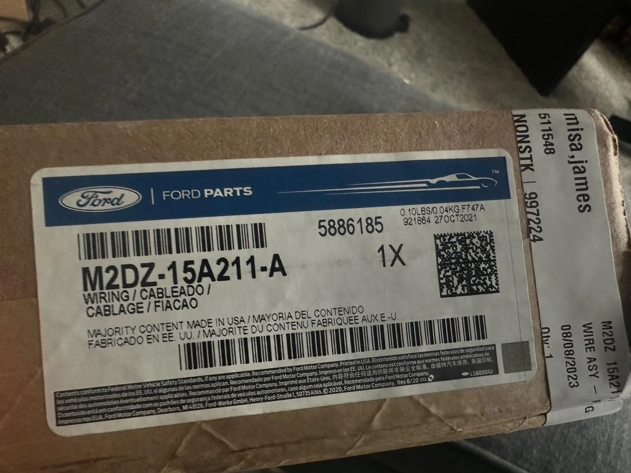

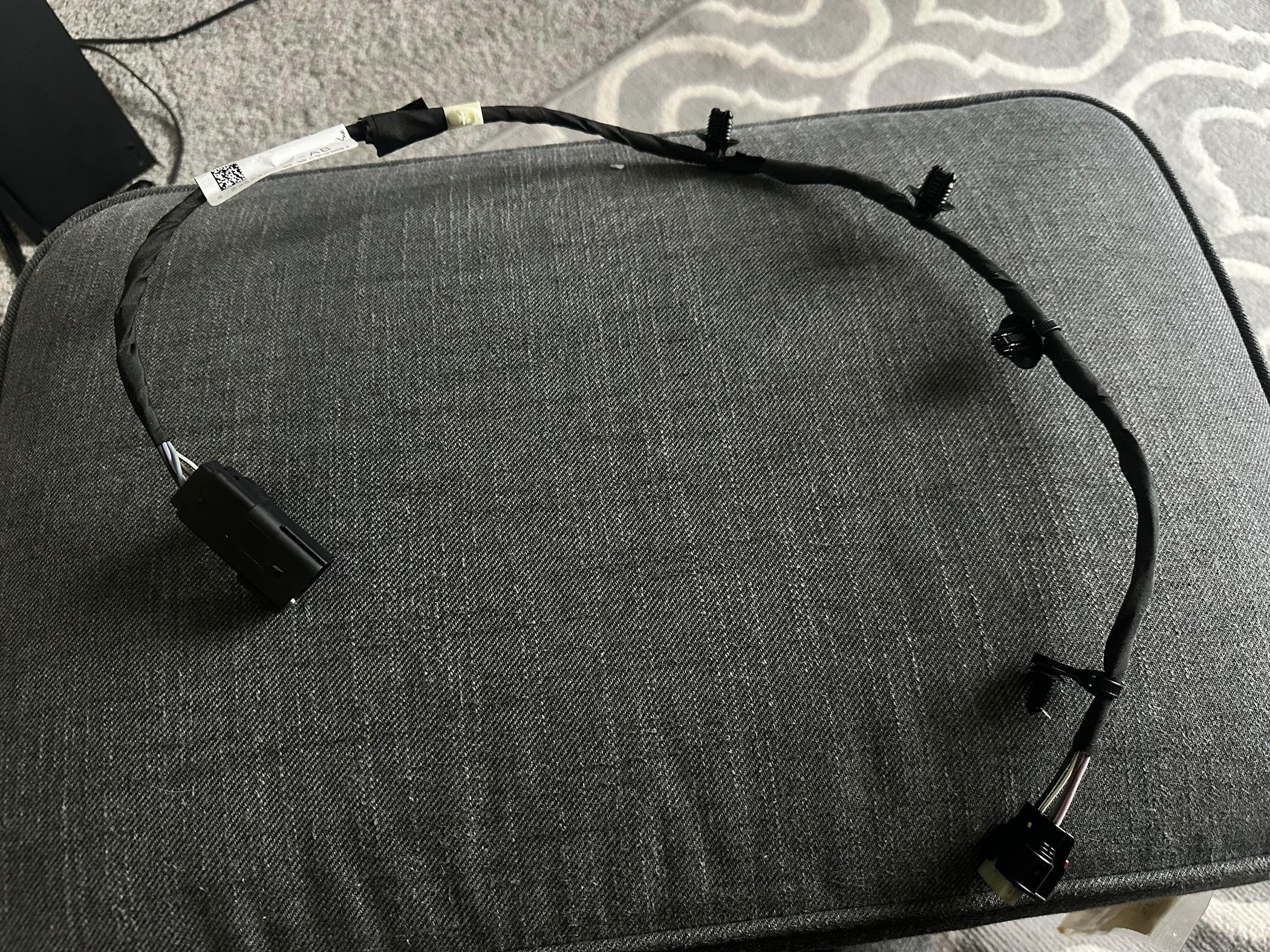

What was the harness part number he sold you? Any idea what year the donor bumper came from?
it was this harness? it didnt seem correct. Also I bought the bumper off a late 22 or early 23 bronco owner.
Yea, completely wrong. Make sure to return and the -M or -L like @Ducati1098 listed in his reply. I have the -L on my '23 with front park sensors.

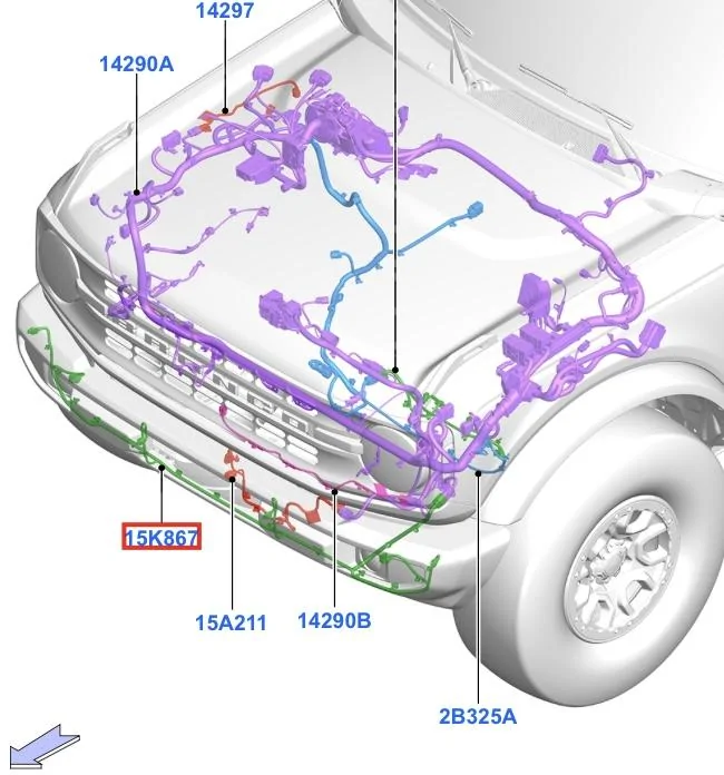

Does this plug into the control module only what about the part number from the lights to this harness? Or does this whole harness run from switch to lights. Need the (M version for my base with new capable bumper no sensors)
No, it plugs into a different main harness shown in post 6.
If you didn’t have this front harness to begin with, you would need to do some additional wiring to make it work because there’s no place for it to plug into.
