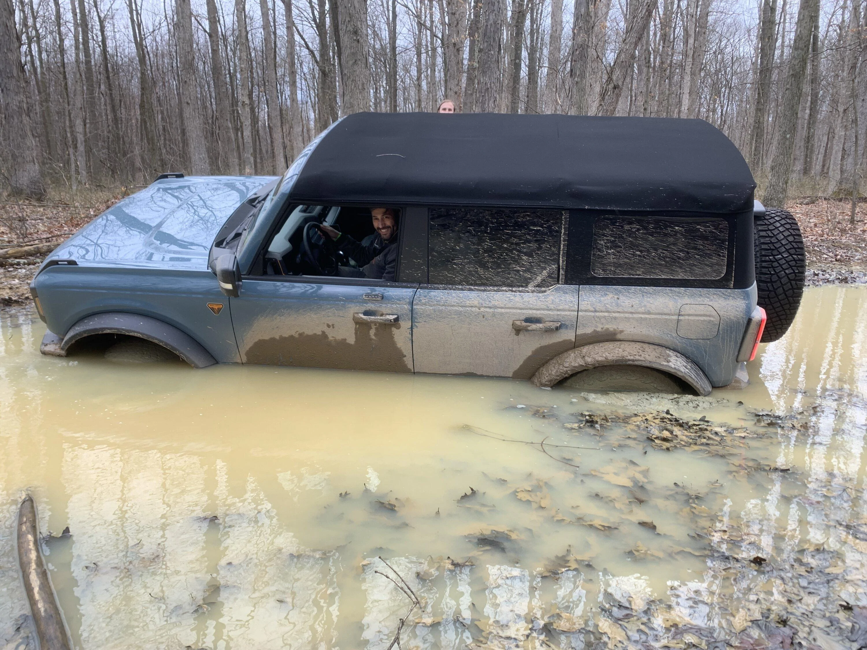

How tough is this thing?
broncabilly
Aug 15, 2023
71
southeast michigan
How long did she sit like that?
I dunno maybe 20 minutes.
Also for everyone's amusement:
I kicked my shoes off to attach a front winch line, and walked into the water. With all that was going on it didn't really register but in the back of my mind somewhere I was thinking, 'why is it only mid-shin deep?' It was about that time that the not completely hardened false bottom gave way and I plunged another three feet down, where the real muck was! Oh, and then the skies opened and it started absolutely pouring. I'm really grateful to the several trucks that were out there offering their help, even during the downpour. Good people.

How does the air filter look? That will tell if water got in the intake or not.
broncabilly
Aug 15, 2023
71
southeast michigan
Completely dry. I know it doesn't have water in the intake. As I've said, it has water in the crankcase.
broncabilly
Aug 15, 2023
71
southeast michigan
No picture of the oil. It was pretty slimy and chocolate shakey under the cap. Changed the oil within a couple hours. Will flush and change again at least once. Coolant fine. Left it running the whole time (maybe shut it off once?) Other fluids look fine.
Now I'm worried about the uncheckable transmission fluid.

The alternator on the 2.3L and 2.7L are only maybe an inch difference in height. The alternator was appears to be submerged in your picture plus they don't like muddy/silty water. The picture of your engine bay shows water was splashing everywhere so I am sure the alternator stood no chance.
As far as the water in the crankcase, I think sitting in the water for 20min is what did that in. I was in water for about 3 min before being pulled out in a somewhat similar situation and everything was fine. My problem was that water soaked my air filter and stalled the motor. I would check to ensure there are no oil leaks with the new oil and do the oil change again like you plan to do.
The transmission and differential breather hoses are very high even with it not being an Everglades model. They are by the brake booster in the engine compartment. If those were to be compromised, I think you would have a lot bigger issues going on. I believe your transmission fluid is fine.
Just my thoughts but glad you made it out and it could have been much worse.

I have to say, I kind of thought that most people would look at that picture and share my amazement that I'm spending so much on repairs. Others I've shown have looked at pictures and were also incredulous that anything was wrong with it at all. I guess it is what it is.
All this aside, I really do LOVE this truck, a lot more than I expected to in fact. I'm a Rover guy and have had one or another for a long while, currently an LR4. I never had and always wanted a Defender and I had really super high hopes for the Defender before it came out. And then it came out. And while it's a fine vehicle, it just isn't a Defender. When I got this Badlands, I started to realize how it is nearly exactly what Land Rover should have built, albeit with waaaaaay higher quality interior plastics, LOL.

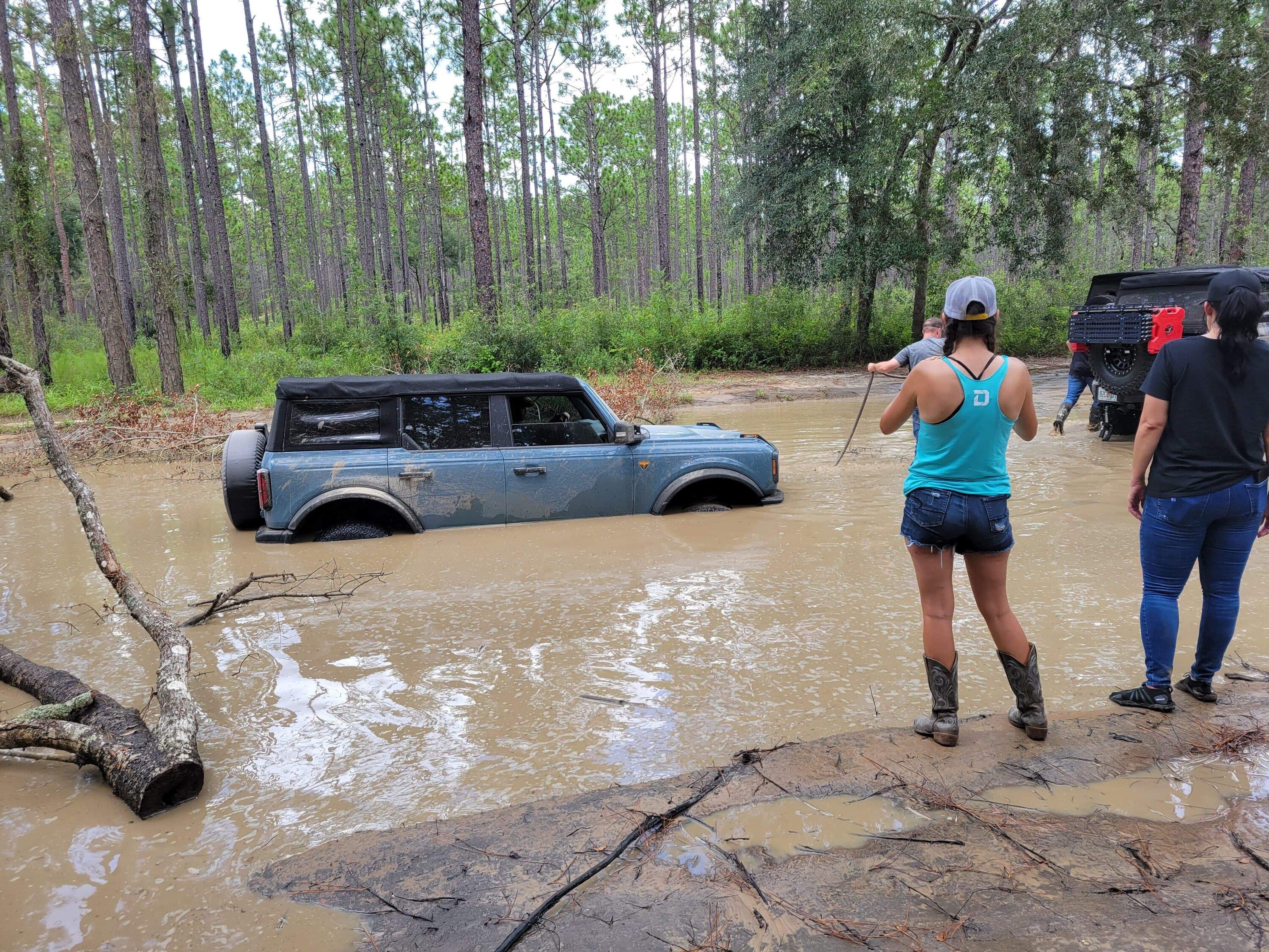

Mishra42
Dec 2, 2021
150
210
Pittsburgh
Yeah I'm pretty surprised this happened. This is me 2 months after getting my Bronco. I never shut the engine off, and the alternator was a little off until I had the engine bay professionally cleaned, but otherwise no problems. I guess I did have the passenger side a little bit higher up. The dash showed about a 19 degree lean.

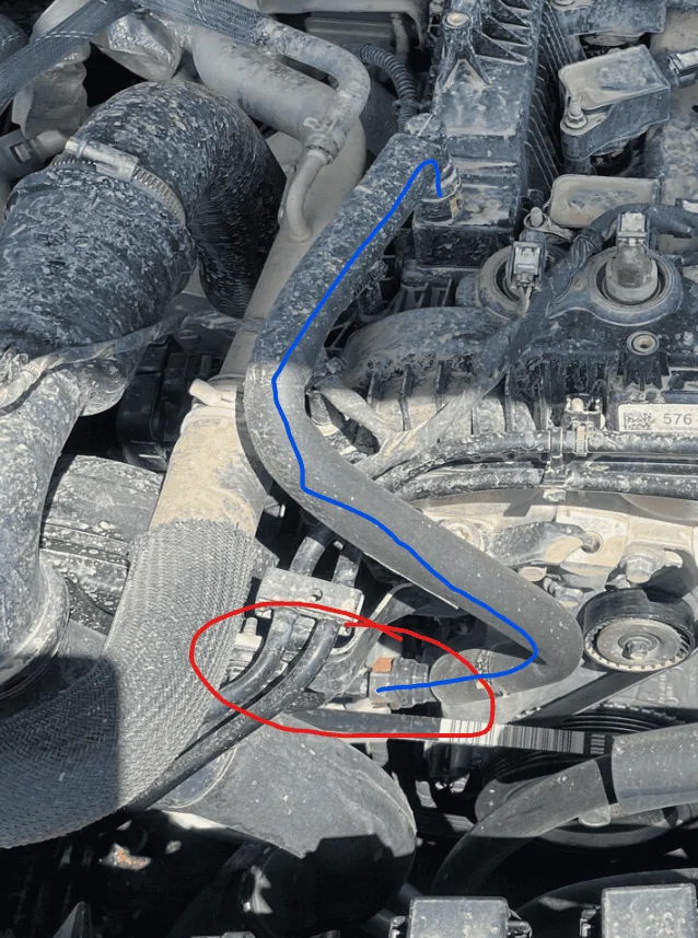

Jdyount
Jason
1,065
3,019
Kansas
2021 Badlands
I'm guessing the problem is RIGHT here... That is the crankcase vent tube (blue line) and it was likely underwater or partially submerged which is why you sucked water into your crankcase. PCV = positive crankcase ventilation, this is where the PCV system intakes fresh air.
