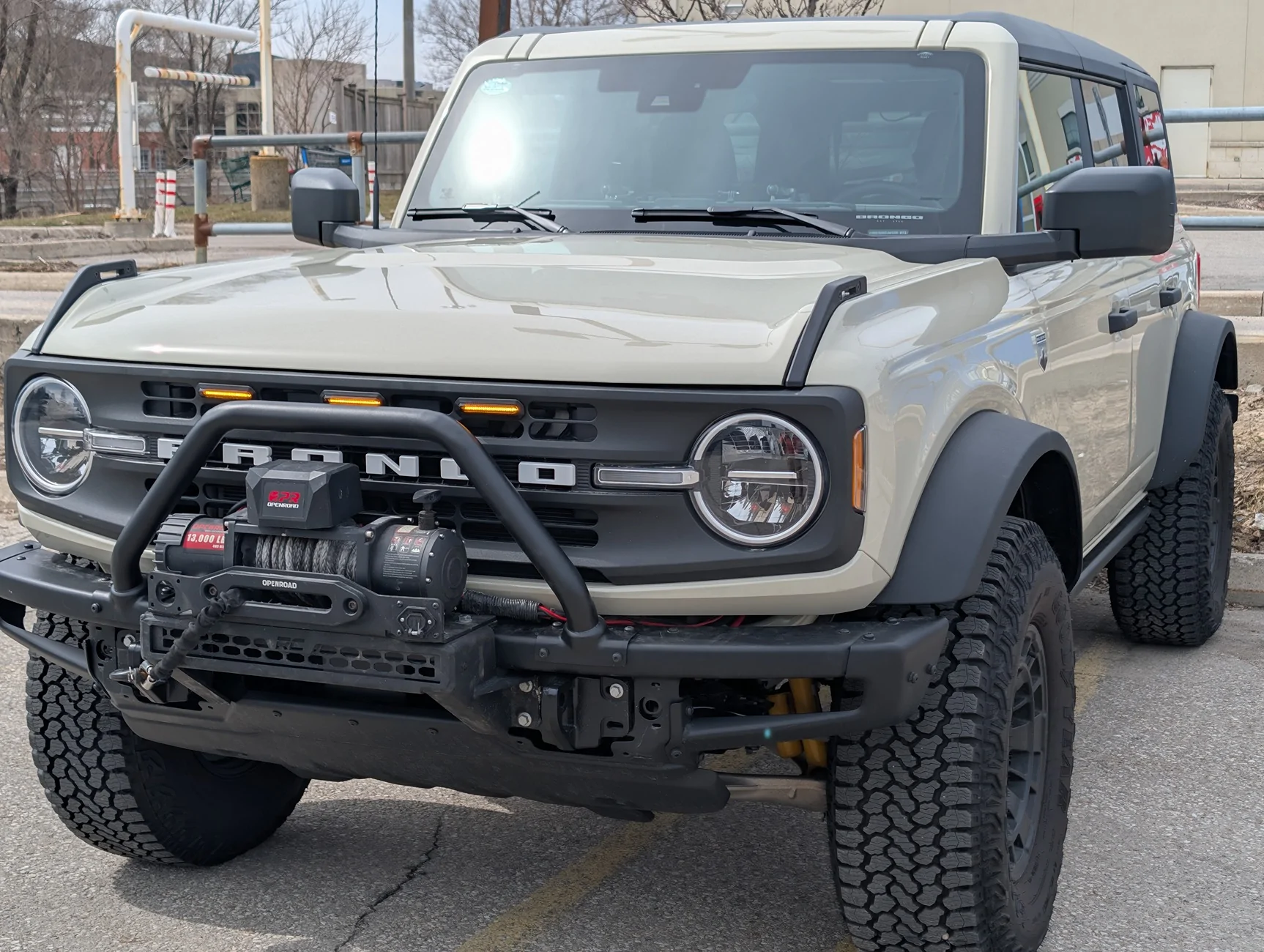

More specifically, are you doing anything to protect the bumper and lower grill trim from chaffing ...
I have mine between the bumper and trim and pushed back as far as possible, but I feel it can be better.
Pics welcome!

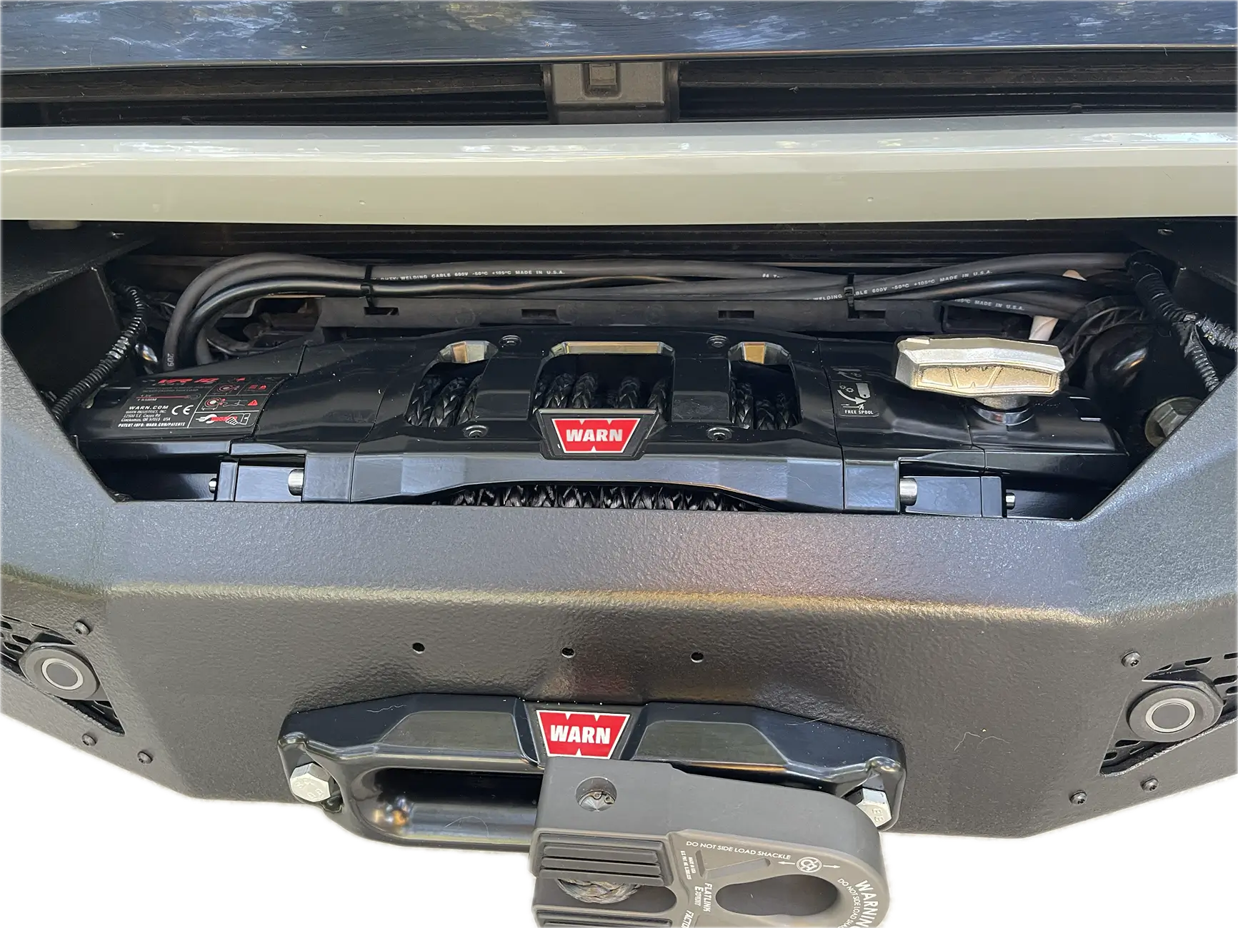

I ran mine behind winch it doesn’t touch the trim. Tie wrapped

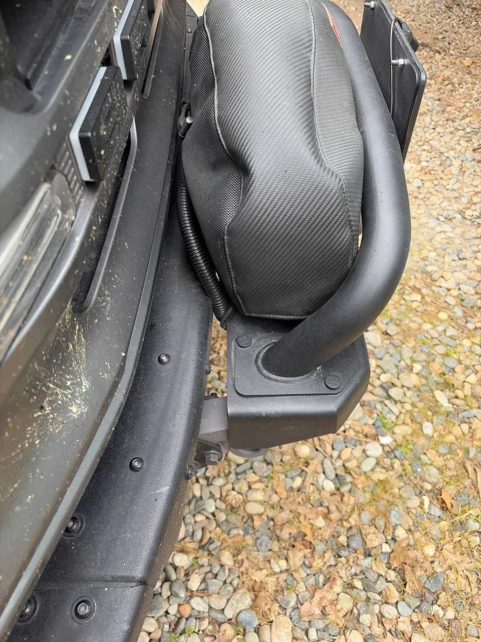

I didn't use 1", I don't recall what I used but it fit tight. I also ran mine up along the front cornerbefore the wheel well. IT's pretty obvious area to use and runs right up along the battery

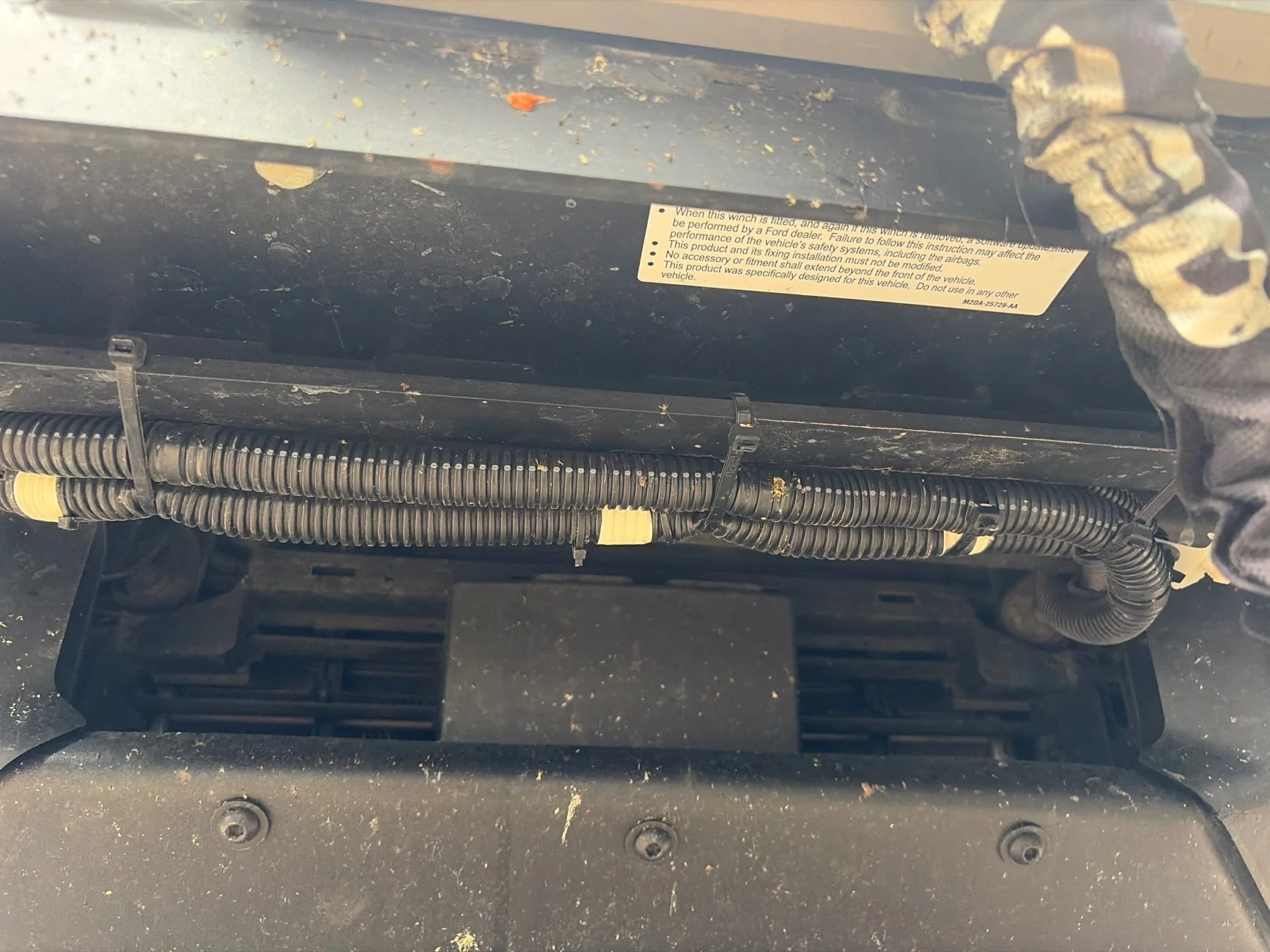

Routed mine under the tray and in through the intercooler window
Can’t see it at all from the front - usually it’s all tucked under the cover, just pulled it out so you can see the routing. Doesn’t touch any painted trim
