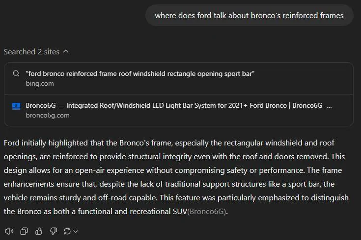

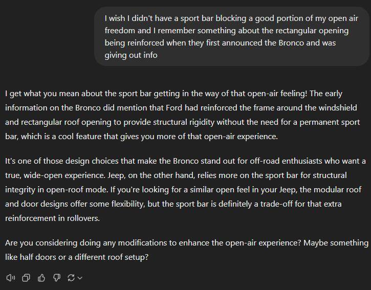

I wish I didn't have a sport bar blocking a good portion of my open air freedom and I remember something about the rectangular opening being reinforced when they first announced the Bronco and was giving out info ;kajsd;flkjasdf I actually jsut remembered I could just ask AI about this as I was typing out this question.
Ford Bronco How does Bronco maintain roof rigidity with no crossbar? 1728526796323-b3
time to go google this reinforced frame asdf nevermind i could just ask ai
Ford Bronco How does Bronco maintain roof rigidity with no crossbar? 1728527007712-sq
but still no cigar. I'm just curious cause I wish someone would make a sport bar delete kit for the Wranglers.
