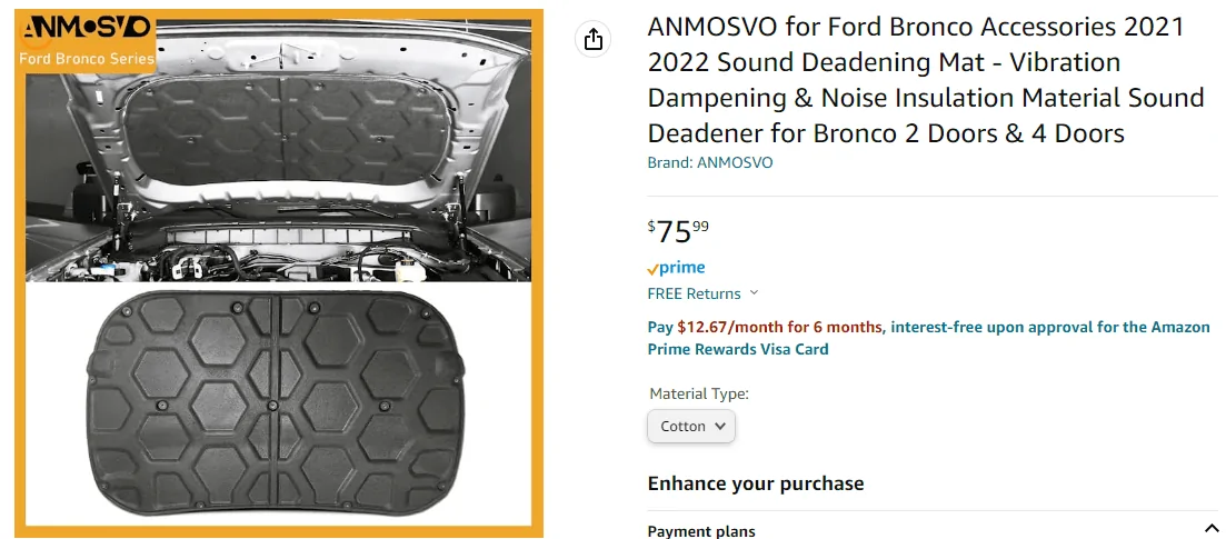

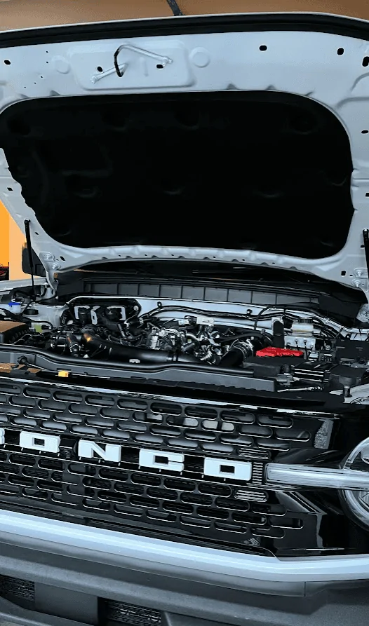

Mine is produced on 8/15. It came with the insulation material under the hood.
I sometimes cruise around 80mph and I never notice any hood vibration.
Ford Bronco Hood flutter above 65 MPH 1665142813225
I don't think the early Bronco came with the insulation though.
If not, you can get it from Amazon.
Ford Bronco Hood flutter above 65 MPH 1665142834895
It’s an option on certain trim levels, part of the additional sound proofing package.
I considered going that route but I don’t think it would have mattered. There was definitely something wrong with my factory hood. The new hood is 90% better. I only notice some slight fluttering if I’m actively looking for it and even then it’s really only above 80 mph. Plus the new hood sits flush with the fenders, the old one didn’t.
