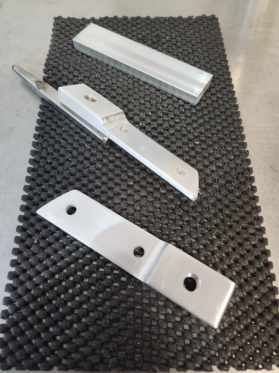

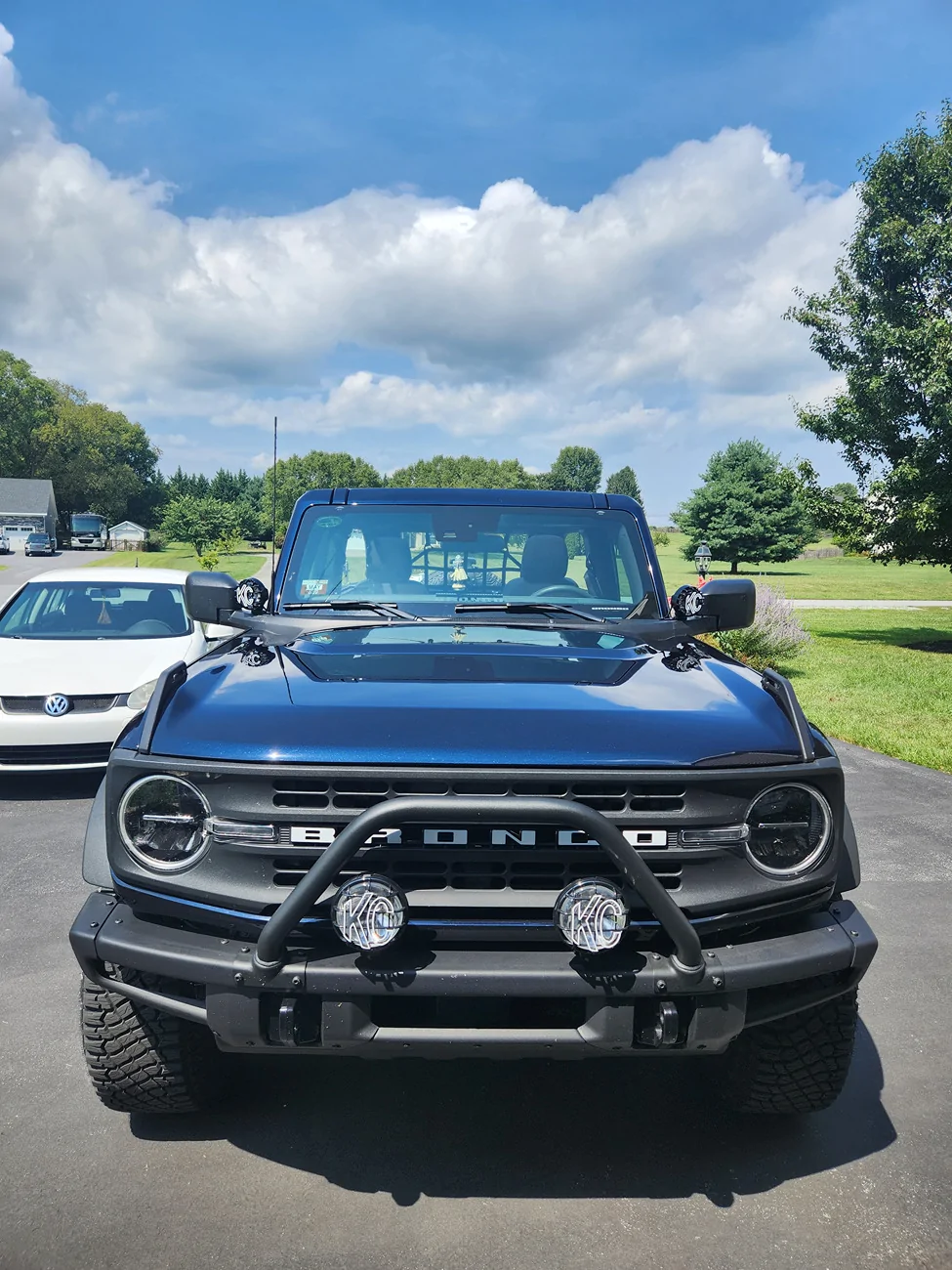

Decided to add some ditch lights to the Bronco. My original plan was to mount a pair of KC Rally 400's directly to the accessory mounting points in front of the A-pillars. Unfortunately, on the passenger side, the light ended up interfering with the antenna.
I started looking at some of the aftermarket ditch-light brackets, but decided to make my own for a few reasons.
First, I just couldn't justify spending $70–$90 for a couple of brackets. Sick of the Bronco Tax.
Second, I wasn't really crazy about the look of most of the ones I found. Most seem to mount to the two factory holes, then step up an inch or so with the mounting hardware underneath. Just my personal preference, but I thought they looked a little unfinished. And any time you have something sticking up into the airflow, it seems like another opportunity for wind noise or whistling.
Third, at the end of the day, I just enjoy making my own stuff and being able to design it exactly the way I want it to look.
So I came up with this quick design. I went to my local metal supplier and bought a piece of 1" wide x 3/8" thick aluminum flat bar. I bought 8" of material, it ended up costing me just over $8 out the door.
After cutting the ends to the shape I wanted, I split most of the width of the bar on the bandsaw, then cleaned up everything with some files and a Dremel. I drilled the two mounting holes and tapped a 3/8" hole for the light. I used some stainless hardware I already had laying around.

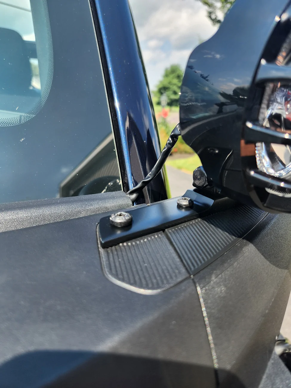

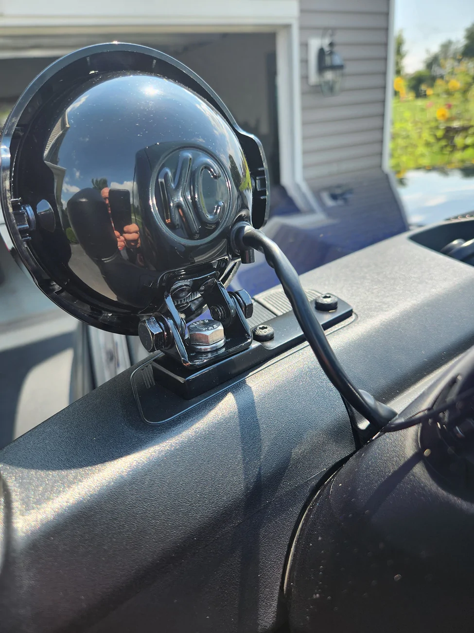

The end result is pretty much exactly what I was looking for: simple and clean, with no unnecessary hardware or brackets sticking up into the airflow.
The lights still retain full adjustability both up and down and left to right, so I didn't give up any functionality compared with a conventional bracket.
For now, I just painted the brackets. At some point I'll probably pull them off powder coat them, but for now the paint will do.
All in all, this was probably about a half-day project, and for roughly $8 in material, I think it was well worth the time. Just wanted to share in case anyone else is considering ditch lights and likes the idea of making their own brackets.

Black screws, c’mon!
The screws holding the brackets down are the stock Bronco Bolts. I really only changed the light mounting bolts because the black 3/8" bolts that came from KC were NF, since I was threading aluminum I went with NC's.

Those are very nice.
I would like to see a countersunk screw for attaching just to make a little cleaner looking than having the 2 heads sticking up.
I was going to do that, but the material thickness at the Bronco bolts is just over 1/8"... countersinking them was going to make it a little too thin.
If you want them flush, a nice SS allenhead CSK is probably the way to go.

Threaded directly into aluminum is a bad idea. The vibrations will cause the steel bolt to abrade the aluminum threads
Perhaps look into a longer light mounting bolt and add a jam nut on bottom.
