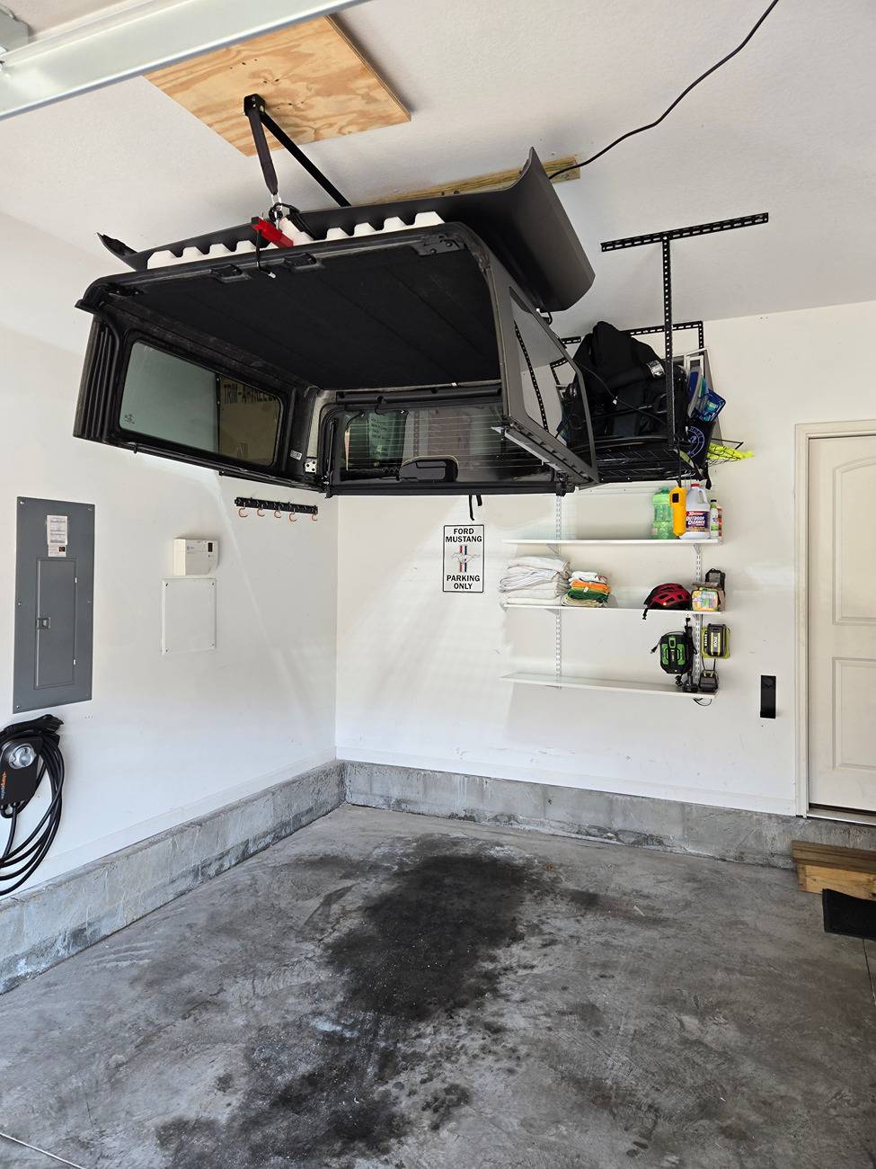

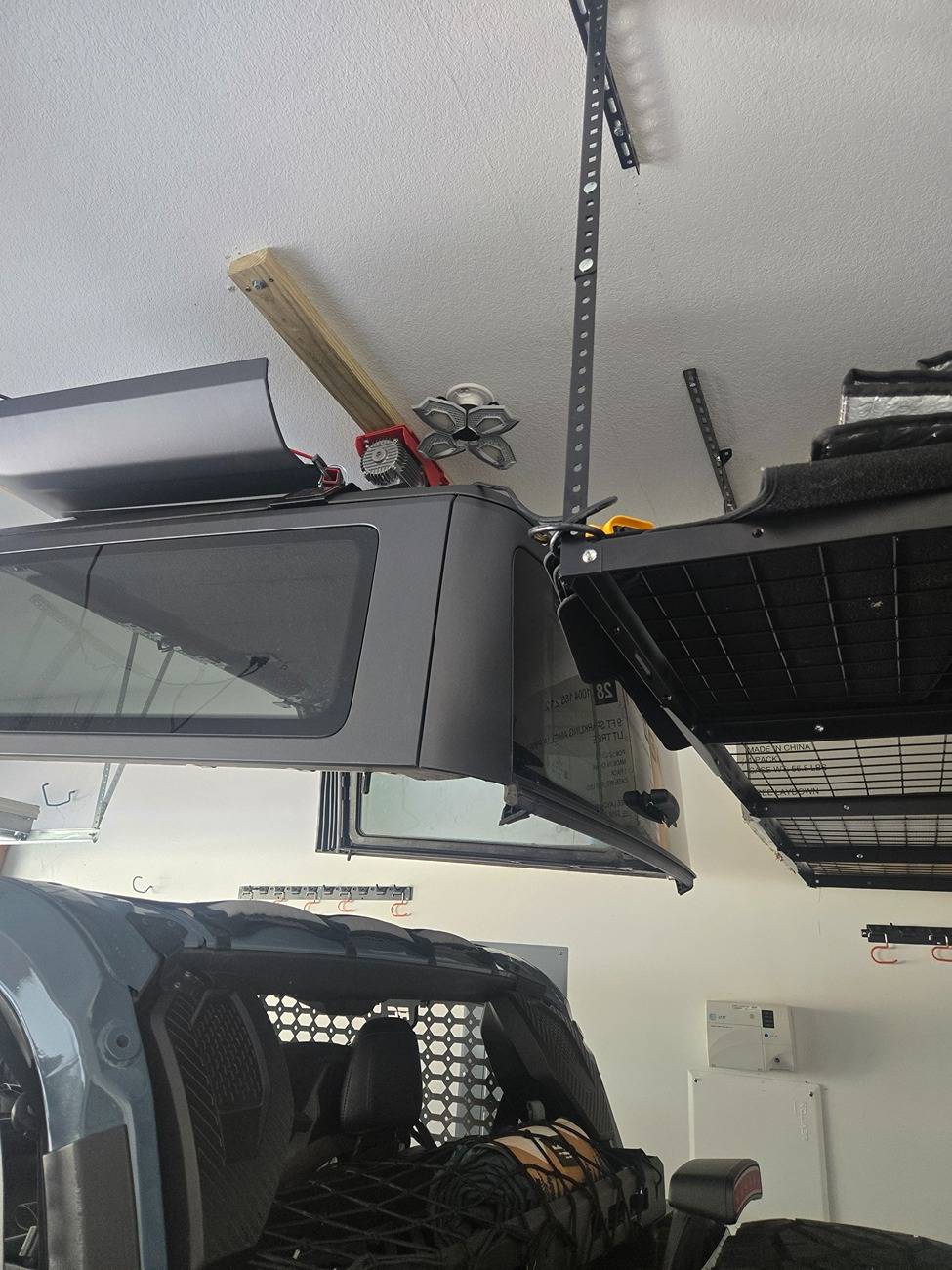

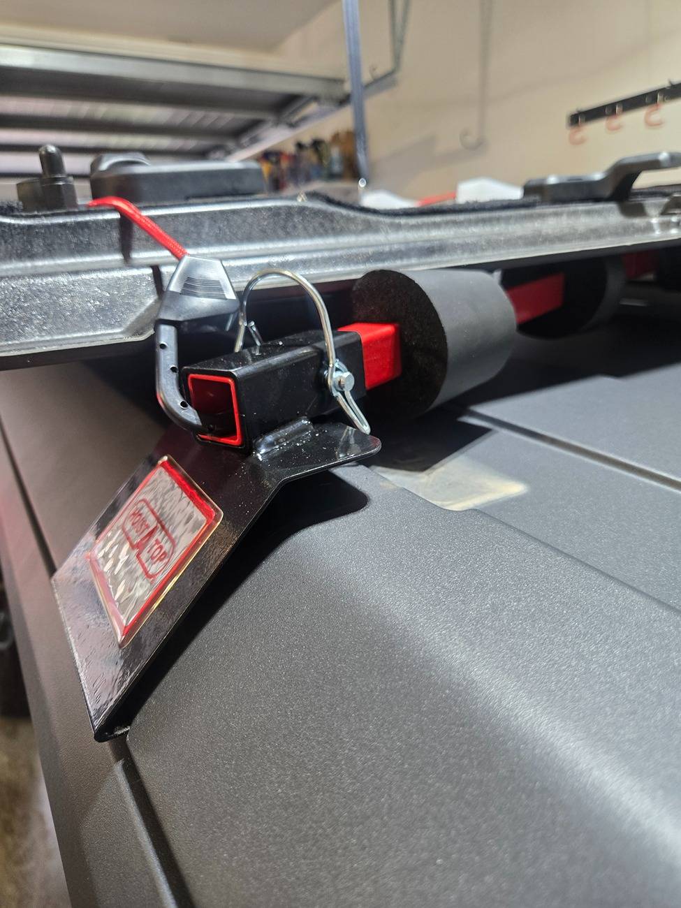

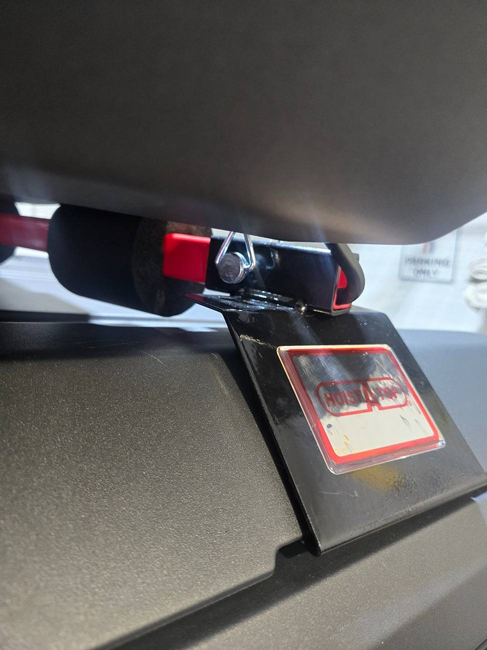

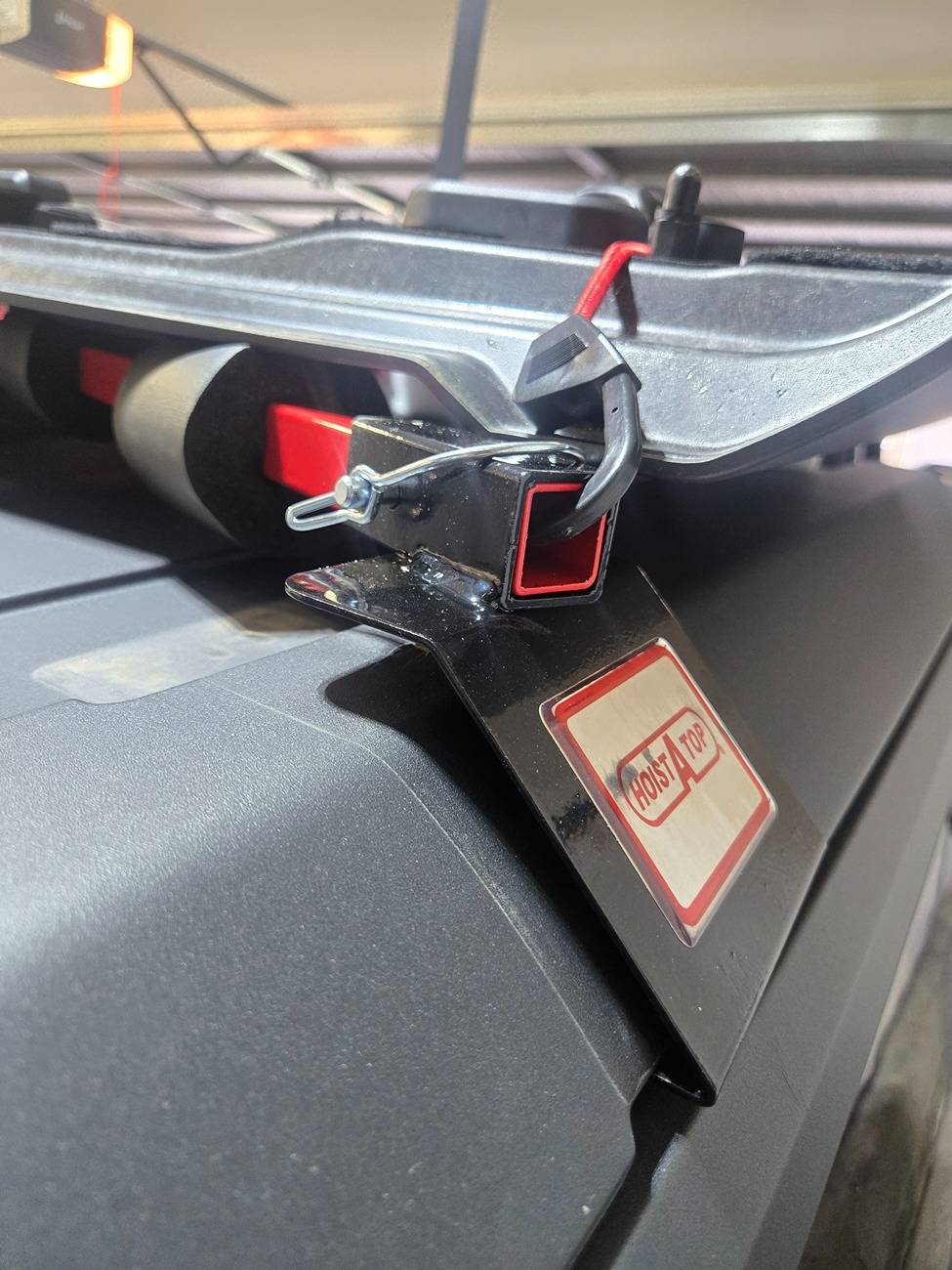

I didn't do a good job of posting how it's supported. Here are 3 pics. The lock pin secures the placement, once secured there really is no way for it to come off. There are two pin holes to choose from. I chose the one that puts the bracket in the farthest. I've attempted to pull the bracket back to see if it will pop out, couldn't do it. Seems pretty secure to me.

I like the your use of those Force/Stress Distributor Plates (plywood). I use similar designs all the time!

Instructions called to use the wood screws they supplied too. Which honestly would have been fine. The top isn't that heavy, even with the additional weight of T tops. But I put up a 2x6 and used lag bolts, then the 3/4 plywood, then the screws to the 2x6,with a few extra. Just wanted to make sure haha.

I'm curious about the minimum garage ceiling height. Mine is only 9'. Is that a limitation?

My garage ceiling is only 8 ft high and with my cheapo pulley setup I can get my roof up 4 inches. It's not much but it's enough that I can drive out from beneath it. Carefully!

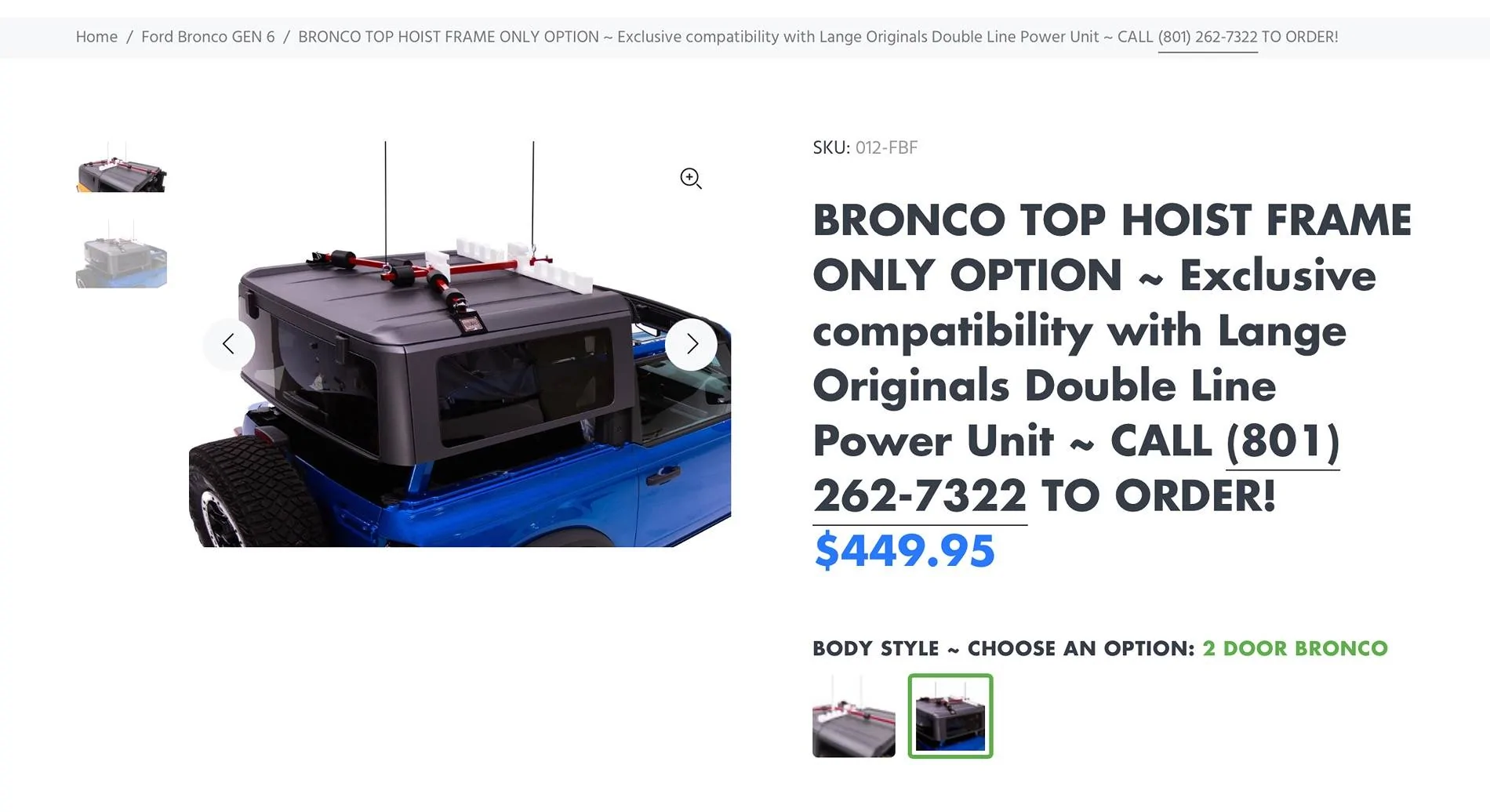

I already have a hoist. Anyone know if you can just buy the bracket (or maybe someone else sells just a bracket?)
disclaimer: I haven’t used this, I still use straps and hooks
BigFootie
Oct 25, 2020
4,538
11,269
Wisconsin
Lange sells just the bracket.

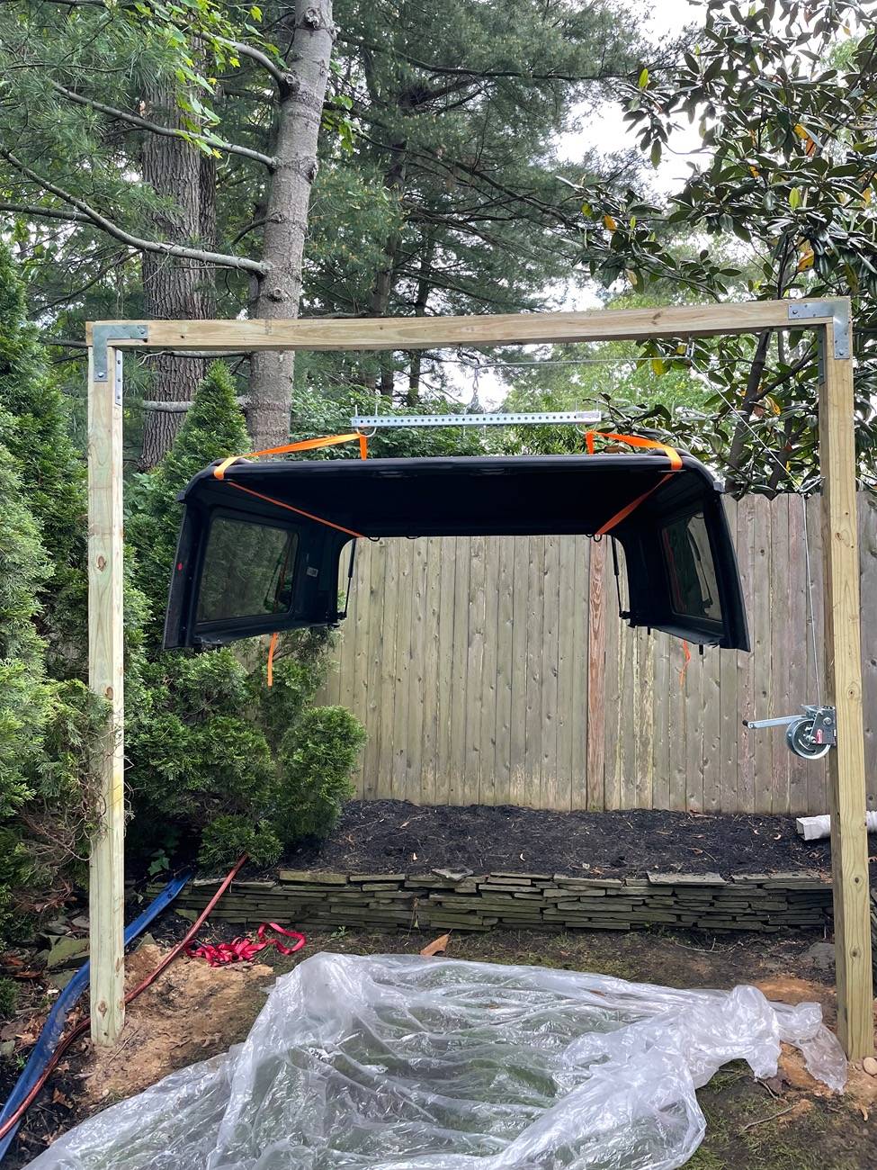

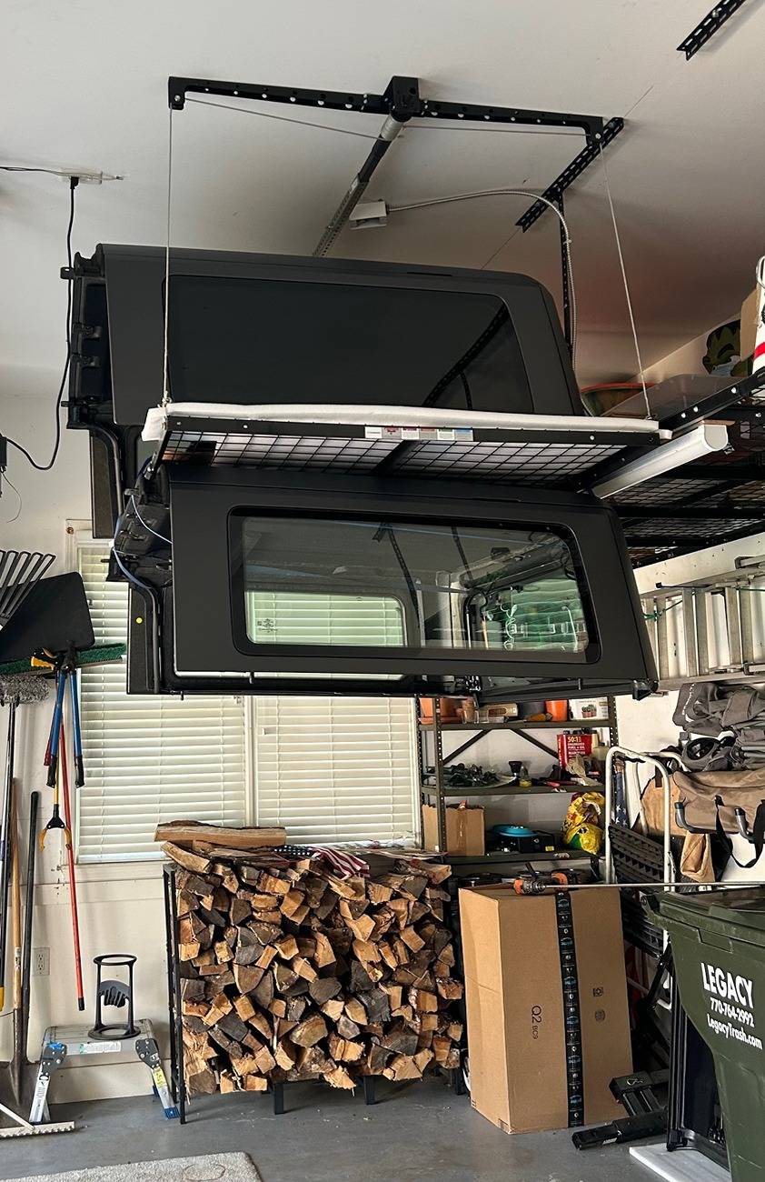

Here is my setup. A little overkill but it works

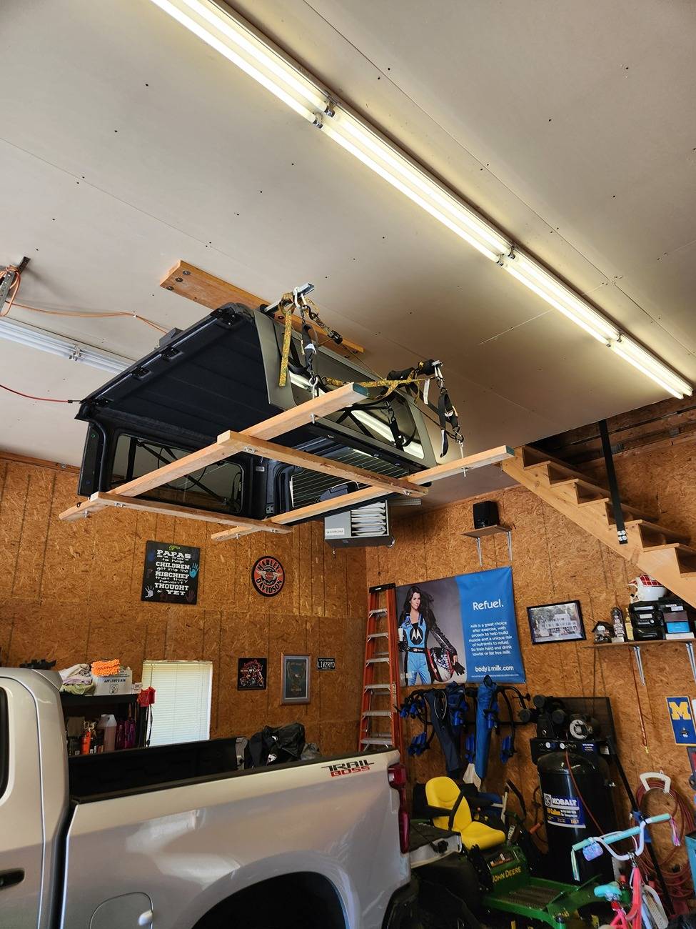

I can store both mine and my son's two door hardtops on my home made lift.

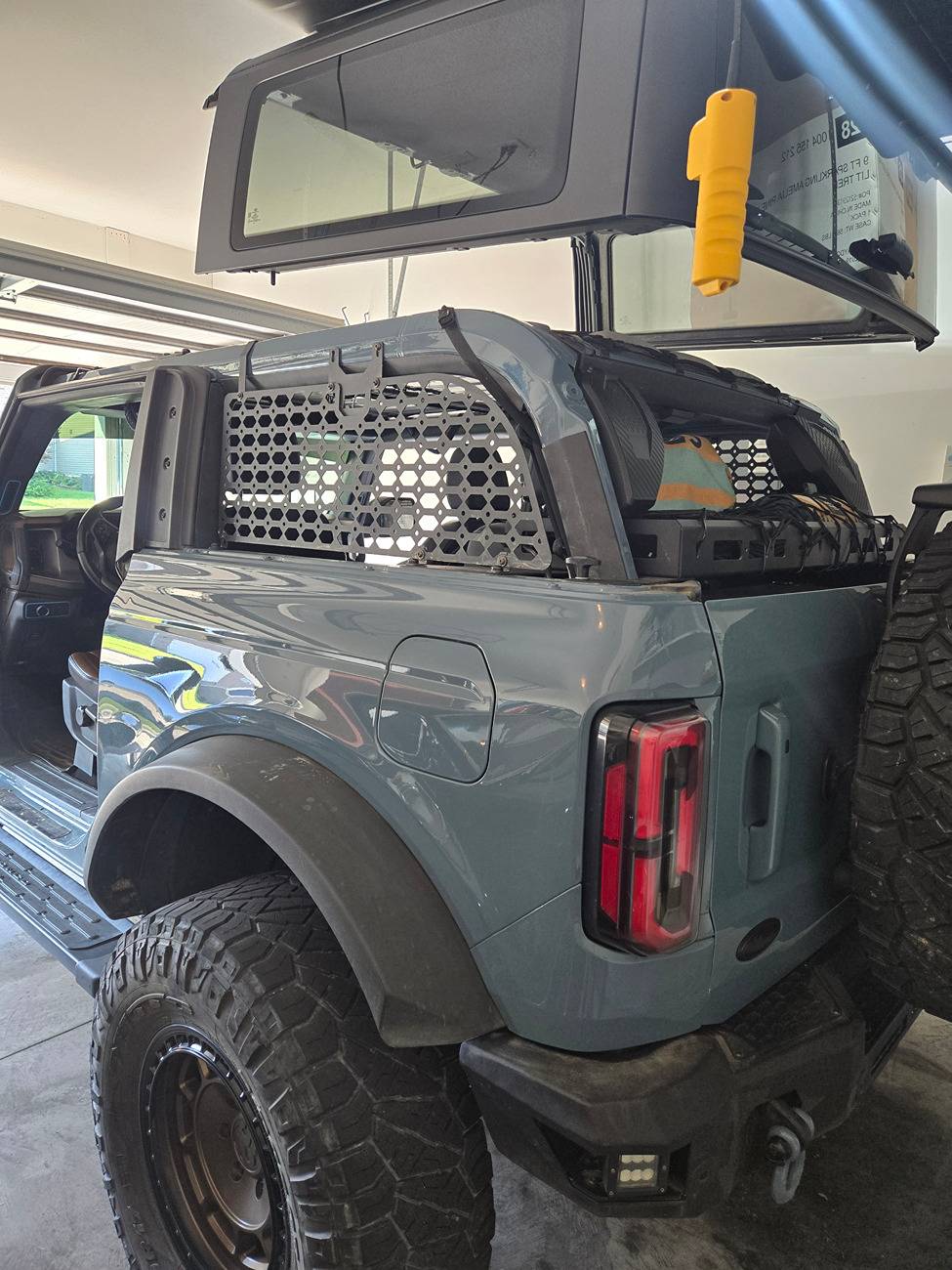

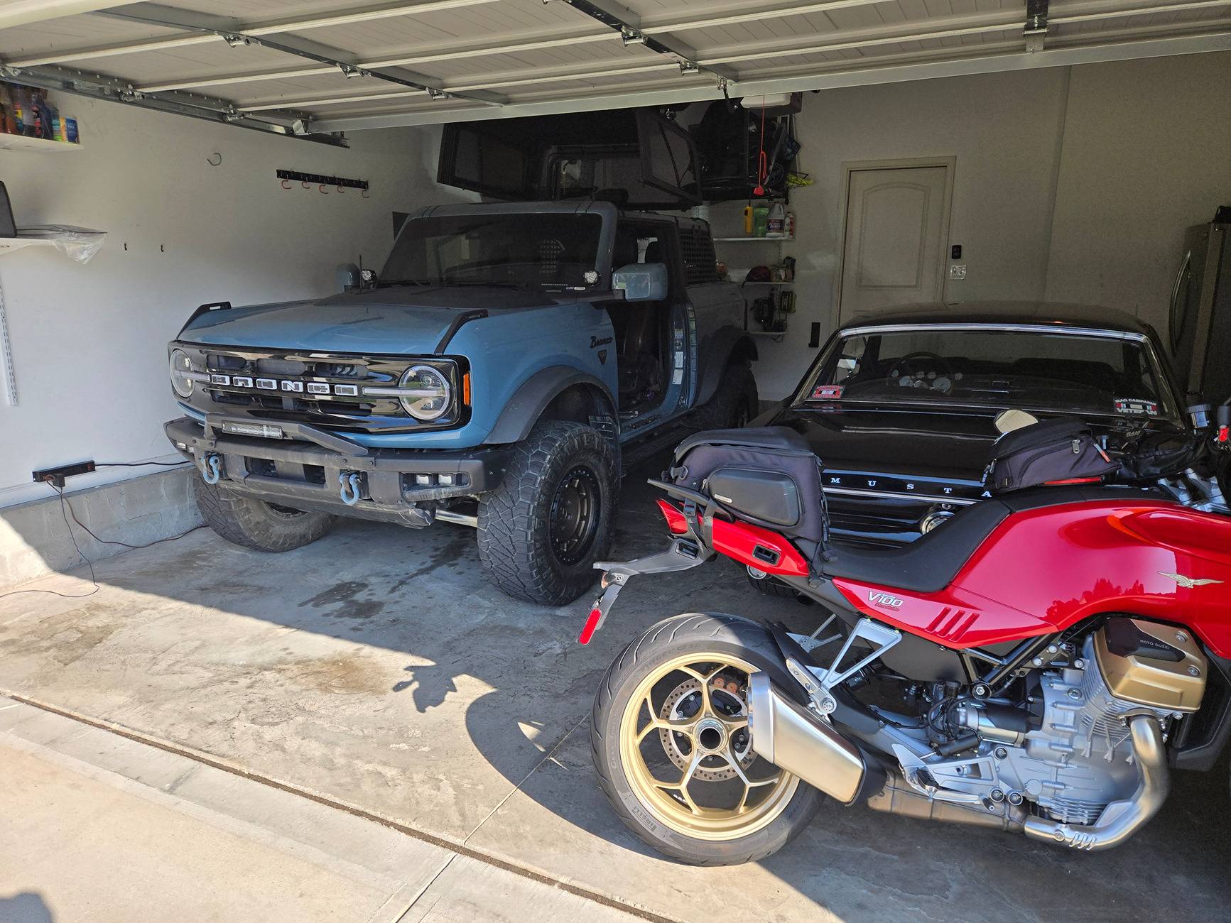

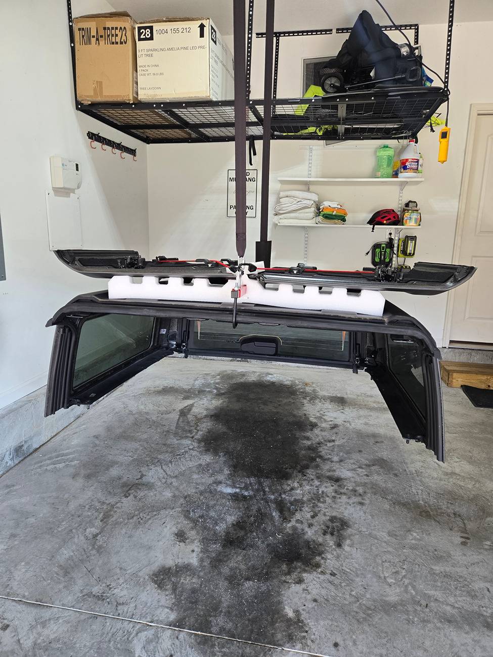

My roof is 10'. The top silver bolt in this pic is 9'. You'll make it, but will have to either pull in front first and have plenty of room. Or carefully back up and parking under the top like you are putting it back on.
Or maybe even the garage is long enough and you can park before the top. Obviously I have a two door, but that side of my garage is 1' deeper than the other. I can actually park in the garage and close the door. And still be able to lower the top behind the Bronco as long as I'm inches from the garage door.

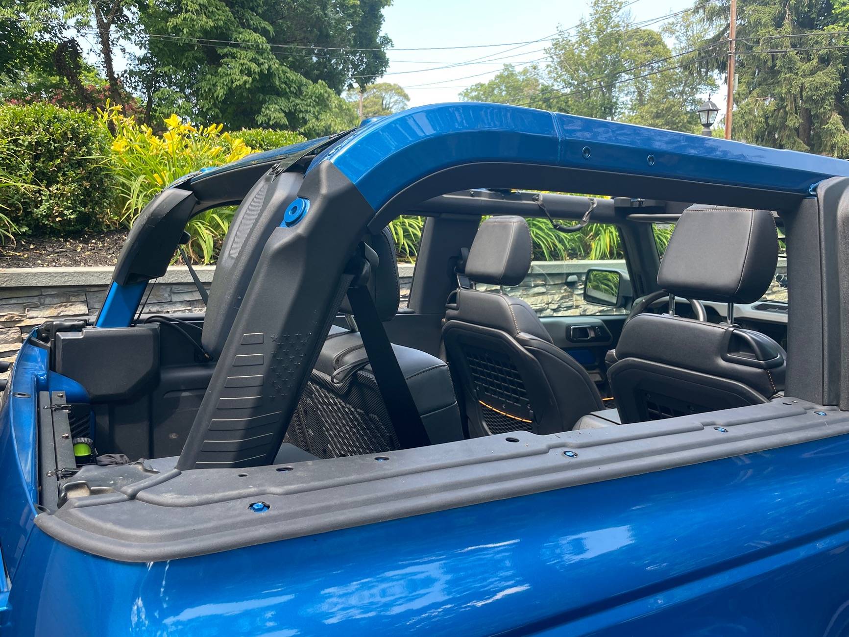

My cellar level garage ceilings too low for a hoist so I built one on side of garage but the ground isn’t that level so was a PITA getting it on without banging the roll bars and breaking alignment pins. I ended Up just going with the Toplift and I can get the top off and away in garage in 10 min. It’s easier than messing with hooks and straps.
Either way, i really recommend roll bar and ledge protection. I got from Stickerfab.
