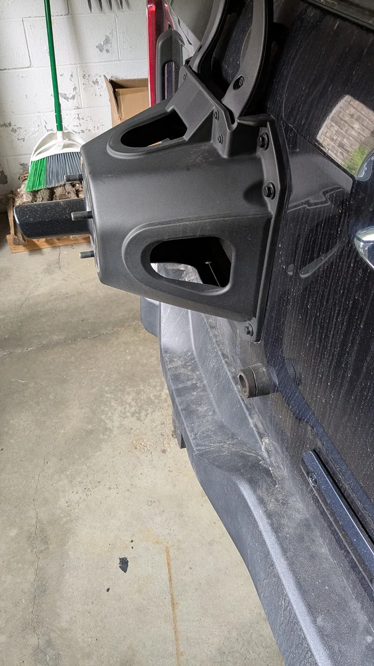

I don't think that helps much on stock setups because of how the spare carrier and reverse camera stick out

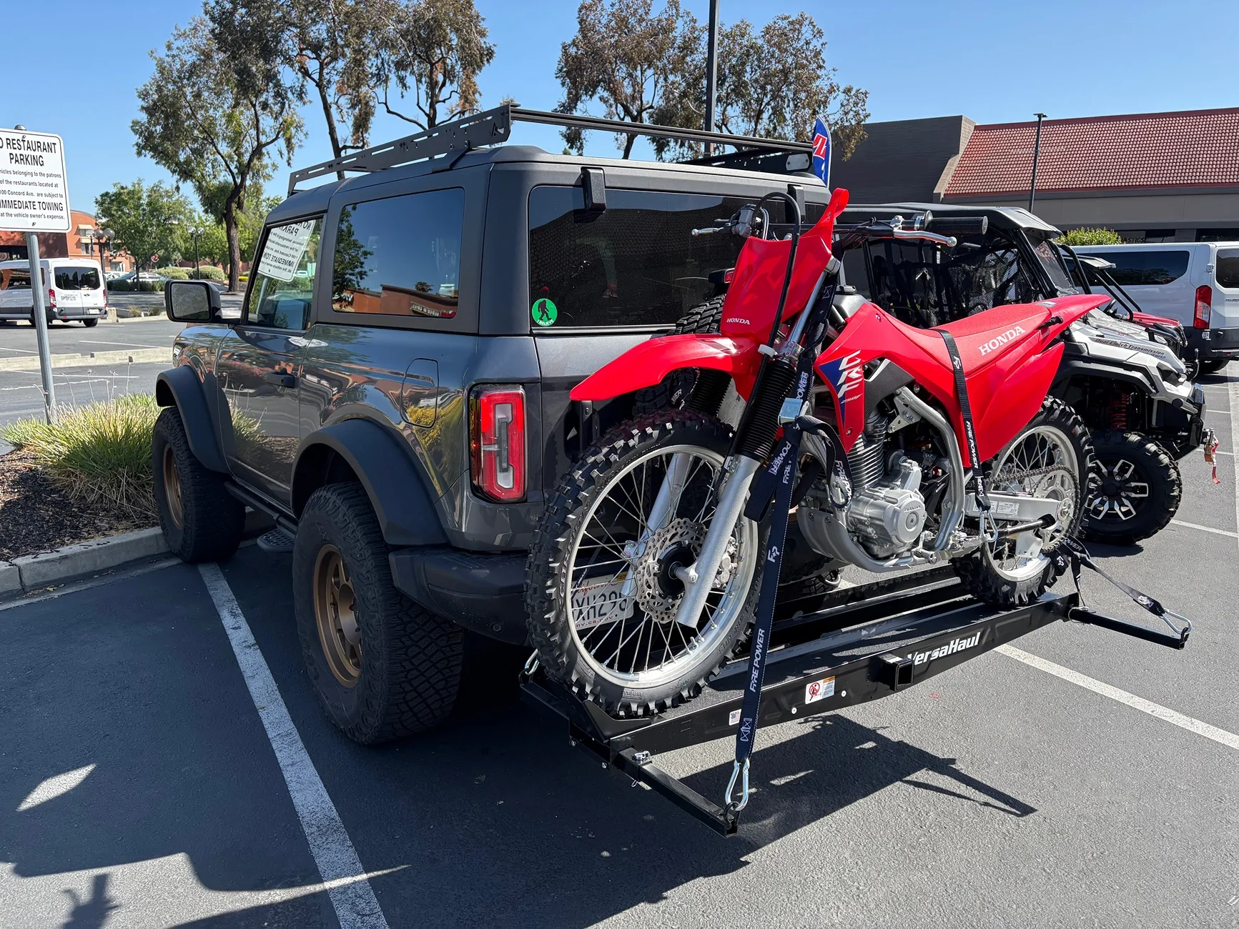

I've been using the Versahaul VH-55 after reading other threads in this forum. I have used it for probably at least 6 trips for anywhere between 1-4 hours from home. It lightens the front end of the truck so steering feels a little different but hasn't been a problem. I was worried I would need the extension, but it fits just fine without it AND with the spare tire in place.
