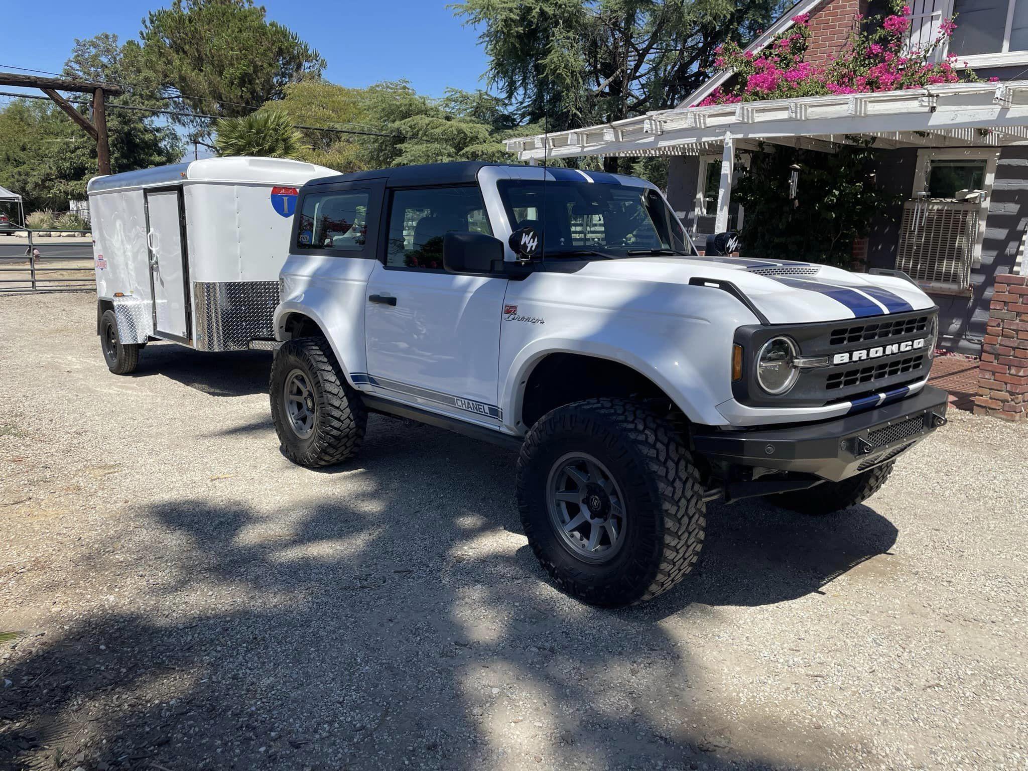

I have an extended ball mount for towing my small enclosed trailer. It works better than a hitch extender because there's less slop with having only one slip-fit joint instead of two. I have the 15-3/4" one from eTrailer and it's the perfect length for placing the ball just past the spare tire enough to easily hitch the trailer (12.50 wide tire on a 0mm offset wheel). Get a Hitch Tightener too to take out the remaining slop.
This doesn't solve for bike racks and gear baskets. For those you can get a hitch extender. They're not that expensive. It's worth it to use the right gear for towing, which is a longer ball mount, and a hitch/receiver extender for racks and baskets.

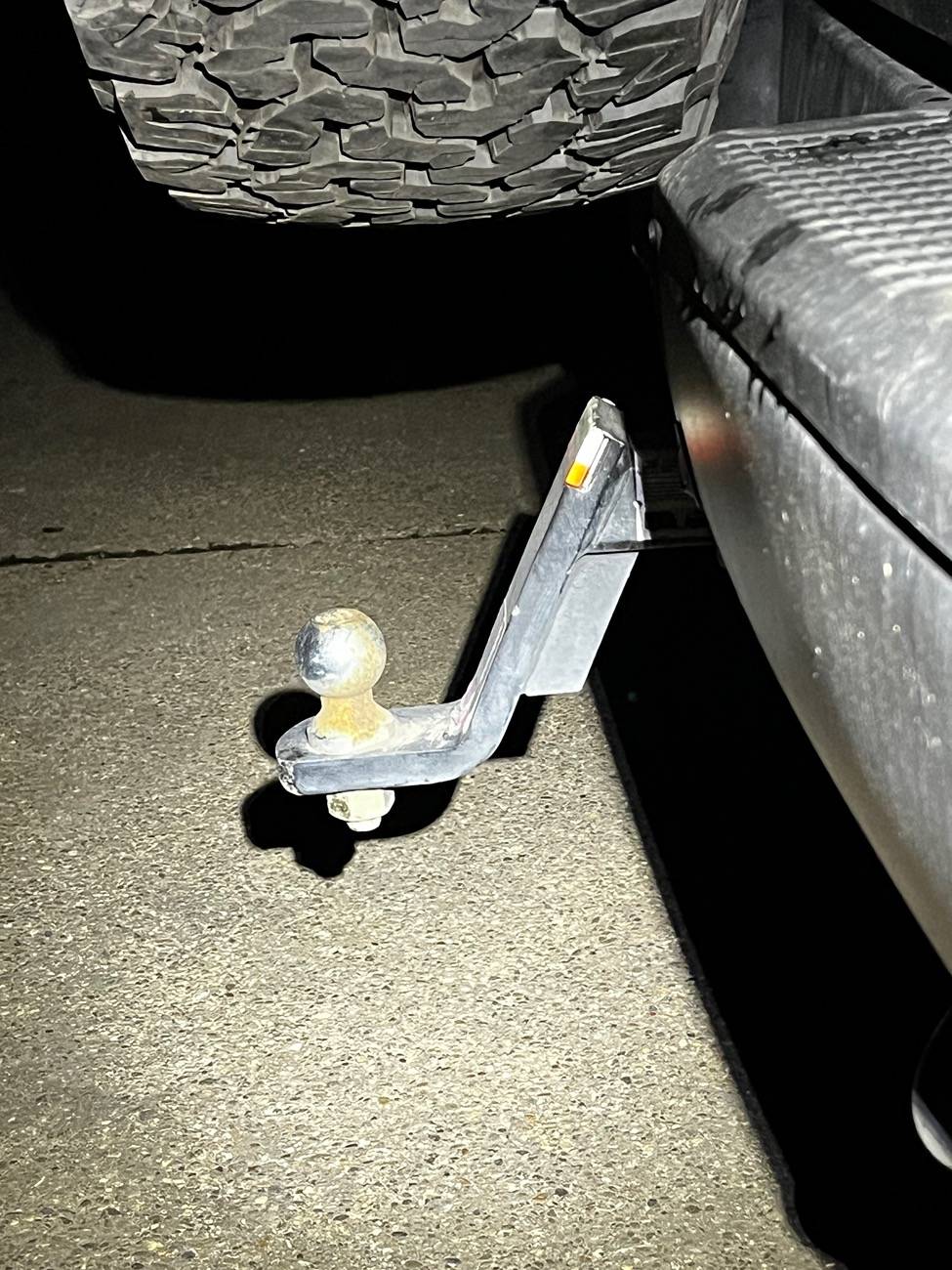

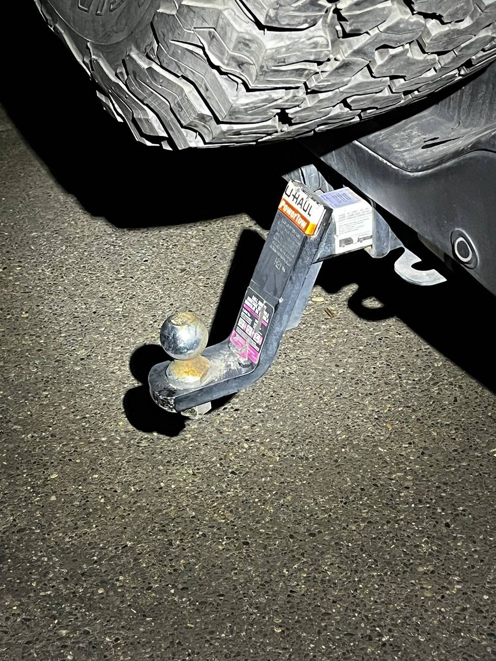

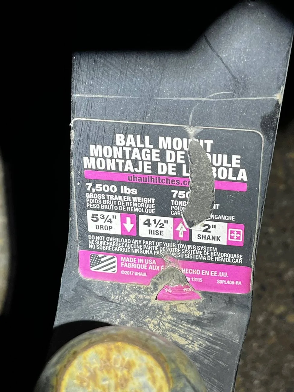

Very old thread. But here is the extended ball hitch I used on my BL with stock tires. Bought it from U-Haul and it has done fine towing boats.
You can see the specs on the hitch on the last picture. More than enough for the towing capacity of the Bronco

That's a drop hitch though, not an extended hitch.
