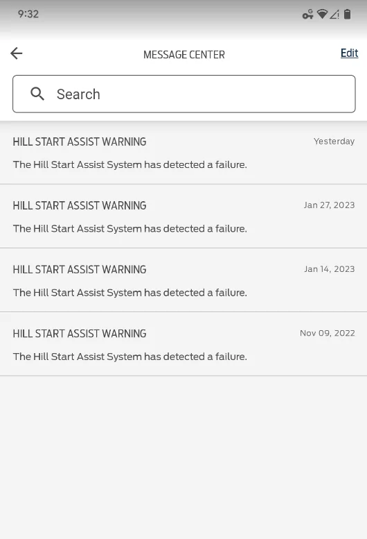

I'm surprised none of the dealers found a root cause yet and there is no TSB for this either.
Mine happens when I'm parked with engine off. After some clicks and clunks from the front driver foot well area, the error tends to come up.
There were dash error messages and phone alerts, but of course none of the codes were stored in the car.
Ford Bronco Hill start assist failure 1675866957844
I then messaged Ford account back on the forum, but the actual support person from Ford is far from helpful. Said case closed since my car is not currently in the dealer for repair... I mean what the heck.. then why bother to reach out.
