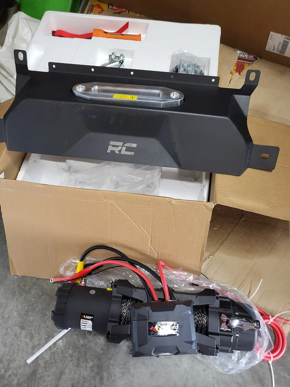

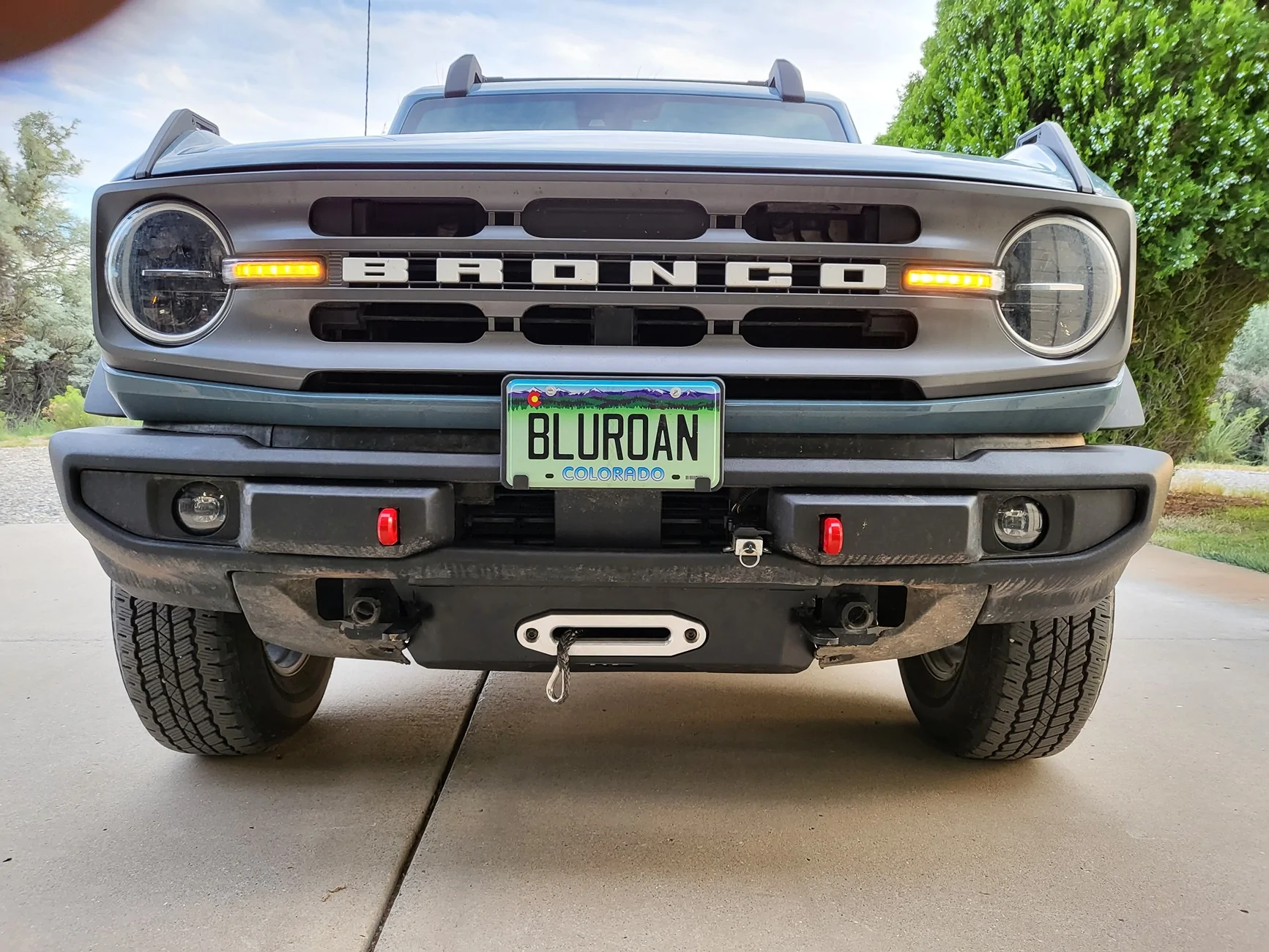

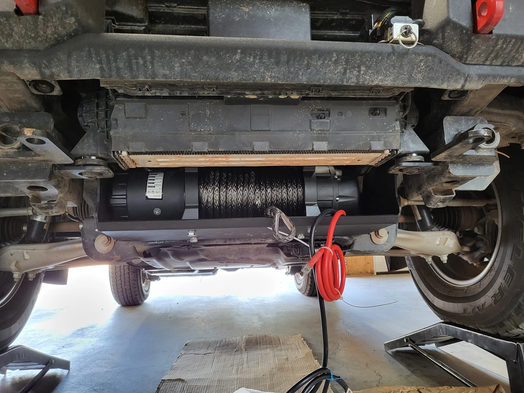

I have the RC. Very happy with it. Easy install once I mentally accepted cutting off the frame extensions which was easy too. I was pleased with the engineering and construction. I used a Rugged Ridge 9000, no relocation. Built a tool to operate the clutch. Full disclosure: I've never used it, but good piece of mind.

I just used my little floor jack
