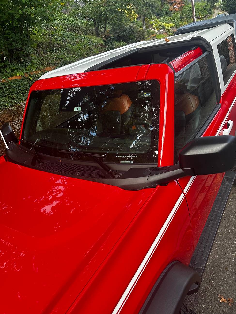

Hi everyone
I need to replace the driver’s side roof panel on my 2024 2-door heritage edition bronco.
The replacement part is M2DZ-9850285-SAPTM , which would be over $3k with shipping, and would still need to be painted white to match the other roof panels.
A number of sites also have M2DZ-9850285-AA listed as a replacement for the 2024 2door bronco heritage edition like https://ford.oempartsonline.com/oem-parts/ford-rail-assembly-roof-side-m2dz9850285aa
For around $1k with shipping. I understand this would also need to be painted, but significantly cheaper.
I haven’t been able to get confirmation from ford or anywhere on what the difference is between the two.
Can anyone here confirm that m2dz9850285aa does, indeed, fit a 2024 2dr heritage edition ? Or is there something else I should be looking at? I want it to be the hardtop panel, not looking for suggestions for soft tops or anything else.
Getting desperate at this point after a few rainy days here in Seattle, but not desperate enough yet to shell out ~$4k on the replacement. Thank you for any suggestions or confirmation on parts!

For future reference, there's allot of HE specific part numbers on the Heritage wiki, mostly due to diligent work from @Ducati1098
https://www.bronco6g.com/forum/threads/he-heritage-edition-wiki.91504/post-2205412
You do know that we now need the story of why you need one right? Did it fly off or did you drop it?
Thank you for replying.
@Ducati1098 doing the Lord’s work- thank you for that.

M2DZ-9850285-SAPTM is the correct part number.
M2DZ-9850285-AA is for the MIC top, not MOD top.
Do you happen to know what the PASSENGER PANEL and the POSTERIOR/BACK PANELS part numbers would be? Would they be compatible with a 2DR 2024 Wildtrak?
Ducati1098
10,067
23,469
Midwest
I’m guessing your asking for Mod top numbers?
Clamshell: M2DZ-98502G33-SAPTM
Passenger top panel: M2DZ-9850284-SAPTM
And yes it’ll fit any 2 door bronco.
