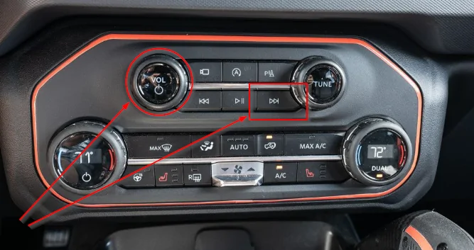

This past week while driving and listening to the radio/Sirus XM the music would stop playing and the screen will change to the main menu; I would again select Sirus or the radio, and it would play for 5 min then quit again...
Any Ideas to have this stop?

I have found that resetting the Unit alleviates this issue. You can either stop, shut off the Bronco and open the door to reset, or - the MUCH easier option - is to hold the Power and FF buttons on the dash (above the AC controls) for 3-5 seconds and the unit will reboot.
