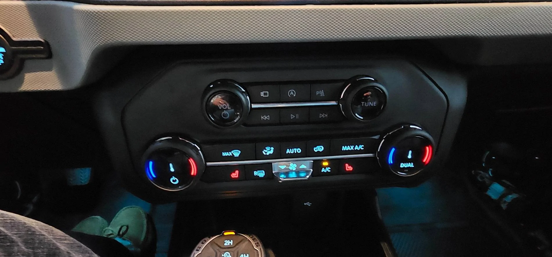

I recently installed some new sound system equipment. As part of the process I had to pull the center stack of controls unplug the 3 plugs and install the new audio harness. Removing the center stack and plugs was actually one of the more difficult tasks,
For me anyways, that and removing dash speaker covers.
After putting it back together heat/AC/heated seats all work fine but there is no power to the radio/camera/start-stop buttons. Everything is plugged in, (double checked). I tried the 2 differen reset methods, checked the fuse (good), haven't tried disconnecting battery. It just doesn't seem to be getting any juice.
Any ideas??

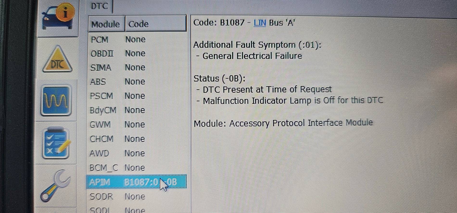

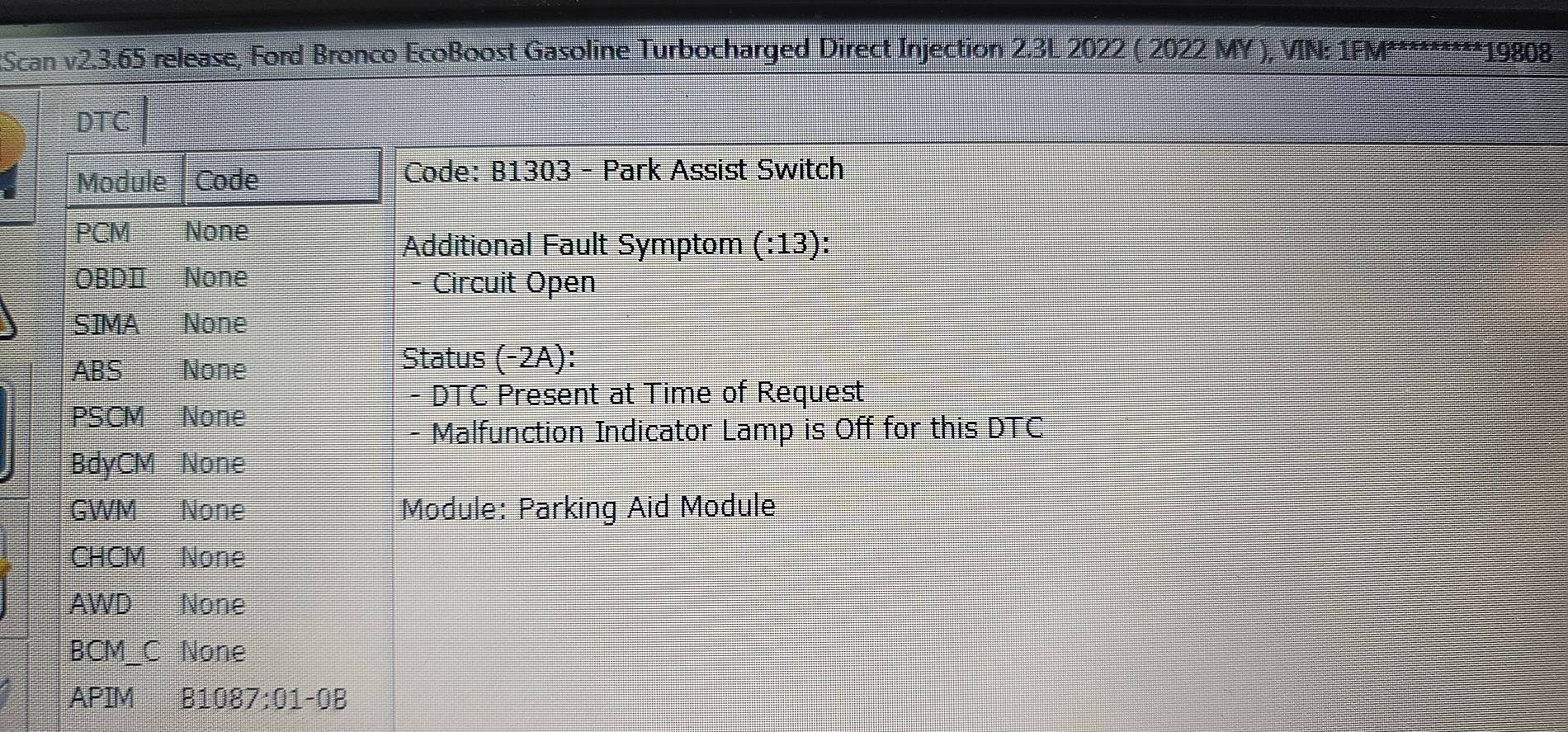

While I was getting rid of the super loud dings and dongs (after amp install, they're pretty aggressive) I went ahead and checked a couple codes that popped up...
Ford Bronco Need help troubleshooting: Center radio controls 1000015483
Ford Bronco Need help troubleshooting: Center radio controls 1000015482
I don't really understand the tech part of this whole thing, but my guess is like I thought, the cluster of controls for sound and camera aren't getting any power. Any advice on what these codes may mean would be great. Thanks.
