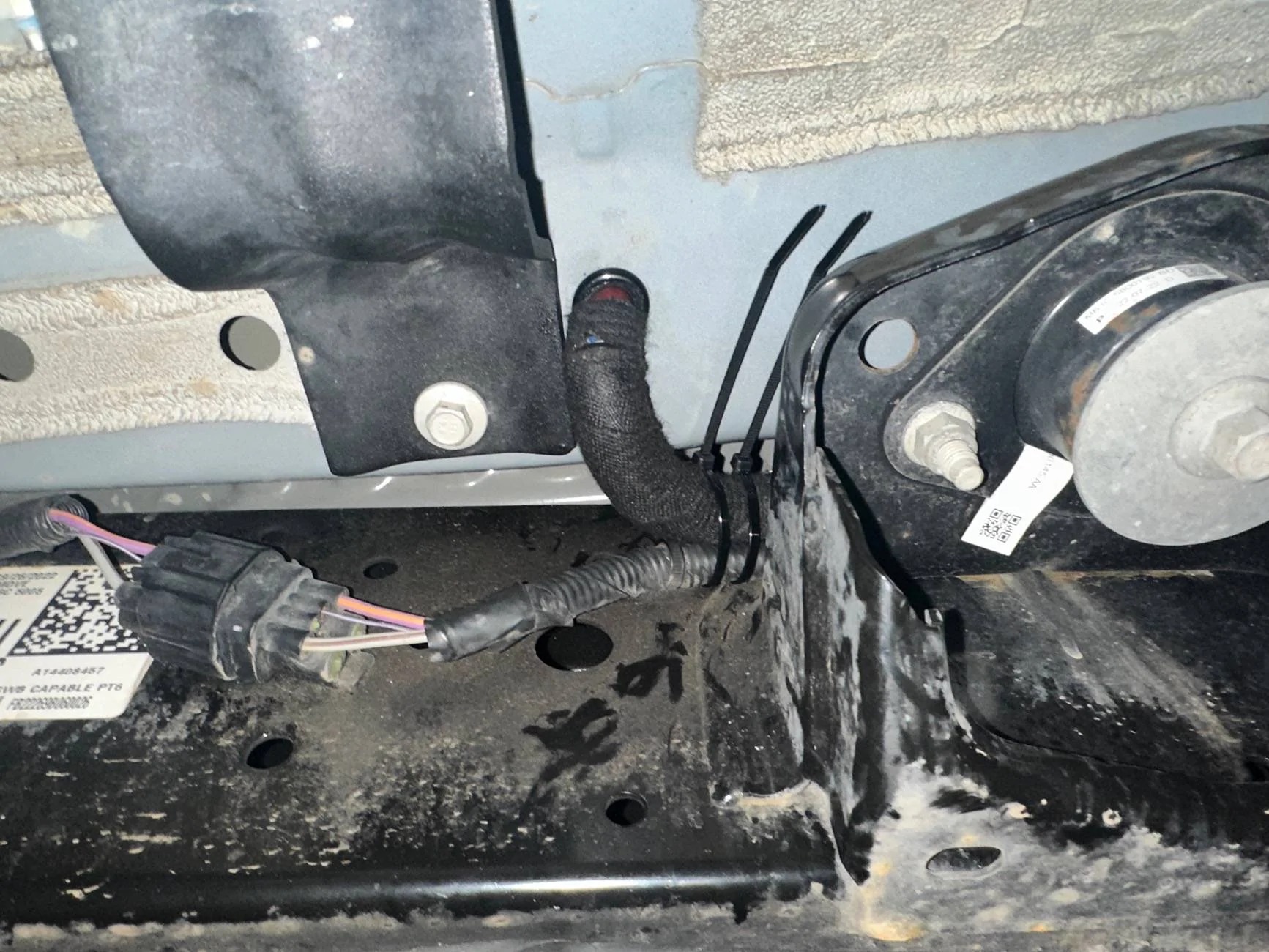

Alright, I ordered a drill bit and grommet. Can anyone recommend an exact spot I should drill? Would be great to get practical advice or pics from someone who has actually done this before. Thanks
Here is a picture of my cable coming from the engine compartment and inside the fender and going into the forwardmost drain hole in the cab. There was a plastic contraption there that was easy to remove.

I guess it being a "passive" drain makes sense. It wasn't under the floor mat they they show in the washout videos. Couldn't get a great picture at the firewall. The cable just rides over the inner fender liner and goes below the brake booster.

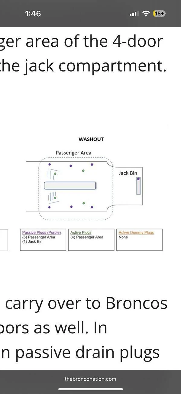

Those drain holes behind the driver seat (and another behind the passenger seat) are really useful. There are also several other grommets in the firewall as well. there is one just above the clutch grommet (much smaller but easily will fit a 0 gage) and there is another on the passenger side almost identical to the clutch pass-through...

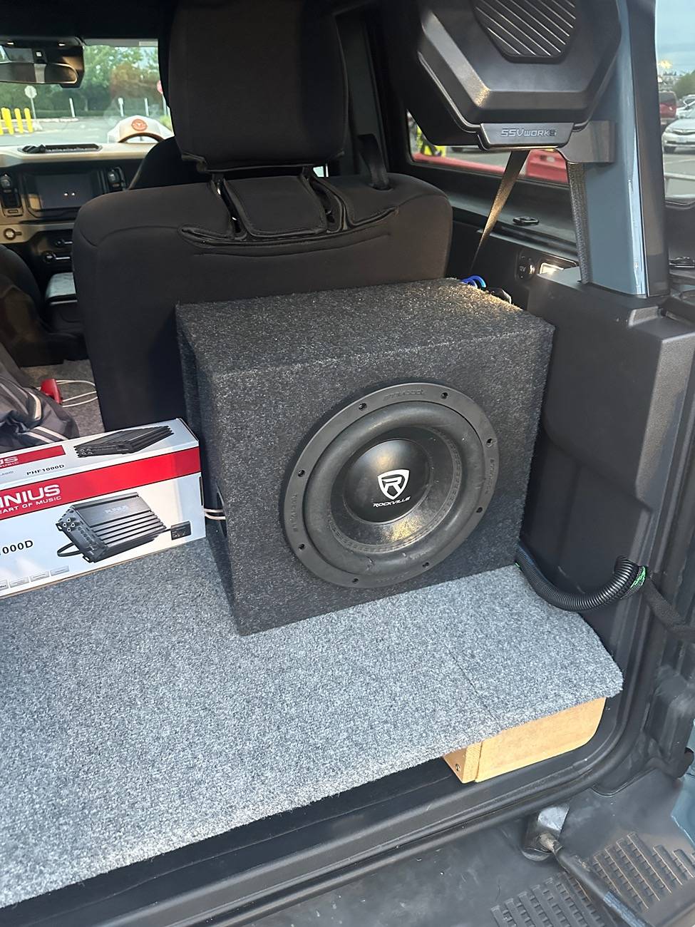

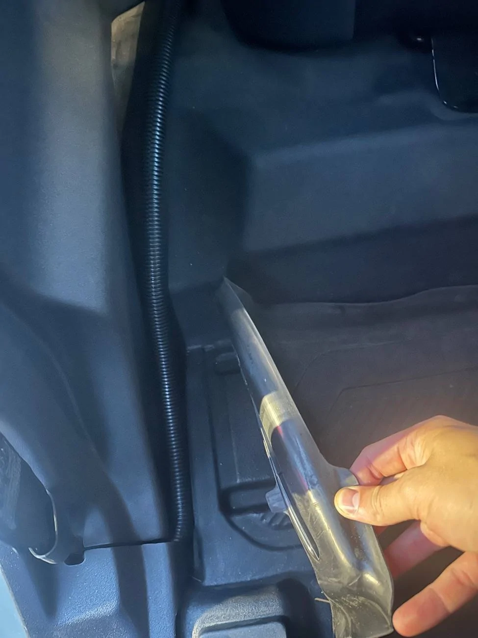

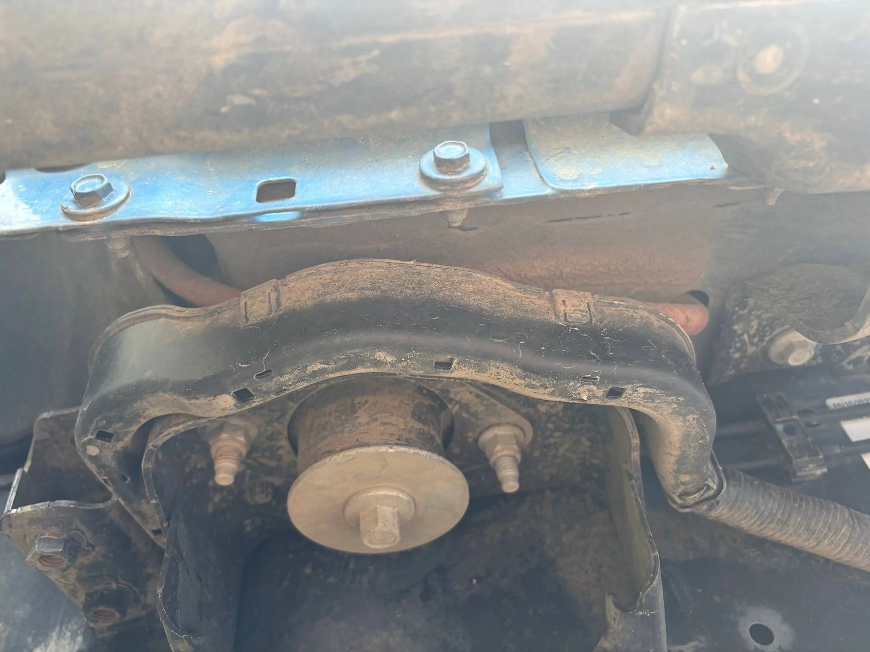

Just finished the install. Thanks for suggestions . No drilling. Very easy. I ran the 1/0 wire across the front of the engine along top of the radiator fans, down behind the coolant reservoir, down the passenger wheelwell, then along the frame, and up through the “passive” drain hole right next to the frame body mount. The drain plug popped out easily by pushing it out from underside. The drain hole lines up perfectly with the door trim wiring. You really can’t tell it is under the mat. Glad I ordered 20ft of wire, it barely made it.. wish I ordered 25ft. Tapped into the rear speaker pod and ran a kicker loc2. I also used for-scan to fix bass roll-off. Overall, works great.
