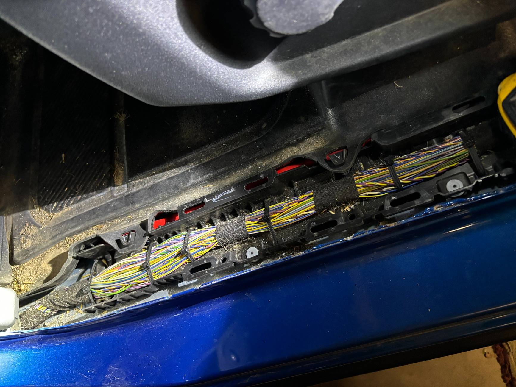

I also have a manual and I was able to run my cable into the inner fender and down below the cab. From there I removed a drain plug and went back up into the cab and ran it to the rear right next to the cable tray. I don't have a great picture of where it entered the cab, sorry.

Interesting. I’ll think about this approach. Does the wire create a large lump? Under the washout interior?

Not at all. I don't even know it's there.
