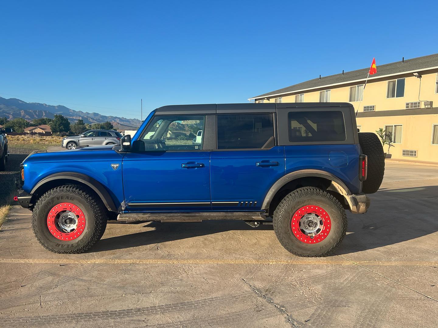

Over 4 years with my Trail Ready beadlocks, double valve stems (monster and regular), zero issues, daily driven, Seattle to Hurricane Utah twice, Seattle to Moab/Grand Junction. Never an issue. I did purchase a digital 1/4" drive .5 to 50foot lb torque wrench and painstakingly made sure that all the bolts where tightened in pattern/steps/torque.
I took the stock wheels to Discount Tire, had them break the beads, put the stock tires on my beadlocks and then I took them back to Discount to balance them. No one but an off road shop would mount them, but Discount/Les Schwab didn't blink an eye at balancing. I will likely get a bead breaker when I replace the tires soon. Two fat guys jumping up and down didn't work when I tried previously.
