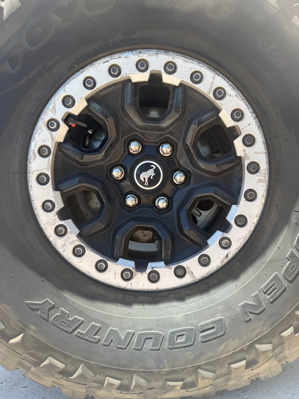

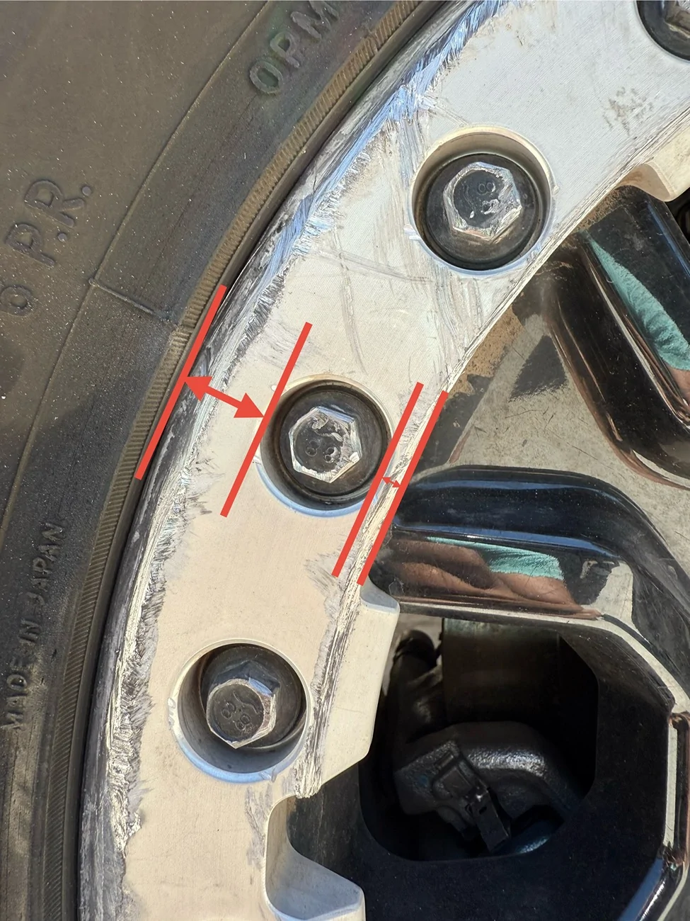

Excuse the curb rash from Starbucks, but here’s the easy way to tell. Please don’t share with the rozzers

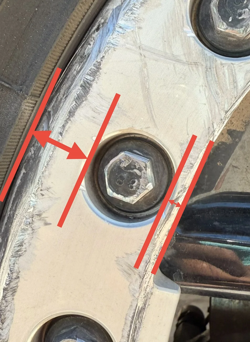

First of all, that's exactly how those rims should look. Never apologize (except for drinking Starbucks, that stuff is trash). Second, I'm not sure what you're pointing out as the stock beauty rims seem to have a similar ratio in spacing, although a different number of bolts, but I'm certain there are aftermarket rings with all the bolts and you could also have a proper ring on with the bead held internally by the rim and not the ring. Explain it to me as if I've only been wheeling a few times and most of what I know comes from youtube. What could LEO point to and definitively say that it's bead lock without you admitting it or using tools (which would then be fruit of the poisoned tree).

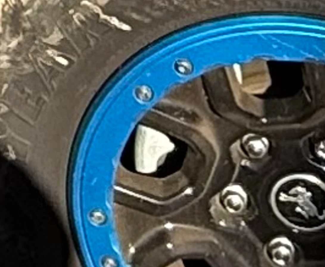

12 bolts is an easy tell that they’re trim rings. The main takeaway is that all the fake beadlocks have the bolts centered in the ring, and will be incapable of holding a bead unless they’re huge. With a big difference like pointed out above, that’s at least a clue that they’re legitimate beadlocks, assuming there is appropriate bolts, of course. And even then with these wheels they could be mounted conventionally. Definitely wouldn’t put it passed people to drop $250 a pop for an aesthetic and not even use them.

The beauty ring bolts are not centered, at least this set on the factory Squatch set up. Numbers are obviously off. I can't speak to other rings.
