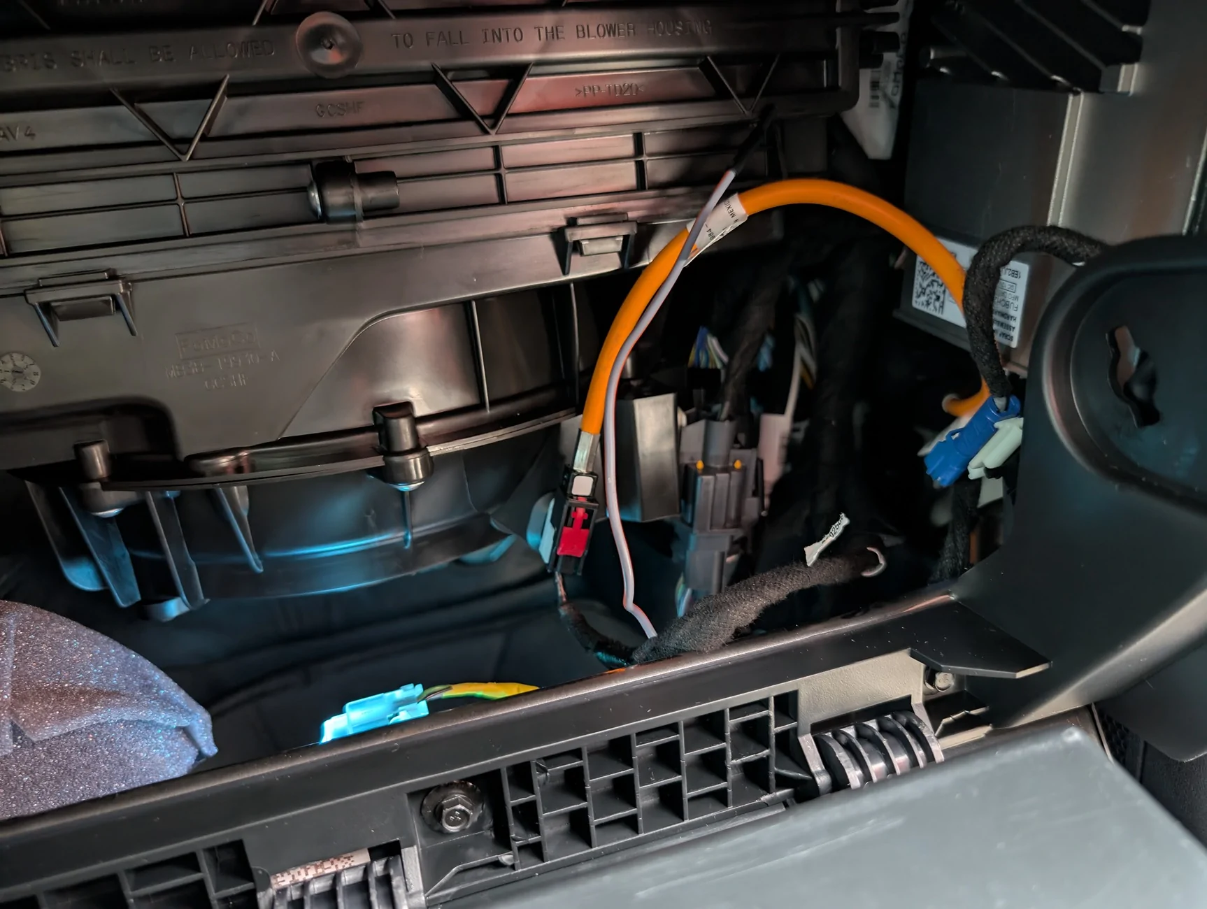

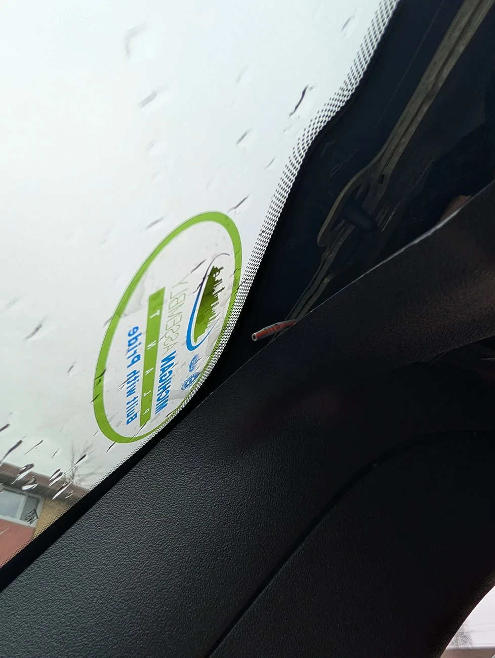

Welp, found it...
Wrapped up in hockey tape with a half inch of wire expose, in the A-frame corner, and facing the outside of the Bronco 🤬
After pulling the shrink cap and yanking it out of the tape, here is what I had to work with....
Ford Bronco Help! Can't find AUX wire behind sunvisor 2384
It's not that the wire wasn't long enough, but shifted to have all the slack behind the glove box!
Ford Bronco Help! Can't find AUX wire behind sunvisor 2381
But, I managed to do what I needed to do, bloody knuckles not withstanding...

I'm actually using it to power a multi USB charging port.
I have a DV8 overhead Molle panel and mount my Sony camera, drone and laptop up there so I can charge while on the go 👍🏻
The circuit is good for 10A (AUX 3) but you can configure it for 30A.
I believe all the pass thru wires are 30A rated (looks like 10AWG).
So long as the conductor length is under 10 ft., it should be fine.

That wire would not handle 30amps. It's way too small. I don't know why Ford claims it will, but the gauge is too small.

It's not a waste if you're using it to power something that draws less that 20 amps. I'm using it to power my roof mounted light bar which draws 16 amps.
