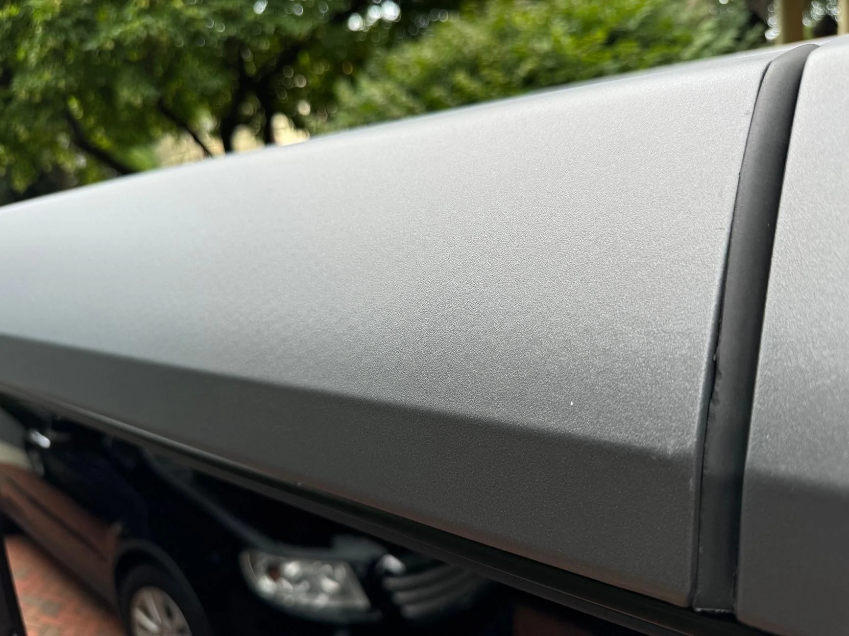

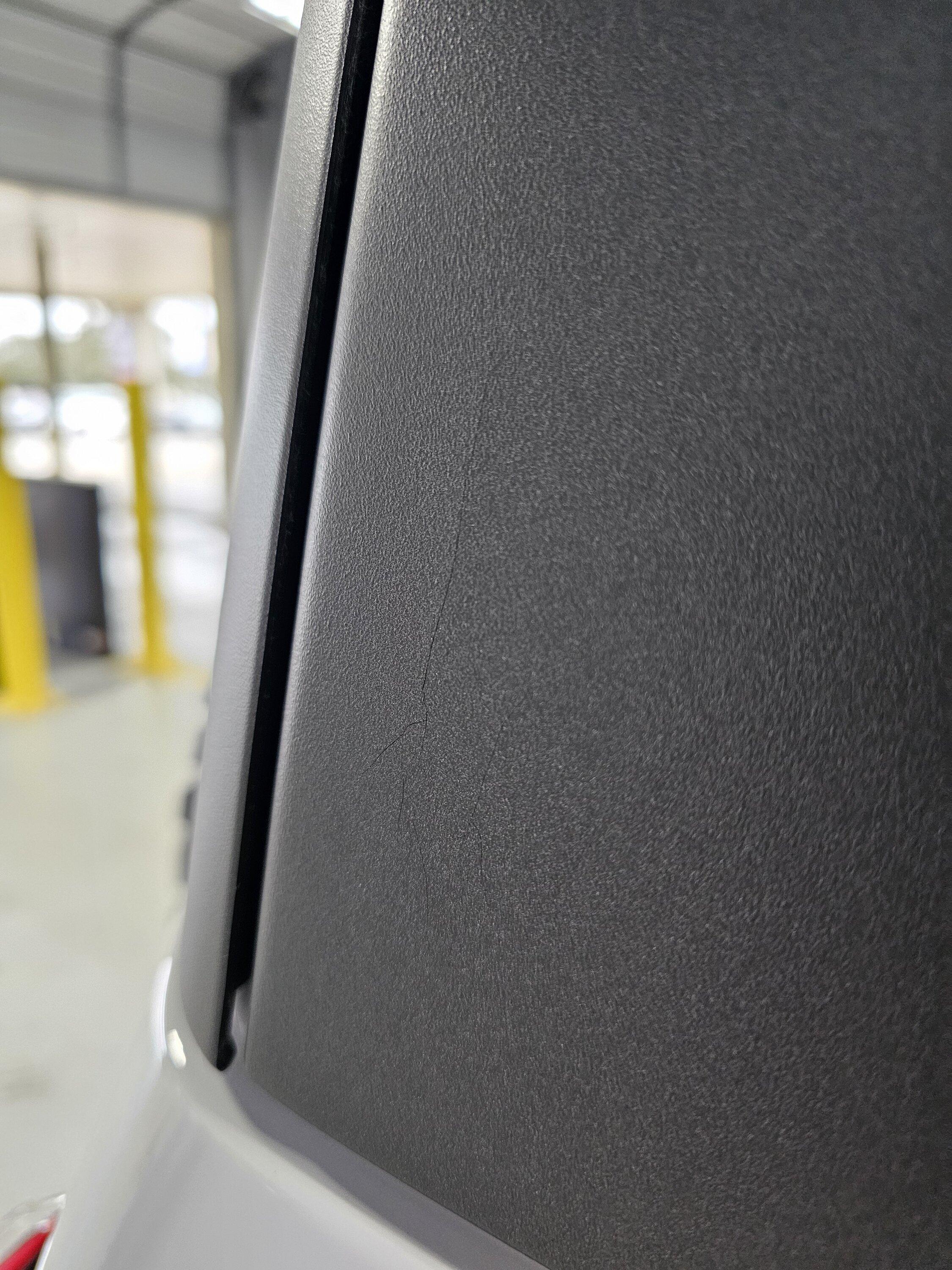

In case anyone wants an update:
I rolled the dice and went back to the dealership to show them the new cracks. They took pictures, got the mileage, and told me that they would get back to me. I indicated that water from washing, rain, etc. was definitley hitting that area and it was staying damp/wet after the rest was dry and looked like it was weeping moisture. The service advisor said that this was definitely a problem. That was around 12/1 and I have not heard anything. Yesterday, I responded to the message here from FORD and they said:
"I was able to look into your recent case, and see a decision regarding coverage has already been made. I wouldn’t be able to overturn this decision, however I will add these notes to your case so your experience is fully documented. Thank you for reaching out.
Julia
Ford Social Media Team"
I'm not sure if that was from the first time I went there for the cracks under the window or from this most recent time for the new vertical cracks along the back so I sent a message asking for clarification.
It is a weird cycle/circle of having to communicate with the dealer and contact Ford then watch it restart as nothing happens.
I'm at the point that I think I want to just get the sides vinyl wrapped in the same color and to just be "out of sight out of mind" with it. My only concern is that if there is a full failure of the outer layer at any point in the future that Ford will use the wrap as an excuse to absolve themselves. Honestly though, they already are absolving themselves...so it does not seem like I have anything to lose?

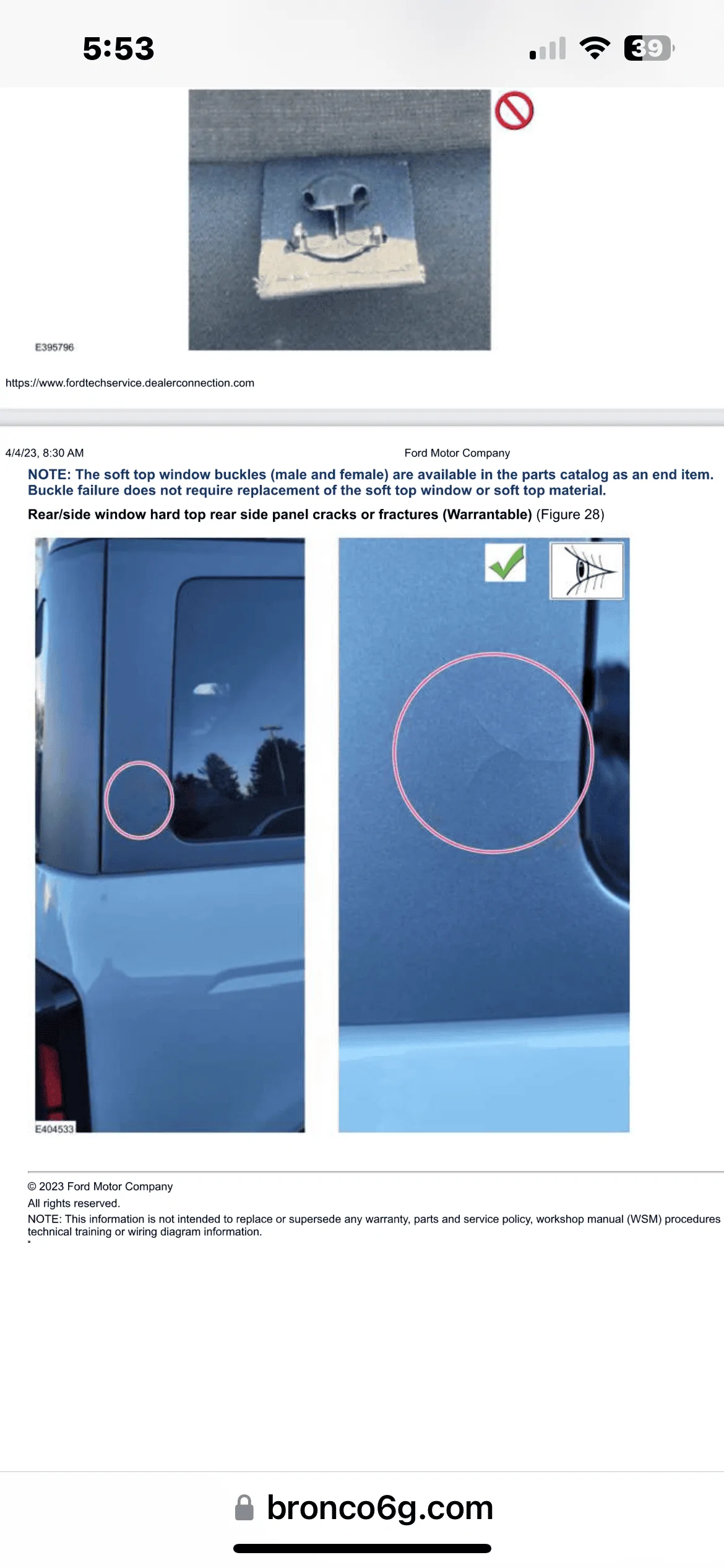

Same thing is happening to mine, started happening 4 months after delivery. Showed it to my dealer while I was in there for service. Do not use the term cracking, let them know its delaminating.
This message from Ford says cracking IS WARRANTIED item.

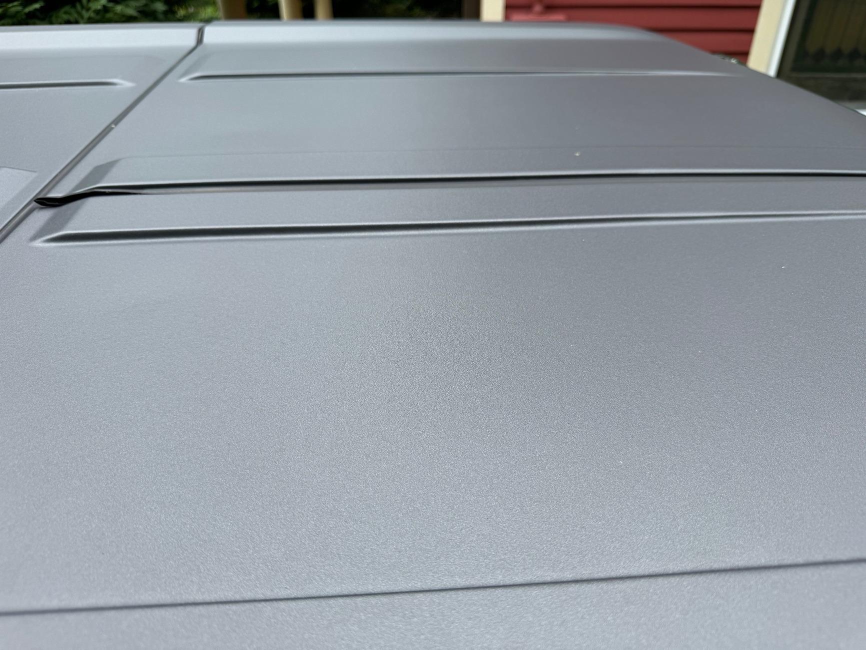

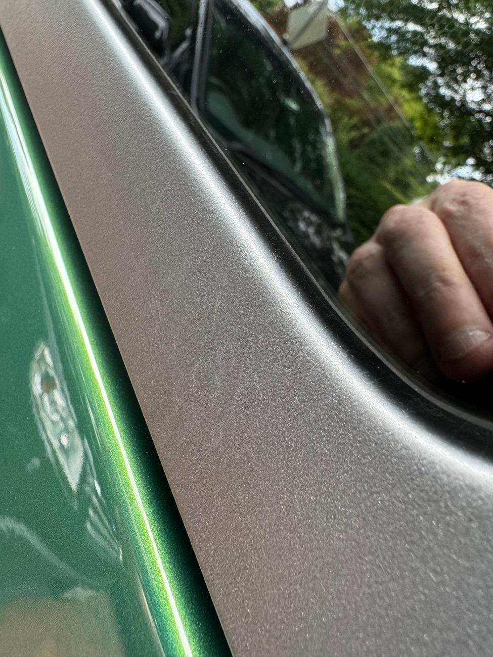

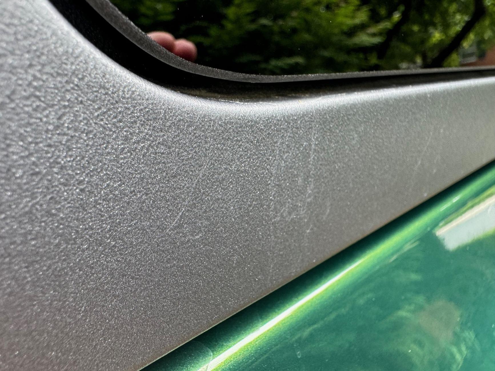

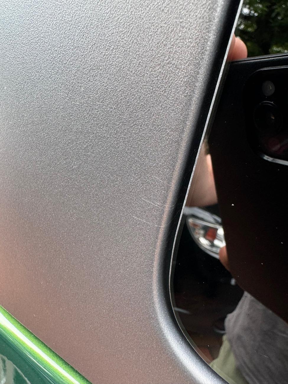

MIC TOP WOES!

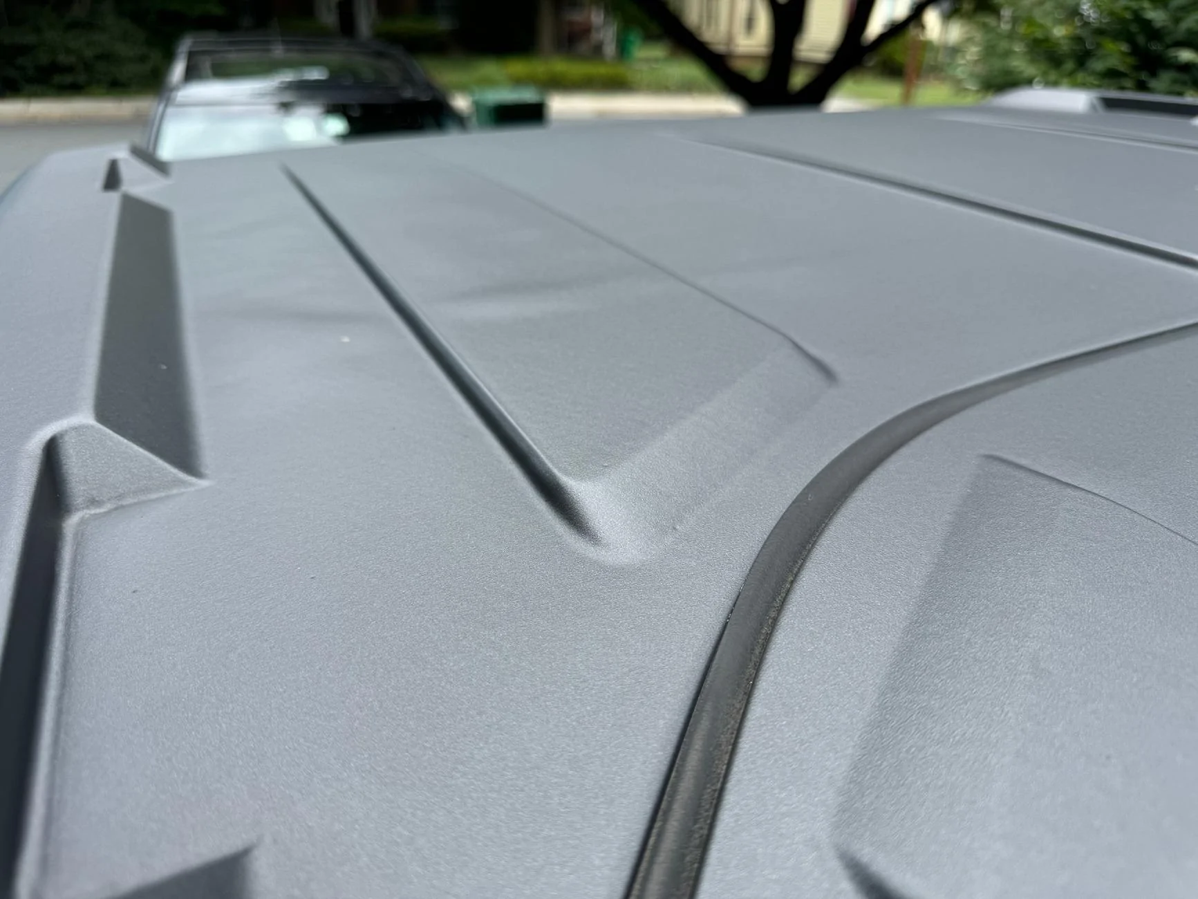

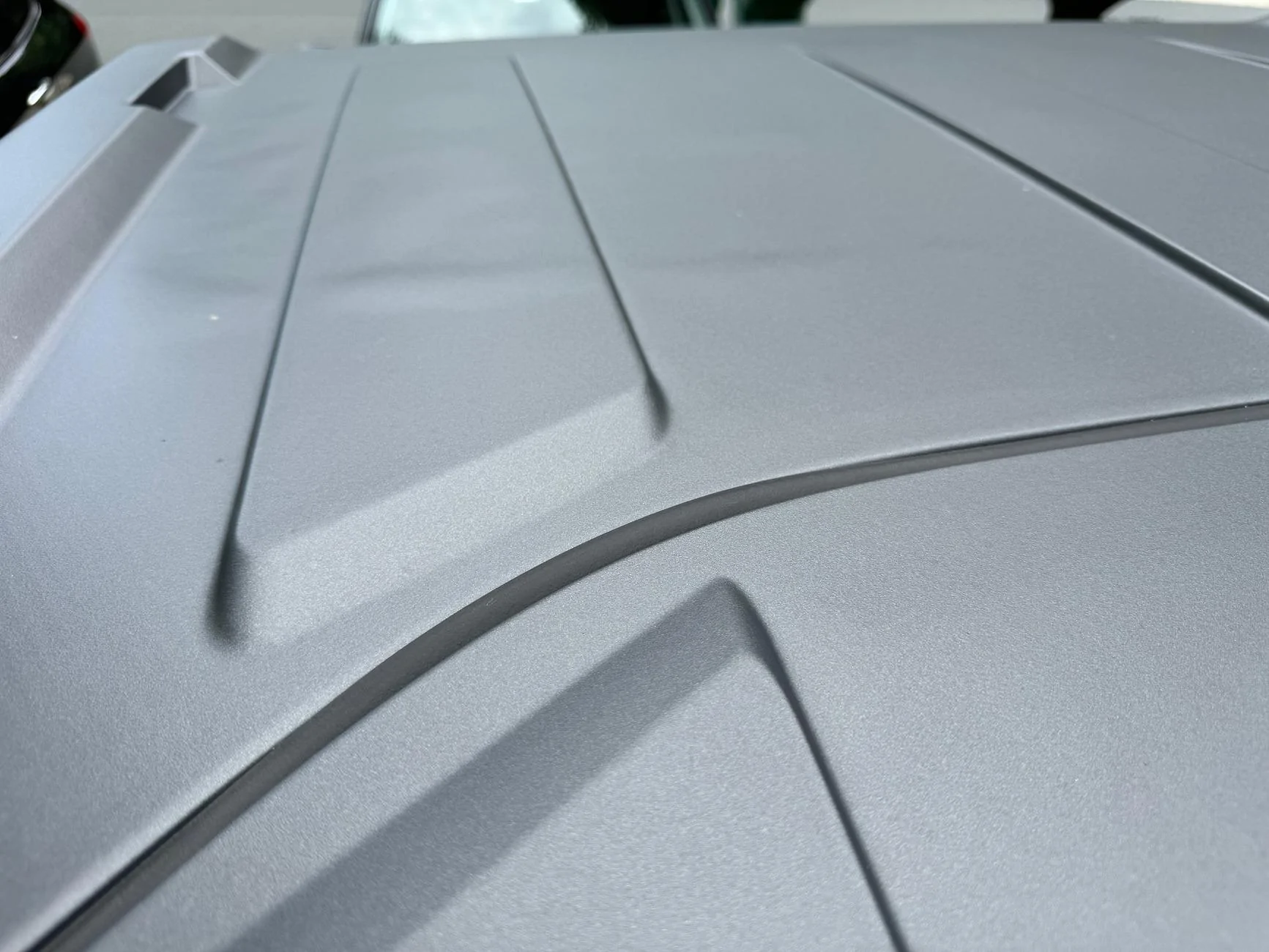

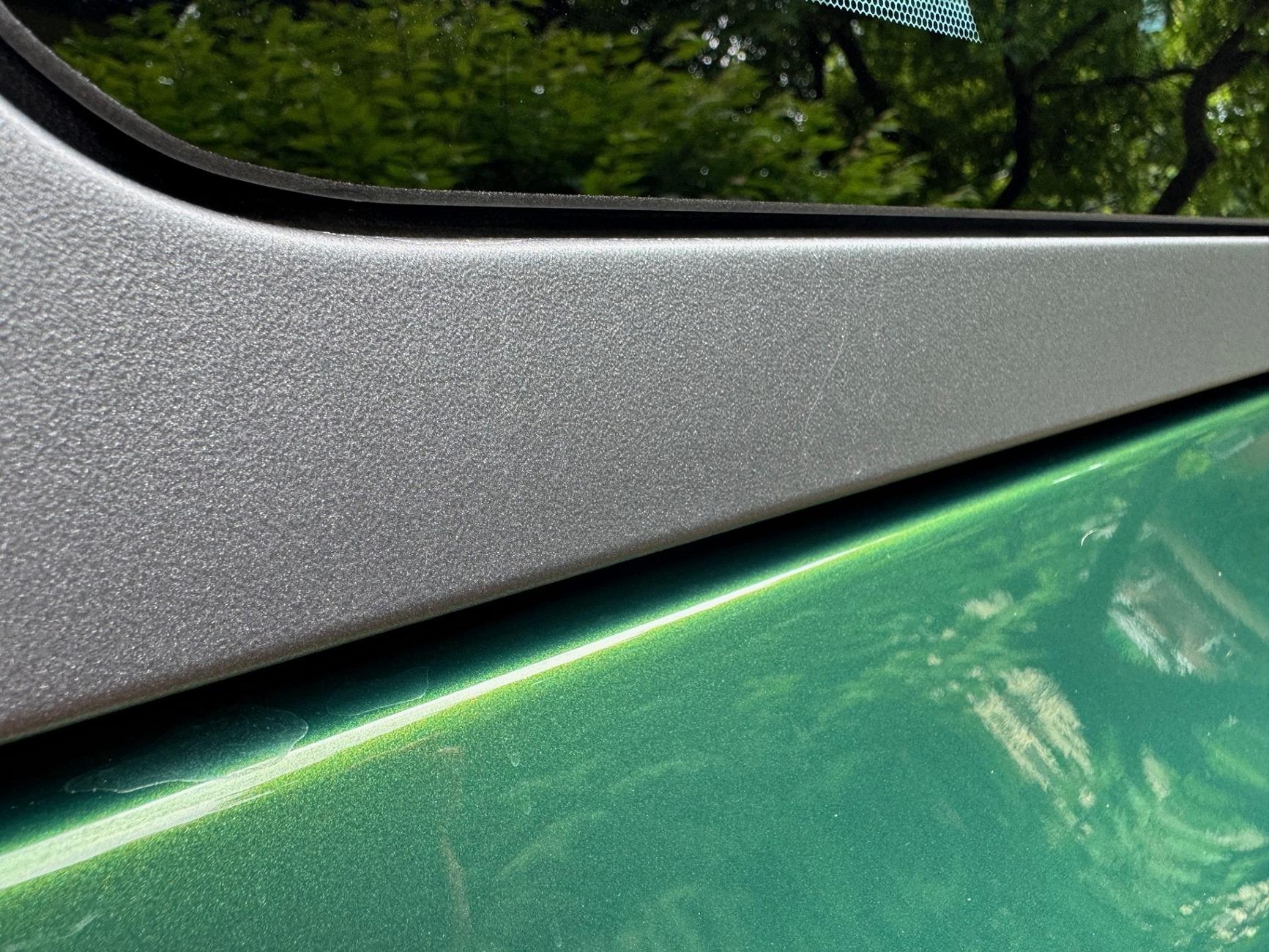

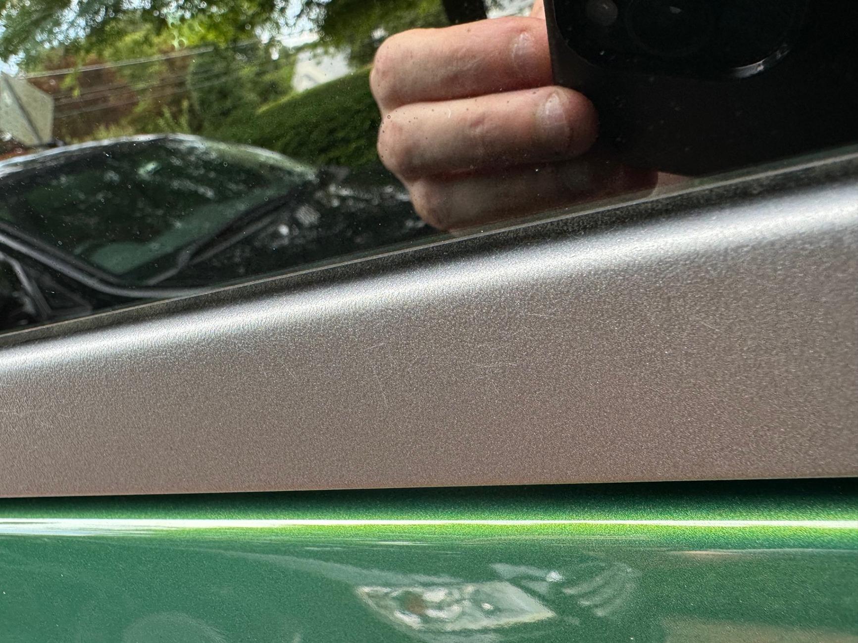

All these issues developed over the past 2 years (except that the front two panels were always uneven; the weatherstrip popped up later).
I'm positive that every single MIC top will develop the hairline cracks.
I'm going in for other warranty work and will be raising these issues.
Is there a way for me to print this whole thread and the other pictures to give to the service writer? I think I want to make it part of my warranty claim file.
This Bronco built late 2022. Just over 4,000 miles. Top never off.
Ford Bronco Hardtop cracks?  Something else? Delam1
Ford Bronco Hardtop cracks?  Something else? Delam2
Ford Bronco Hardtop cracks?  Something else? Driver1
Ford Bronco Hardtop cracks?  Something else? Driver2
Ford Bronco Hardtop cracks?  Something else? Pass1
Ford Bronco Hardtop cracks?  Something else? Pass2
Ford Bronco Hardtop cracks?  Something else? Pass3
Ford Bronco Hardtop cracks?  Something else? UnevenPanels
